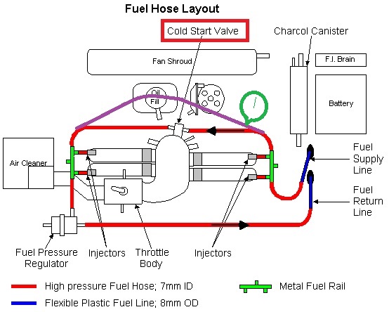

if you can find a way to check your fuel pressure, you can then bypass the CSV and check fuel pressure at high RPM and at idle. One way is like the purple line above. Or get a hose union and pull the hoses from the CSV and connect them together.
make the by-pass semi-permanent (decent clamps if needed) so you can drive a while and maybe recheck your plugs.
It seems that every time I have trouble, someone always asks about fuel pressure. So I bought a Harbor Freight fuel injector test kit, I guess it is. I installed the gauge between the passenger side metal fuel rail and the CSV. (green circle above)
No, I can't see it when I am driving, but I can see it when I open the hood. (IMG:style_emoticons/default/shades.gif)
