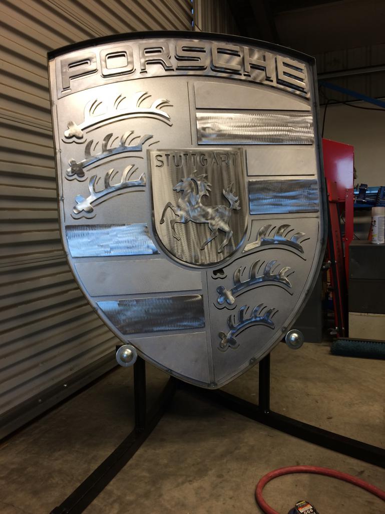

I though you might enjoy seeing some details on this "build".
With "Crest Version 1" (my interpretation) being given away as a WCR award, I've decided to make some "improvements" to V2. This one will hang in my home office.
As you may have noticed in my LS build (with things like the engine compartment panel), I most often have to build something and experience it physically before I know what I really like. Same thing is happening here.
Comparing V1 and the pieces/cut patterns for V2, you can see I decided to add an additional layer to the main body area - I think that'll be more interesting and better balanced.
The grid in the design is 4'x4' so you can see, this uses a bit of metal! I'm thinking I may do this one in stainless, depending on cost.
And I have an idea for a wall frame that should be pretty neat. More on that as I get to it.

tygaboy   I'm still considering additional design change...   Jun 12 2017, 09:18 AM
tygaboy   The cut parts on the table. I cut those little ...   Jun 12 2017, 09:40 AM

tygaboy   Finished cutting the pieces. I'm really liking...   Jun 17 2017, 03:43 PM
tygaboy   My wife recently retired and she's happy to ru...   Jun 17 2017, 03:46 PM
tygaboy   And I may as well disclose how I plan to frame and...   Jun 17 2017, 03:50 PM
tygaboy   I need to become proficient at TIG welding and fig...   Jun 25 2017, 09:23 PM

tygaboy   V2 assembled. I'm playing with different patte...   Jun 28 2017, 03:00 PM
tygaboy   The convenient part is that all the pieces unbolt ...   Jun 28 2017, 03:01 PM
tygaboy   Well, after looking at for a couple hours, I decid...   Jun 28 2017, 04:45 PM

tygaboy   This morning, I took the crest over the the R Grup...   Jul 1 2017, 04:16 PM
ConeDodger   This morning, I took the crest over the the R Gru...   Jul 1 2017, 06:04 PM
tygaboy   Then this fell off the plasma table... What could ...   Jul 1 2017, 04:18 PM
tygaboy   And, duh, I suppose I should include a couple pics...   Jul 1 2017, 04:39 PM
