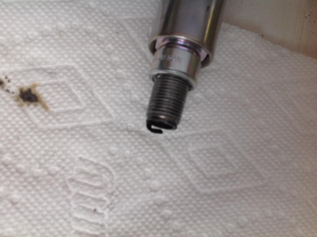

Here is a couple of pictures of the plug from cylinder 3. New plug only in the car long enough to do the testing suggested. Looks pretty black... appreciate any suggestions.
