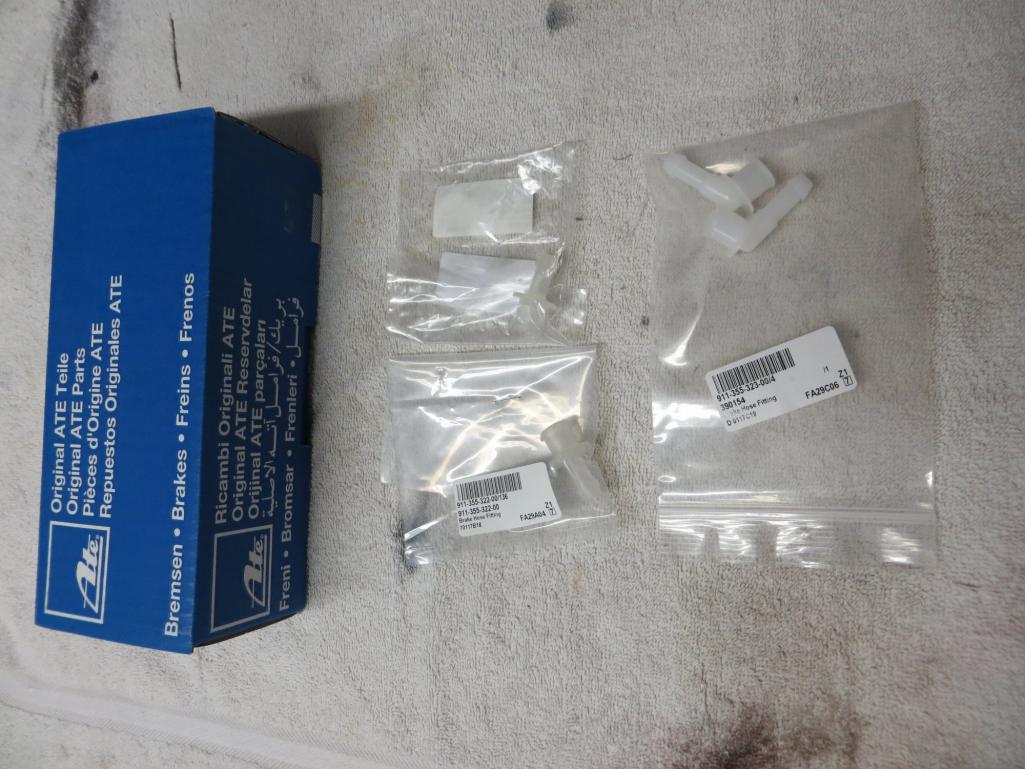

Parts:
357 611 019 - this is for the 20.64mm master cylinder
357 611 019 B - this is for the 22.22mm master cylinder
911 355 322 00 - straight reservoir feed fitting
911 355 323 00 - angled reservoir feed fitting
7mm blue braided brake reservoir hose
(IMG:http://www.914world.com/bbs2/uploads/post-9101-1498608352_thumb.jpg)
You'll need to decide which master cylinder is right for your application. For example, my braking system is pretty much all mid-1980's Carrera sized calipers and referencing Bill Verberg's brake page, I found that the mid-1980's Carrera used a 20.64mm master cylinder. I also knew that my pedal travel was more than I liked while on track.
https://members.rennlist.com/1976c38/brakes.htm
I purchased all of the parts through Pelican, the 357 611 019 (20.64mm) is an ATE unit made of aluminum and was only about $100. The 357 611 019 B (22.22mm) is made by a few companies, is a cast iron unit and about $50.

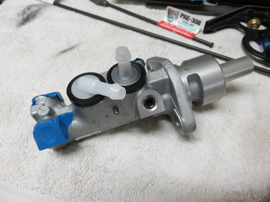

4. Unbox your new master cylinder and pop in the fittings as shown in the picture below. Use a dab of brake fluid to help lubricate the fitting where it inserts into the master cylinder. ALSO, you'll need to plug one of the extra ports on the master cylinder that you aren't using as seen below. I placed a piece of tape over all of the openings while fitting the master cylinder to keep dirt out.

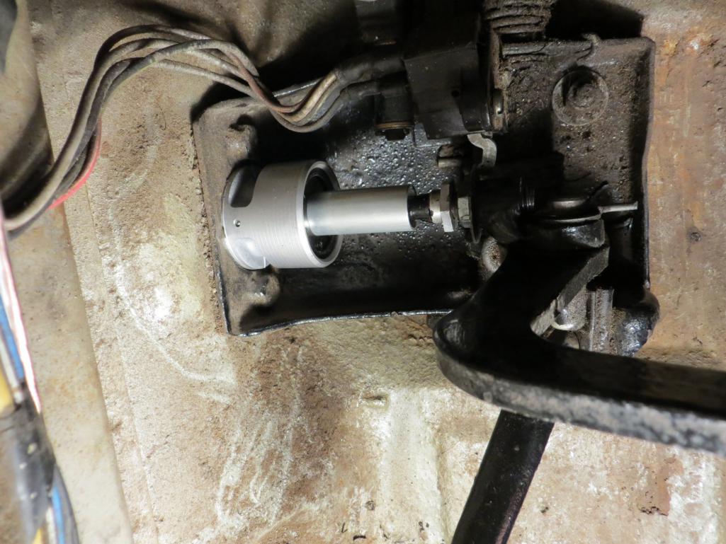

5. Grease the tip of the pushrod before installing the master cylinder. Torque the two 8mm nuts to 18 ft-lbs. I left the washers off. VERY IMPORTANT - now adjust the pedal free play to approximately 1mm by turning the pushrod inside the car at the pedal cluster. Once adjusted, tighten down the locknut. Make sure that the brake light switch lever is in the correct position to actuate when the brake pedal is depressed.

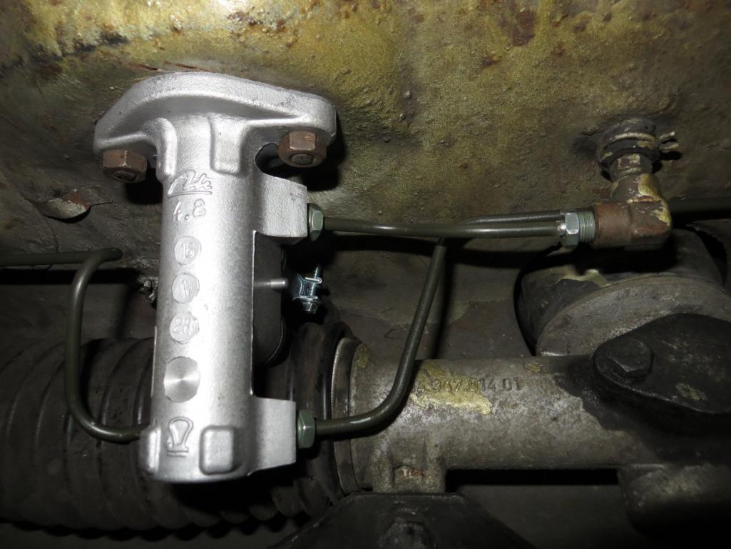

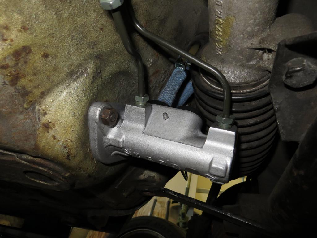

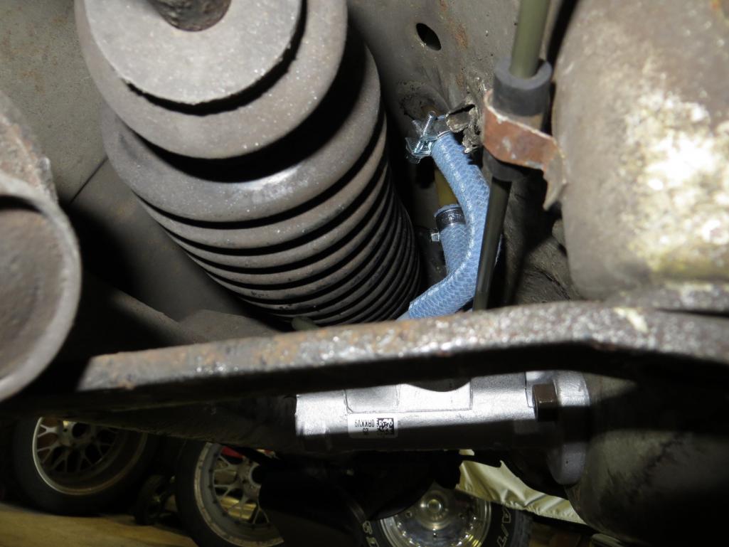

6. Back under the vehicle, decide how you will connect the reservoir to the master cylinder. The metal ends of my plastic lines were rusty so I decided to cut them off and use a short length of 7mm blue braided reservoir hose to each line. You could also run the blue braided hose all the way from the reservoir to master cylinder. Use a dab of brake fluid to make it easier to install the hose on the fittings.
(IMG:http://www.914world.com/bbs2/uploads/post-9101-1498610136_thumb.jpg)
7. Next, bend new brake lines for the front brakes and a short piece for the rears.
