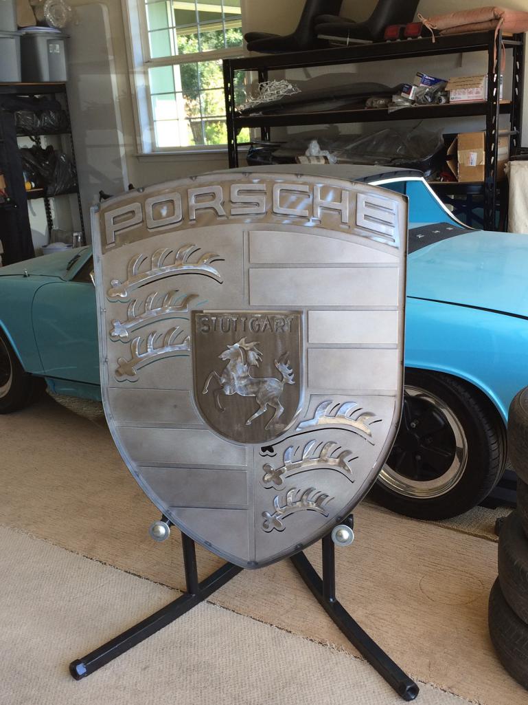

With "Crest Version 1" (my interpretation) being given away as a WCR award, I've decided to make some "improvements" to V2. This one will hang in my home office.
As you may have noticed in my LS build (with things like the engine compartment panel), I most often have to build something and experience it physically before I know what I really like. Same thing is happening here.
Comparing V1 and the pieces/cut patterns for V2, you can see I decided to add an additional layer to the main body area - I think that'll be more interesting and better balanced.
The grid in the design is 4'x4' so you can see, this uses a bit of metal! I'm thinking I may do this one in stainless, depending on cost.
And I have an idea for a wall frame that should be pretty neat. More on that as I get to it.

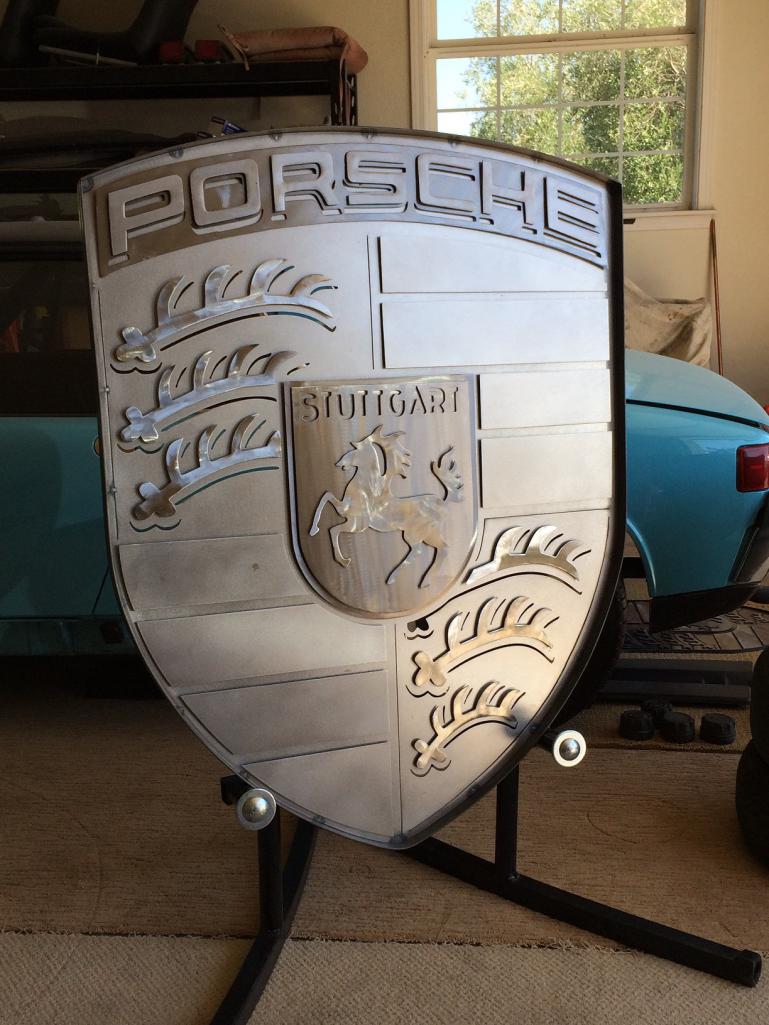

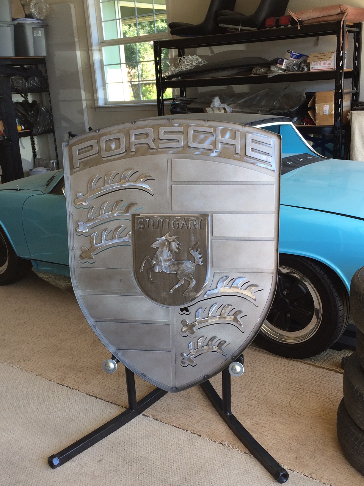

And, duh, I suppose I should include a couple pics of the finished crest! I didn't like the way the panels were looking so I cut new ones and attached the fasteners from the back, vs. plug welding through the locating holes as I did on the first set.
They turned out far nicer.
And with the raw finish, the way light reflects causes it to look a little different from every angle. I like it!
