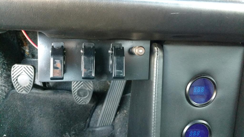

This was my solution to the toggle switch for windshield squirters. Three covered toggle switches. Left one is on/off for fuel pump, middle one is momentary for starter, right one is momentary for washer, knob is trip odo reset. Attached Image
