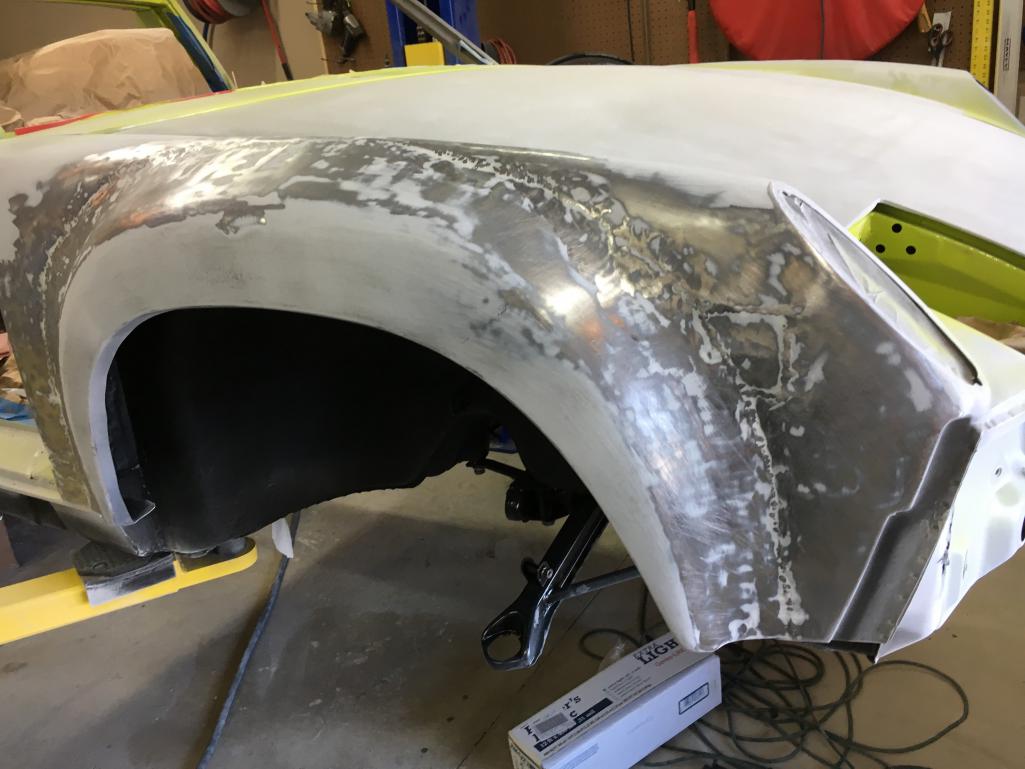

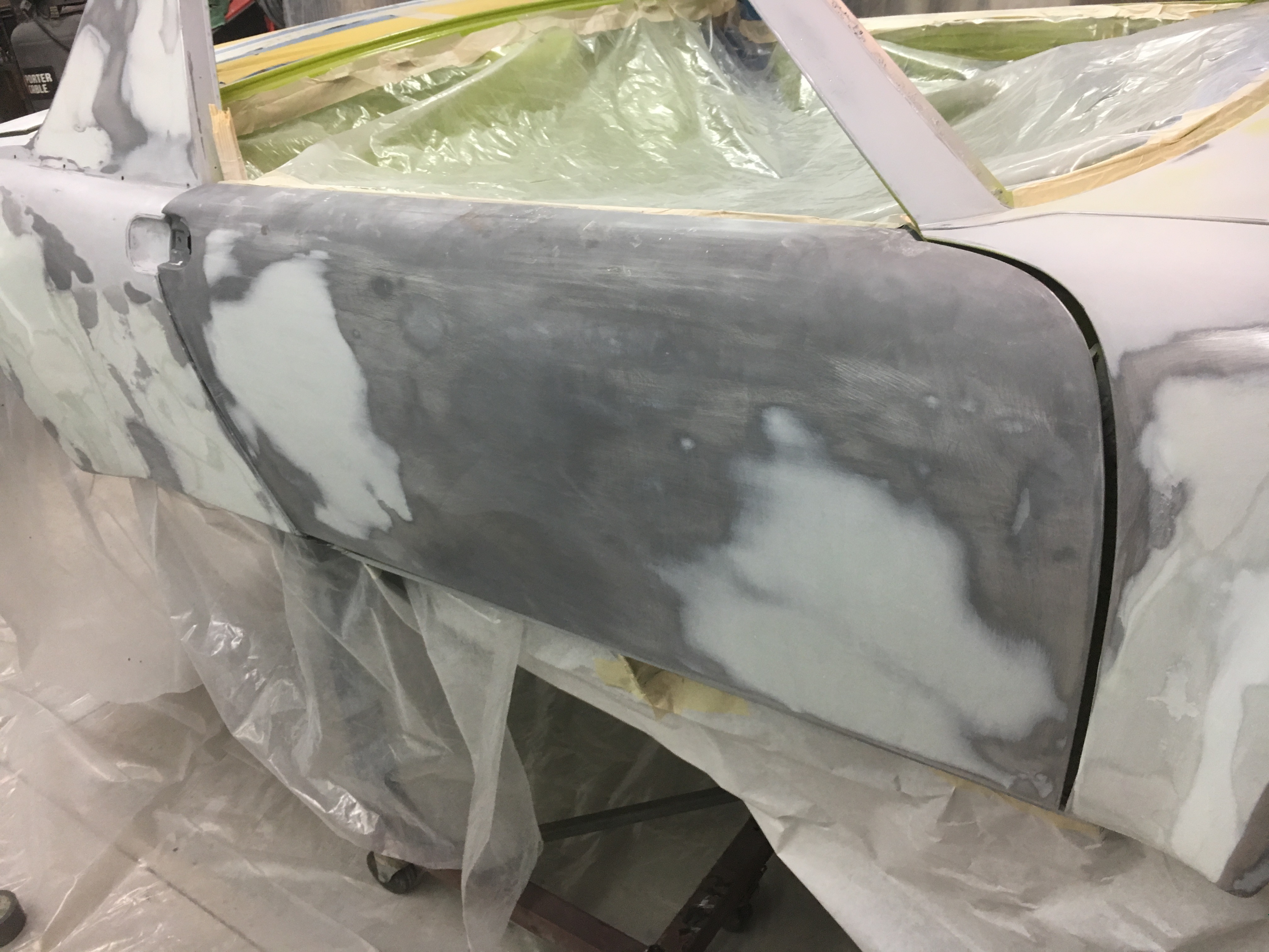

more body work; new (used) passenger side door.
After getting almost finished with body filler on the flares, I realized I probably didn't do it correctly, so it all came off and I started all over again.
First layers with metal-impregnated filler, then regular filler, then featherweight.
Sounds like a lot of filler but in truth it's 1/8" at the deepest and in most places much less.
