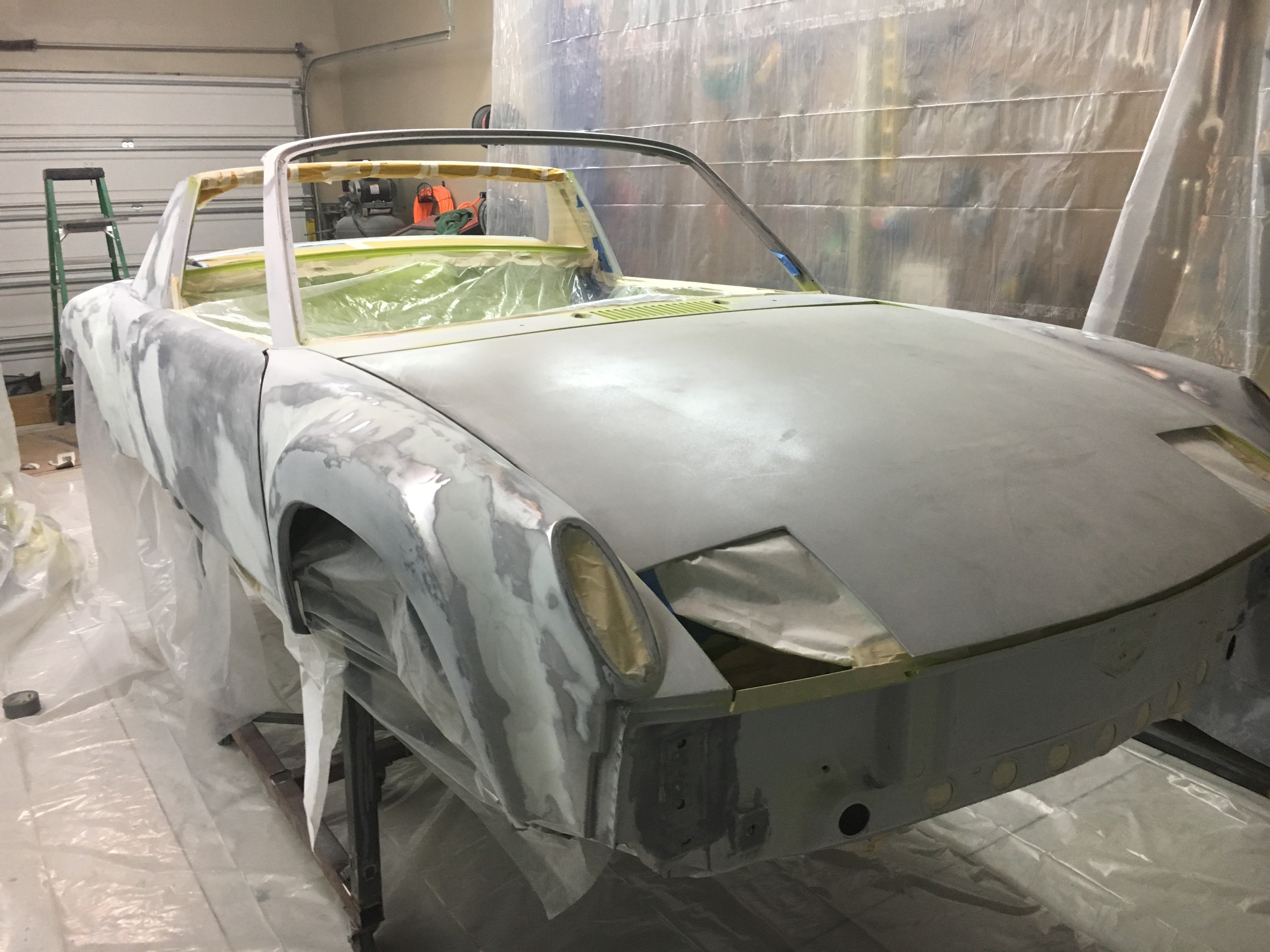

jmitro   the last 5 months have been lots of bodywork; sand...   Jul 29 2017, 03:17 PM
jmitro   more body work; new (used) passenger side door. Af...   Jul 29 2017, 03:31 PM

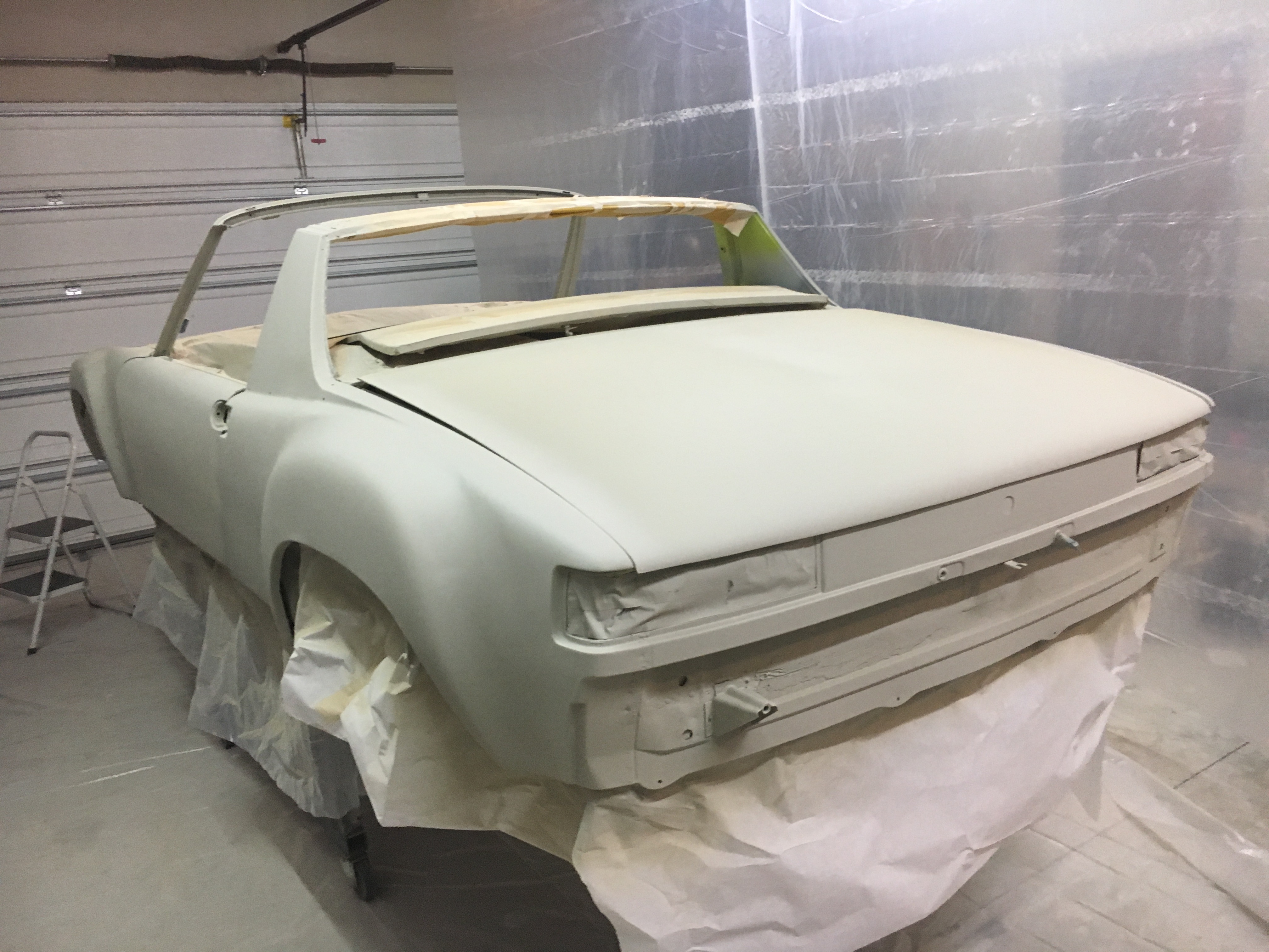

jmitro   high build primer. Several coats required to get i...   Jul 29 2017, 03:33 PM
jmitro   And FINALLY, nearly two years to the month since b...   Jul 29 2017, 03:37 PM
