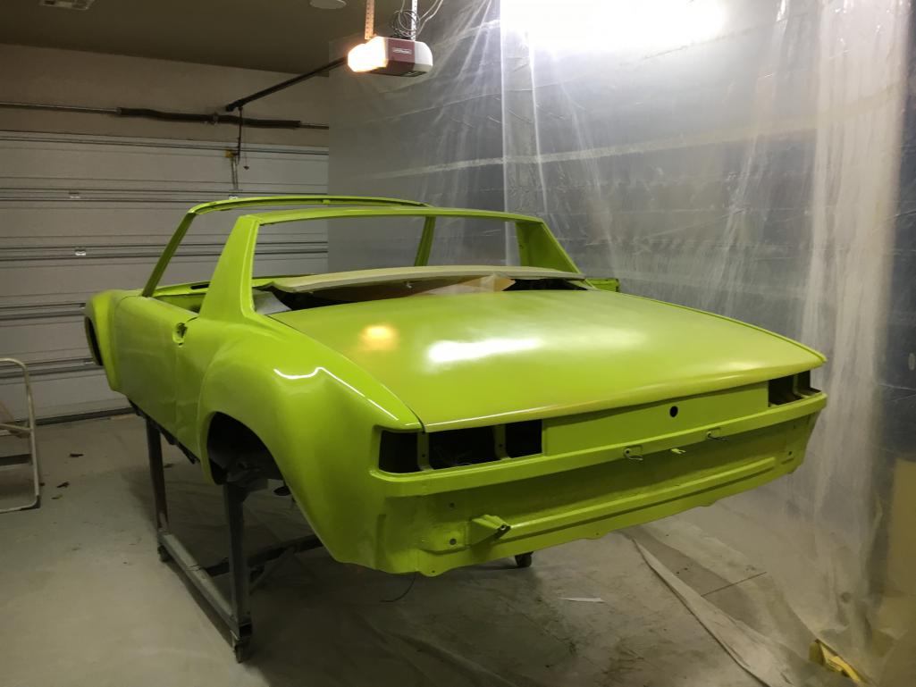

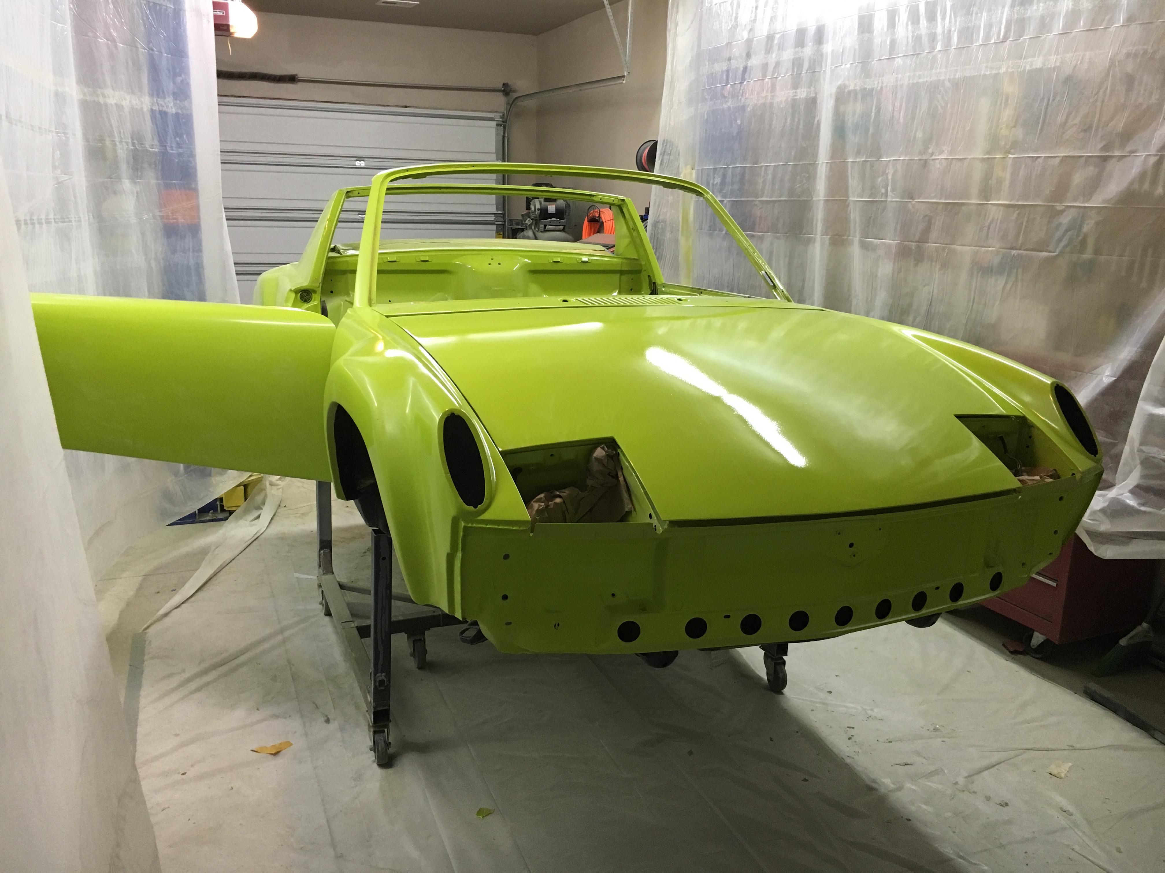

jmitro
post Jul 29 2017, 03:37 PM
Posts: 713
Joined: 23-July 15
From: Oklahoma
Member No.: 18,986
And FINALLY, nearly two years to the month since buying the car, I have the body finally painted. (IMG:style_emoticons/default/beerchug.gif) Three coats of Ravenna Green followed by 3-5 coats of urethane clearcoat.
The body came out really straight. Needs a good wetsanding from small crap in the air that adhered to the clear coat, but I'm happy with it.
Hood, trunk, front and rear bumpers and the rocker panel covers are all fiberglass. Valances too if I use them. Hopefully that will save a small amount of weight to compensate for the chassis stiffening.
