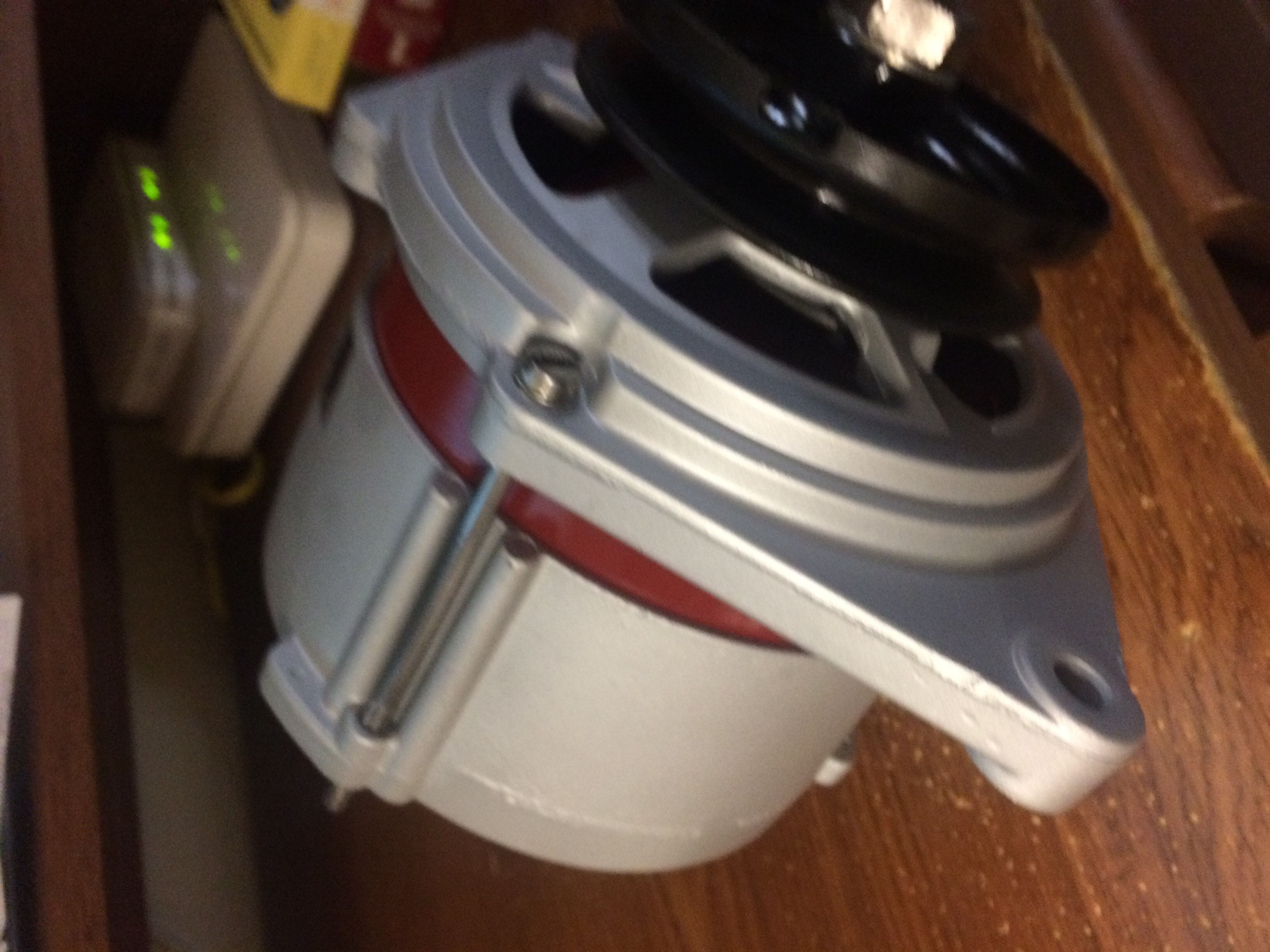

Edward Blume   Here's the one I pulled. Looks like the boot m...   Jun 22 2017, 04:18 PM
GregAmy   Here's the one I pulled. Looks like the boot ...   Jun 23 2017, 07:49 AM

Edward Blume   Thanks for the great information Spoke! I...   Jul 31 2017, 04:07 PM
porschetub   What did they find wrong with it ?   Jul 31 2017, 04:45 PM
Edward Blume   It tested good but when he opened it up, the diode...   Jul 31 2017, 05:01 PM
