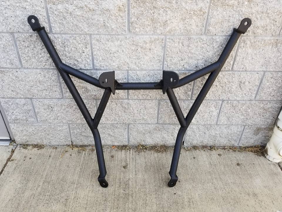

JRust   Haven't made much progress. Got some bug over ...   Feb 19 2017, 05:54 PM
JRust   Okay a little progress. Took a me a bit but I got ...   Mar 3 2017, 12:24 AM
JRust   Did a little more test fitting. With the tranny ha...   Mar 9 2017, 09:12 PM

JRust   Well not a whole hell of a lot of progress. Bought...   Jul 31 2017, 11:24 PM
914forme   Why is number 7 before number 8. :confused: F nu...   Aug 1 2017, 05:51 AM
Chris H.   Hey Jamie you will get more starter clearance if y...   Aug 1 2017, 07:47 AM
76-914   Hey Jamie you will get more starter clearance if ...   Aug 1 2017, 10:06 AM
JRust   Hey Jamie you will get more starter clearance if ...   Aug 1 2017, 10:52 PM
