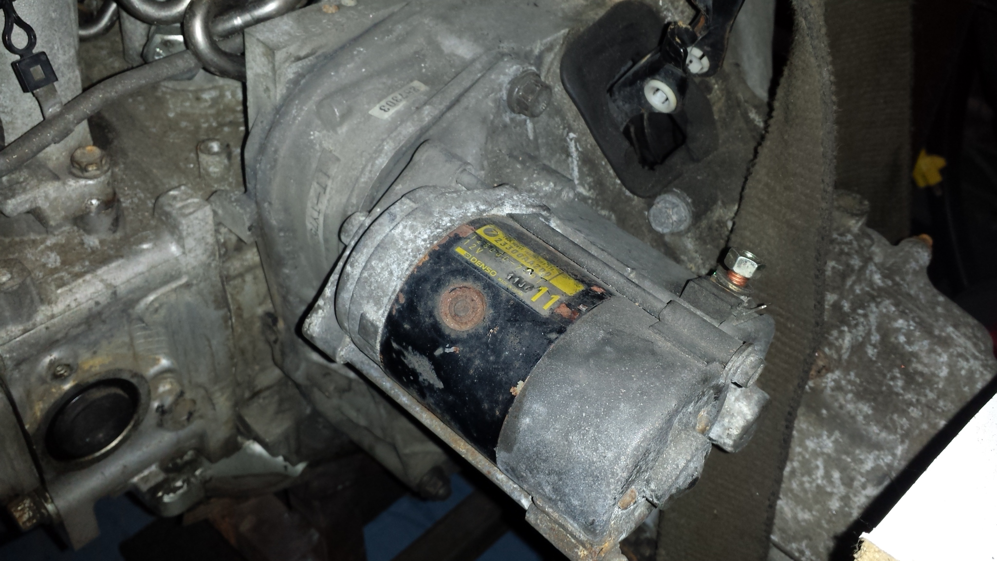

ditto - thanks for suggestion on later starter and its pn (IMG:style_emoticons/default/aktion035.gif)
my starter from 1990 legacy mt and it looks like my starter won't be a problem but i will have to probably cut trunk for clutch arm and clutch cable.

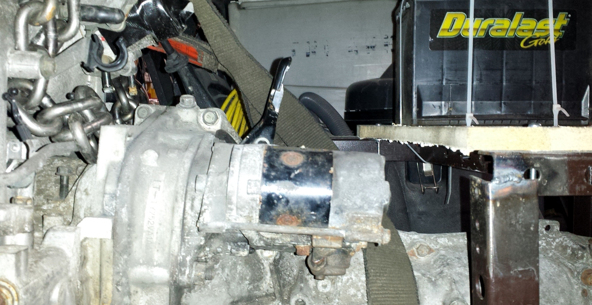

JRust   Well not a whole hell of a lot of progress. Bought...   Jul 31 2017, 11:24 PM
914forme   Why is number 7 before number 8. :confused: F nu...   Aug 1 2017, 05:51 AM
Chris H.   Hey Jamie you will get more starter clearance if y...   Aug 1 2017, 07:47 AM
76-914   Hey Jamie you will get more starter clearance if ...   Aug 1 2017, 10:06 AM
JRust   Hey Jamie you will get more starter clearance if ...   Aug 1 2017, 10:52 PM
