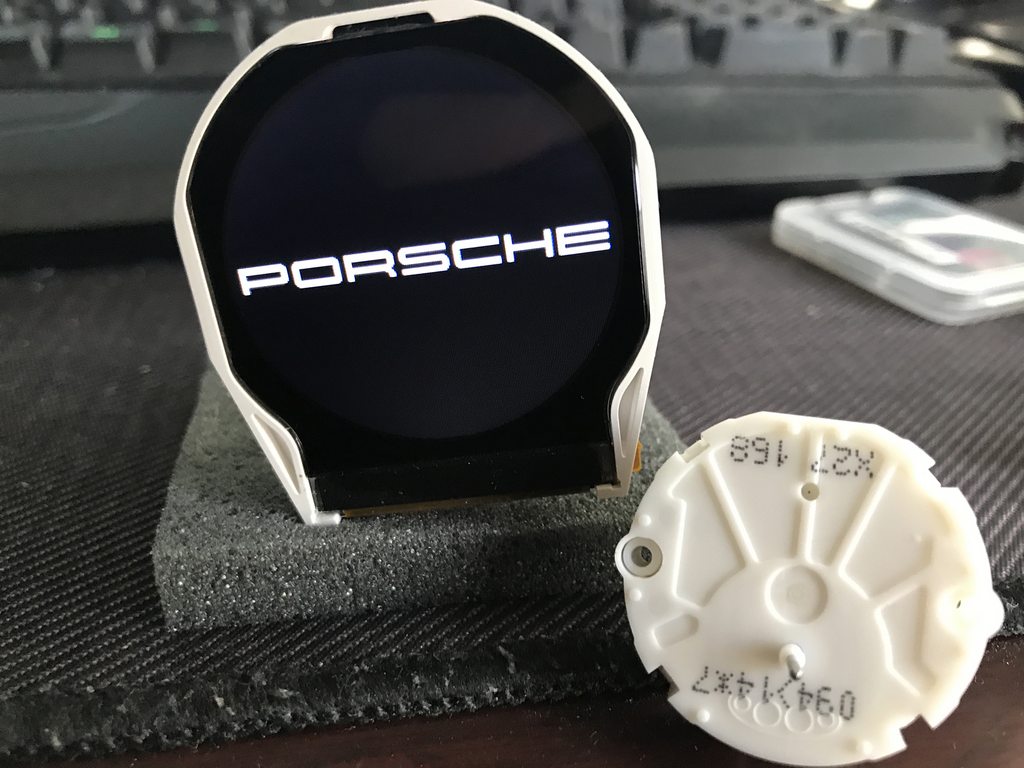

Funny enough, half way through this project, i concluded that a second version using modern gauge steppers may be a cheaper and easier route than using the VDO gauges. I'm working on a version 2.0, but this gauge suits my immediate needs, so progress will be slow on 2.0. Also since the stepper gauges are much more compact, this give a lot more space for other stuff, like a 1.38 round LCD screen. Here's a peak on what 2.0 will have.
(IMG:http://www.914world.com/bbs2/uploads_offsite/i.imgur.com-20837-1501953962.1.jpg)
As for the microcontroller, it was the only realistic way to control the LEDs in a compact fashion.
