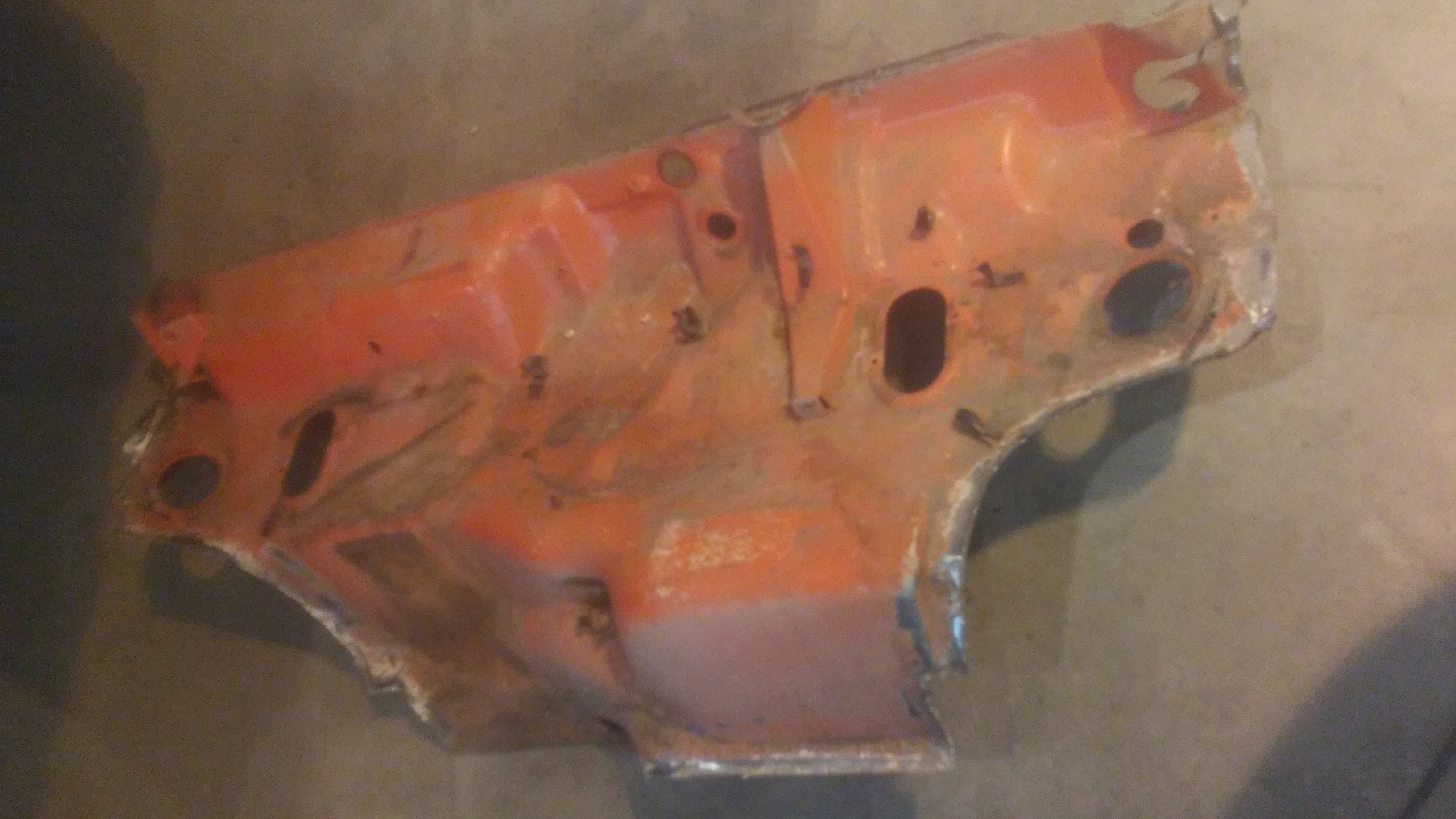

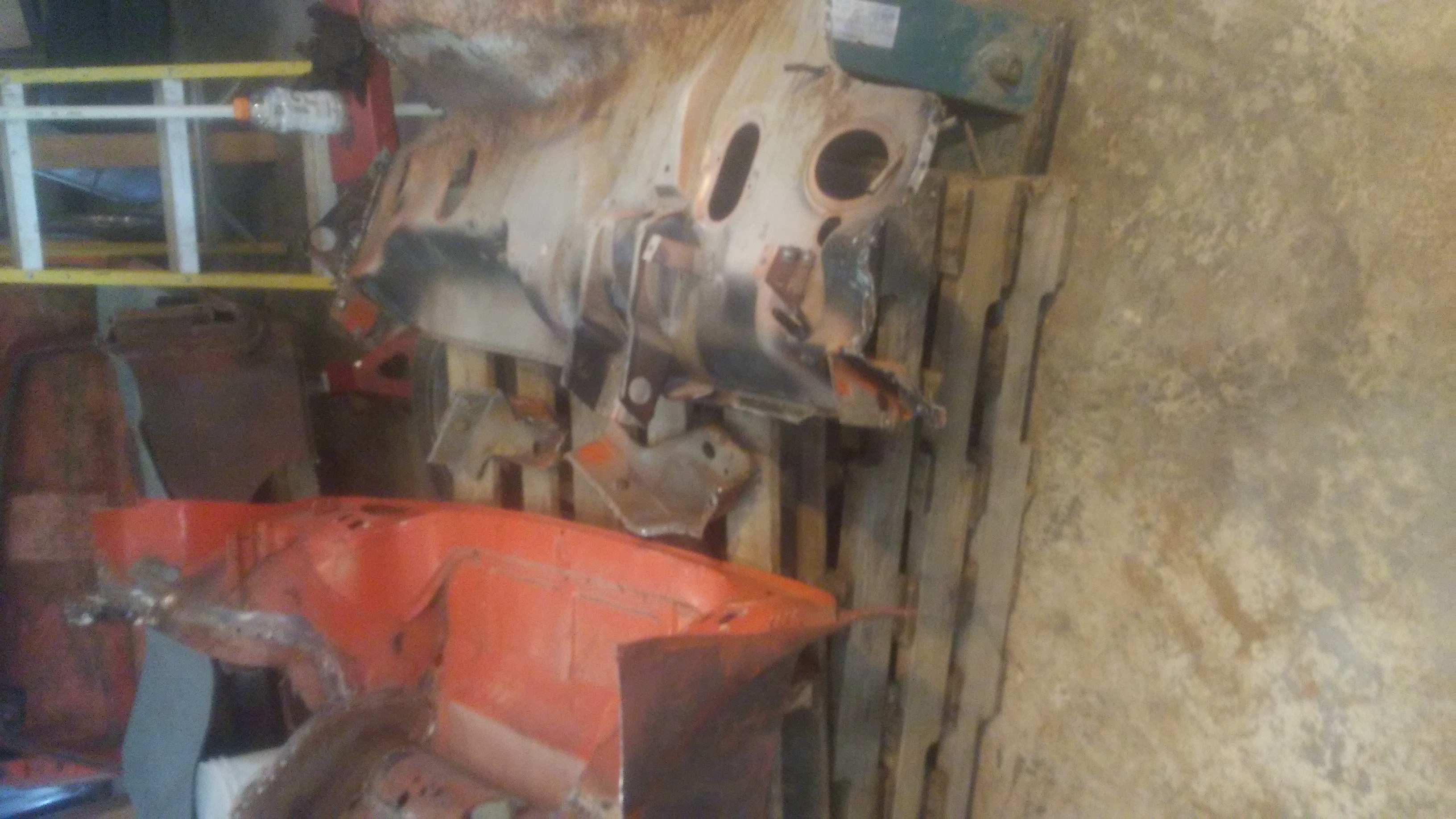

Making some more progress. Got the front end of the donor separated into pieces and now time to figure out what im going to use. Its been a a long process but i can see the end in sight. Hopefully a few more months and she will be ready for paint.Attached Image Attached Image
