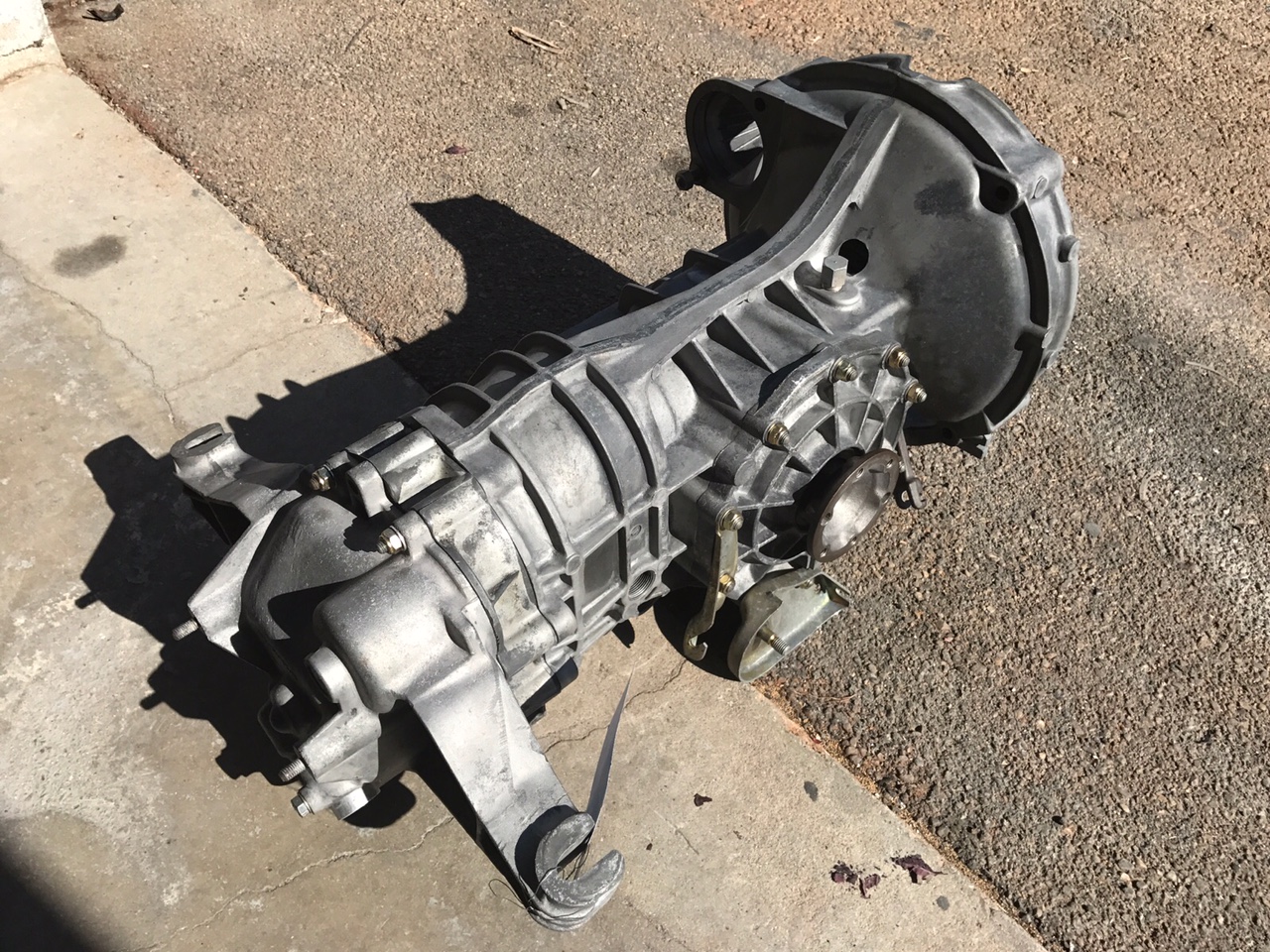

PMB put the stacks on my PMOs. The PO had non 914-6 air cleaner on it and I am going with the same set up. Will show more. Also the trans after PMB re freshened it. I got a NOS case from AA 9 years ago and it looked great in its Porsche box but after PMB inspected it had a cracked bearing seating area so we are trashing (recycling it)
I got it in the first place, as the old Transmission case looked pickled from what I guess was engine cleaner.
This was the info on the transmission. From the PO. “Transmission Rebuilt 2000 Miles ago by Performance Haus, , Hand polished close ratio 906 gears Late model "side shift" linkage” PMB found that it needed more than just new seals and gaskets. You really have to CK out everything on a restoration. Even N.O.S. parts or you can be S.O.L. That 2,000 miles was 30 years ago.
Bob B
