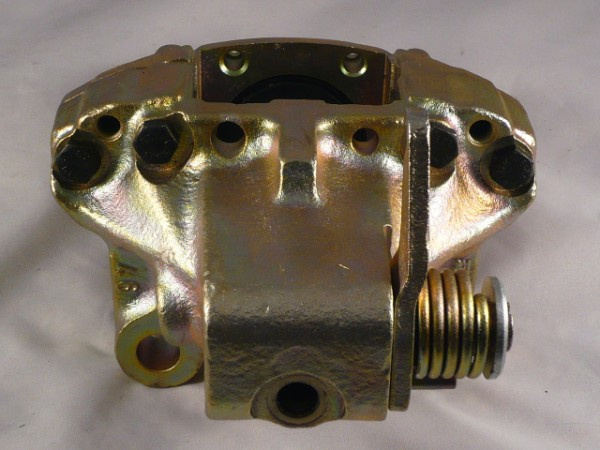

Hi guys,
Can someone tell me/confirm if these rear calipers are for a 914-6?
Thanks,
Bill.

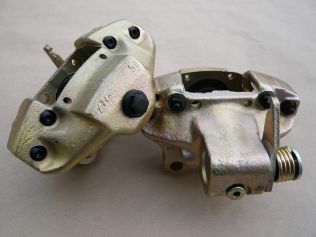

Yes
4's are smaller with a "bump"
Pics stolen from PMB website. The only place to get yours restored.

QUOTE(mepstein @ Aug 12 2017, 06:37 AM) *
Yes
Please note that Mark is our local 914-6 caliper expert as he has his fair share of them (IMG:style_emoticons/default/biggrin.gif)

daytona   Thanks guys. mepstein, where exactly would the bum...   Aug 12 2017, 10:56 AM

914Next   Don't mean to hijack a thread but I think the ...   Aug 12 2017, 01:11 PM
mb911   Don't mean to hijack a thread but I think the ...   Aug 12 2017, 02:13 PM
914Next   Those are front calipers Thanks. For a 4? 6? S...   Aug 12 2017, 03:14 PM
mepstein   [quote name='mb911' post='2516249' date='Aug 12 2...   Aug 12 2017, 03:23 PM
914Sixer   Thr fronts are -6. You can tell by the spacers. ...   Aug 12 2017, 04:00 PM
McMark   I thought the spacers were only for vented discs. ...   Aug 12 2017, 04:18 PM
Matty900   I thought the spacers were only for vented discs....   Aug 12 2017, 09:40 PM
warpig   I thought the spacers were only for vented discs...   Aug 12 2017, 10:20 PM
burton73   I thought the spacers were only for vented discs...   Aug 13 2017, 09:55 AM
McMark   I think Eric told me that the Ferrari unit had so...   Aug 13 2017, 12:11 PM
rgalla9146   I thought the spacers were only for vented discs....   Aug 13 2017, 05:20 AM
McMark   I thought the spacers were only for vented discs...   Aug 13 2017, 07:58 AM
mepstein   [quote name='rgalla9146' post='2516434' date='Aug...   Aug 13 2017, 09:05 AM
toolguy   Six's came with the same brakes as a 911T in f...   Aug 13 2017, 09:29 AM
mepstein   Six's came with the same brakes as a 911T in ...   Aug 13 2017, 09:45 AM
