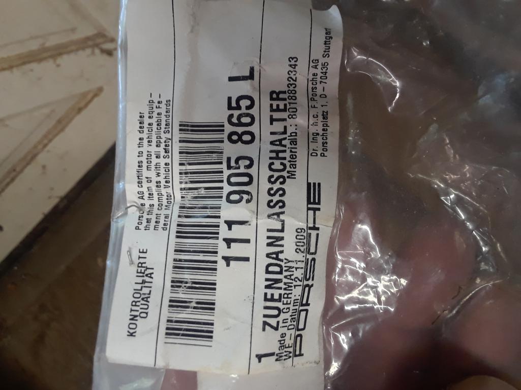

QUOTE(rhodyguy @ Aug 13 2017, 01:37 PM) *
Anyone with first hand experience on the German ones? $40 or whatever for a switch that won't leave you stranded at the worst possible time is cheap insurance.
Yes! I'm not sure if it's the same for earlier cars but the one I got from a Porsche dealer was about 35 bux IIRC
No problems after 3 or so years, the cracked original required a lot of torque to get the starter to engage; it gave up pretty quickly at a gas station nearby. I used the opportunity to clean up the steering wheel lock, change the bearing, and some other things, while I was in there...
Here you go

QUOTE(Porschef @ Aug 13 2017, 03:12 PM) *
Our friends at AA quote the same P/N Official Porsche ones are $45 and change
Here you go
