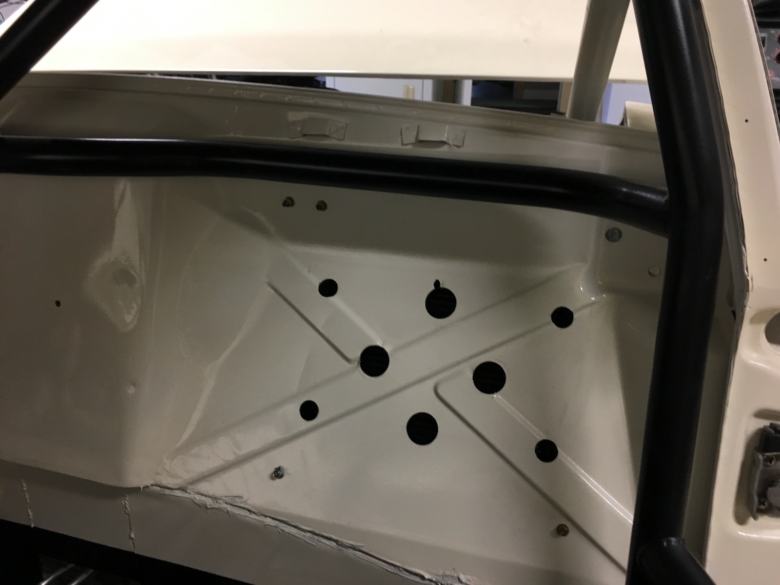

- Resto-Design floorpans, seat areas dropped by 2", with custom tunnel

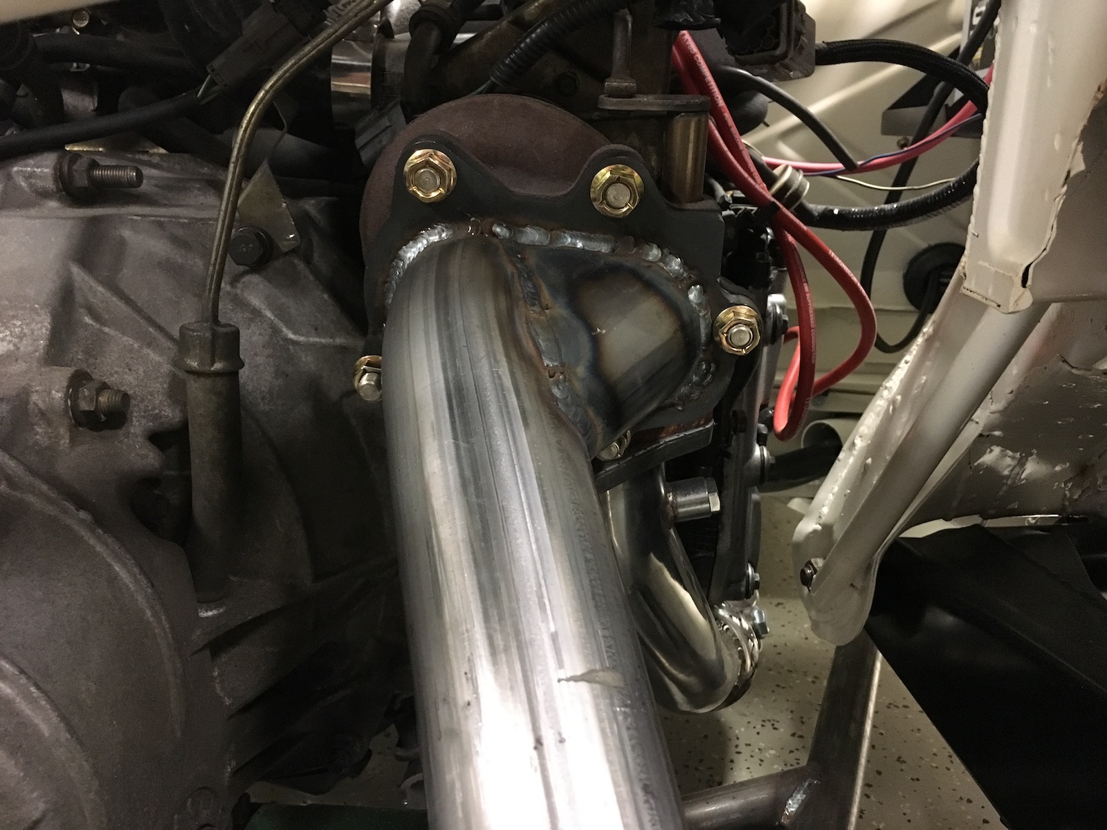

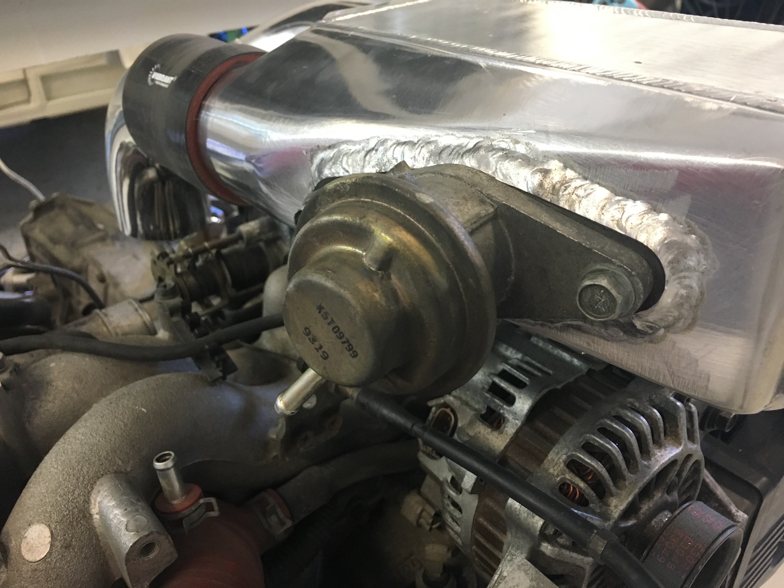

•Finished the IC mount and plumbing. Welded in a flange for the stock BOV, mounted it all up...
• Exhaust is done. 3" stainless, no cat, right out the back.

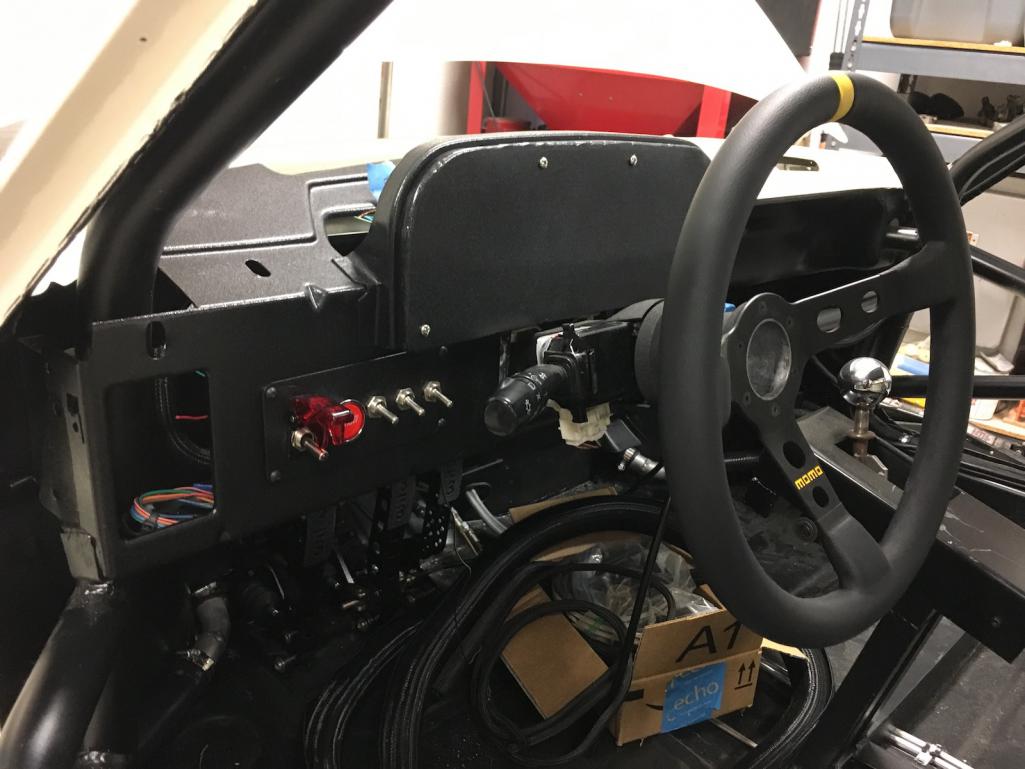

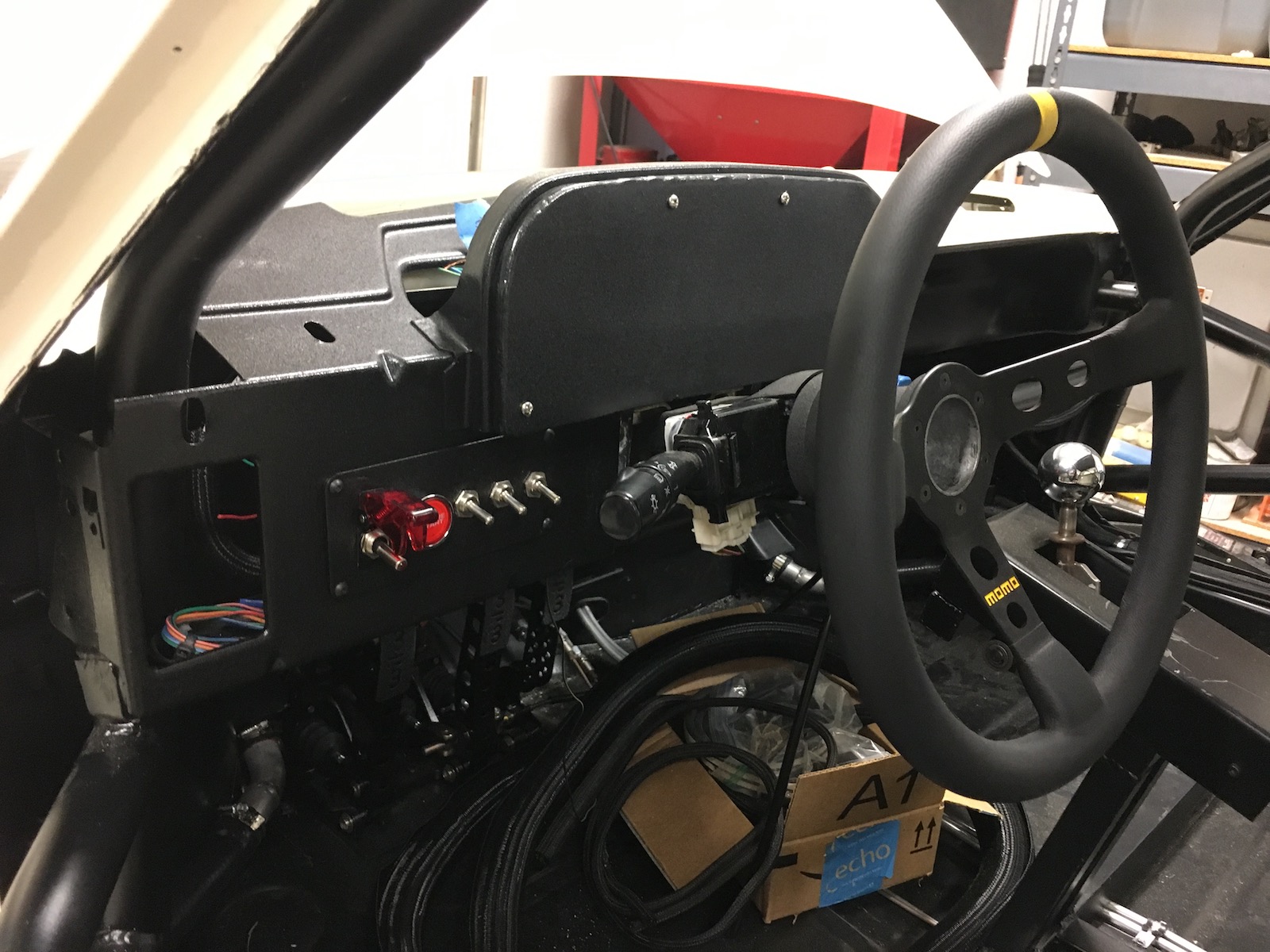

• Dash panel is in, waiting on the tablet mount and it'll have an 8" Fire Tablet running RaceCapture mounted to it. Going to installl oil and check-engine lights into it too.

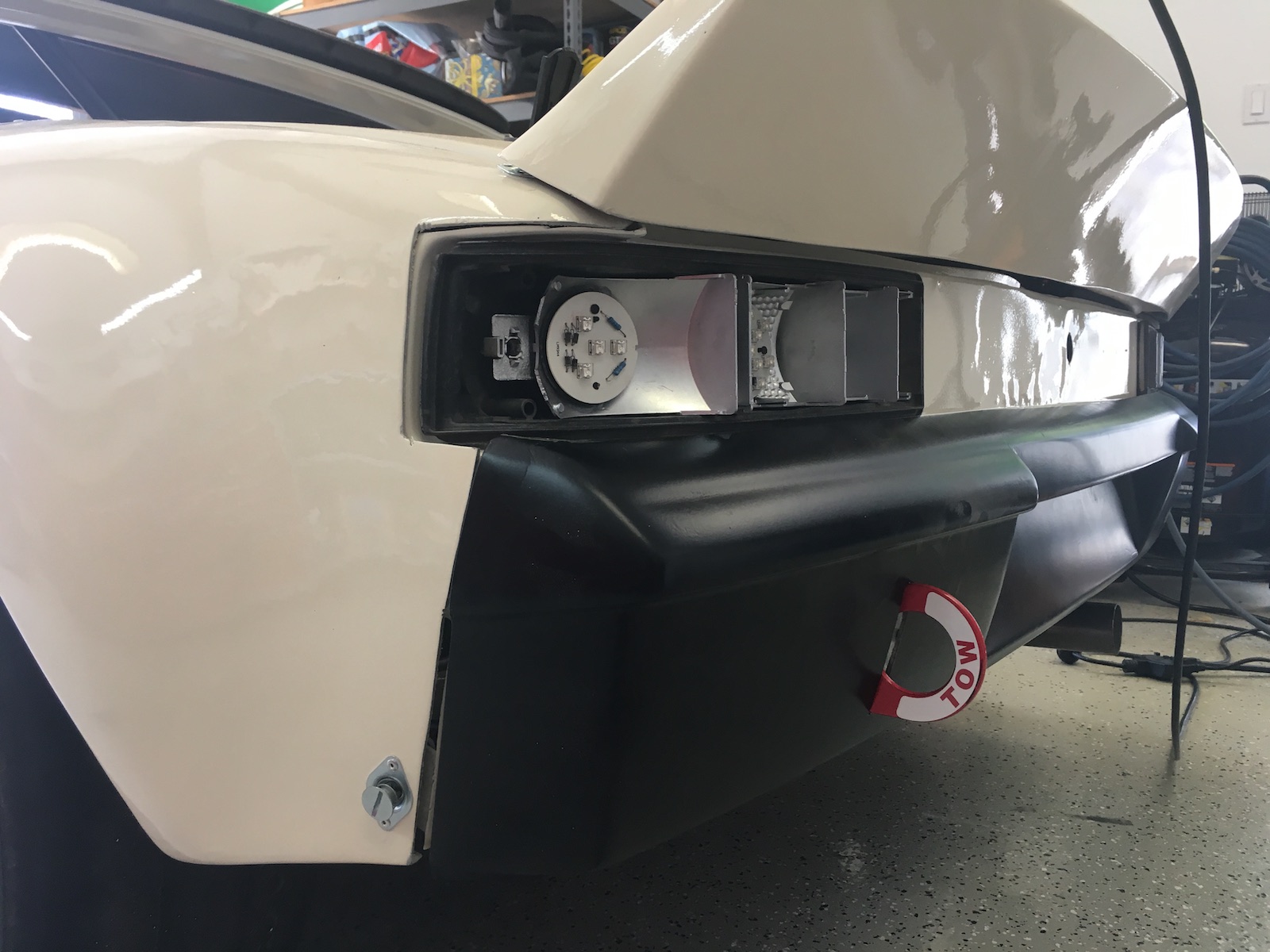

• Tail lights are in.
• Tow hook is mounted up

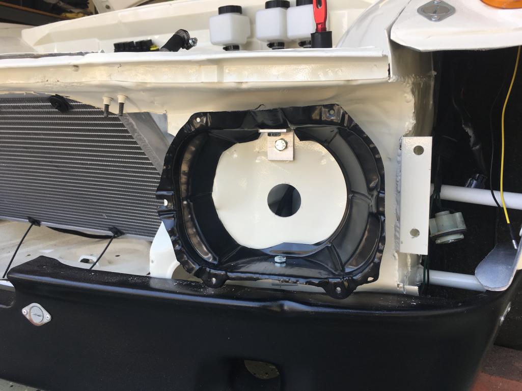

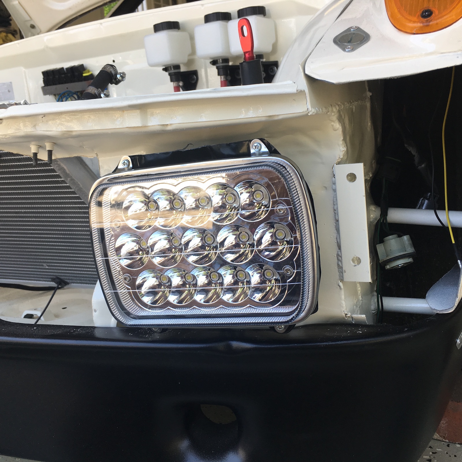

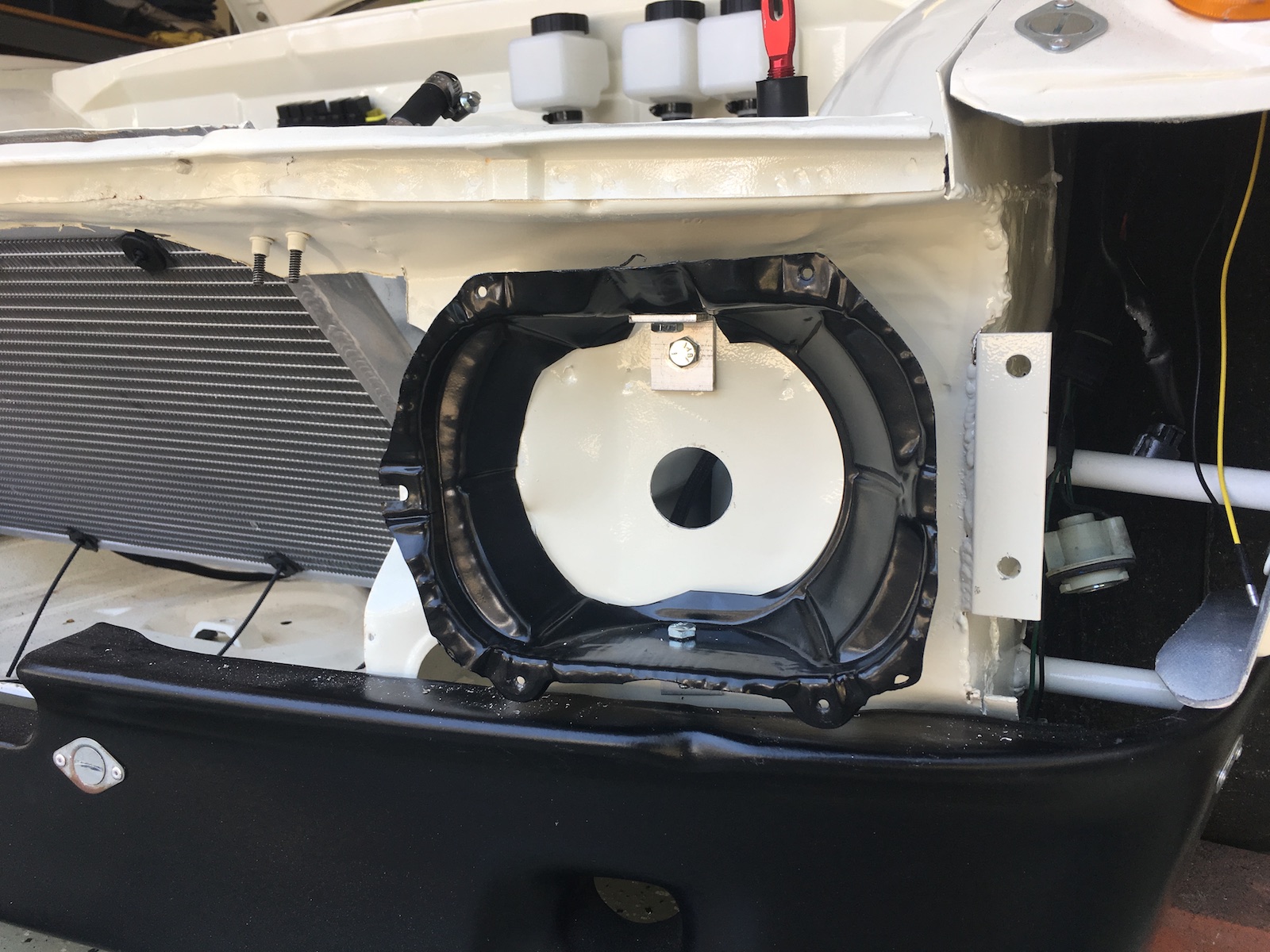

• Added some LED headlights to the front bumper. The WRX harness already had the wiring, might as well make the car road legal. The lenses are too bright for my tastes, Im going to smoke them with some nice vinyl this week.

MichiganMat   Today I worked on dropping the drivers floor pan d...   Jan 31 2016, 10:32 PM
