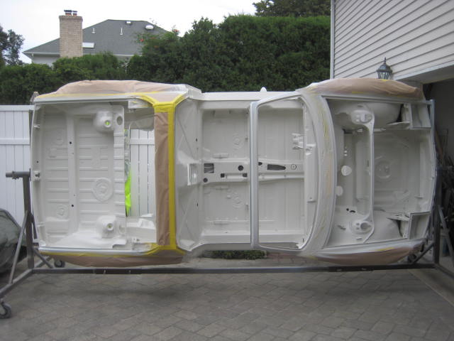

Big day for my GT project.
Getting a combination soda blast and garnet blast on my bare chassis and all the
removable panels.
The baking soda is used to remove paint and is suitable for the body panels.
The garnet is much more course and removes surface rust on the undersides.
I hope I did enough to keep it out of the longs and all the other cavities.
Fingers crossed.
injunmort
post Aug 26 2017, 02:46 PM
Posts: 1,024
Joined: 12-April 10
From: sugarloaf ny
Member No.: 11,604
looking good rory

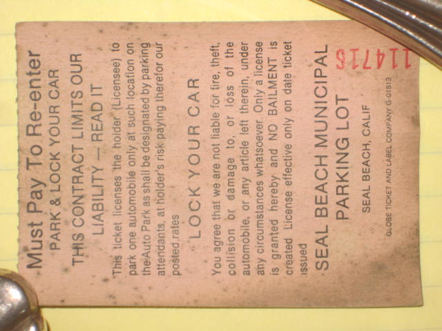

After so much cleaning, welding, blasting and painting I removed the caps from the heater tubes and look what fell out !
Seems the car lived in or at least visited California.

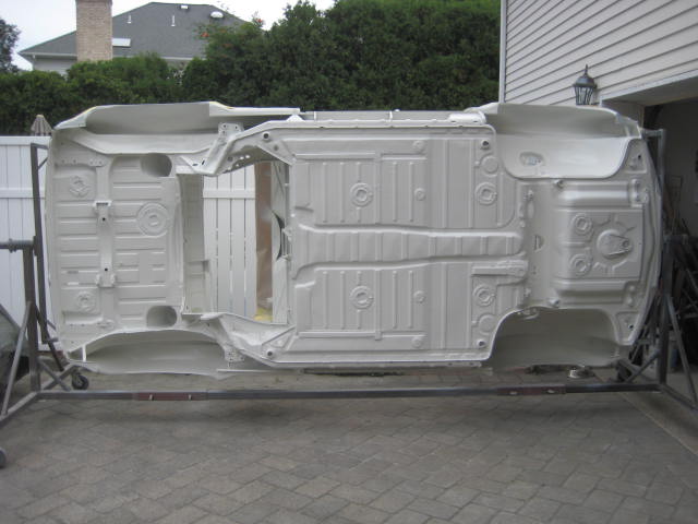

At this point everything is painted except the outside skin.
Should I complete the painting and then assemble ...or assemble now and paint the outside later ?
I wish I had unlimited time and every part ready to be attached.
I'll have to wait at least for a couple weeks before beginning.
Can't wait !
