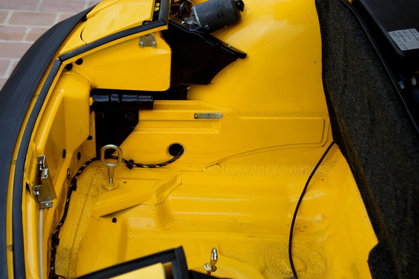

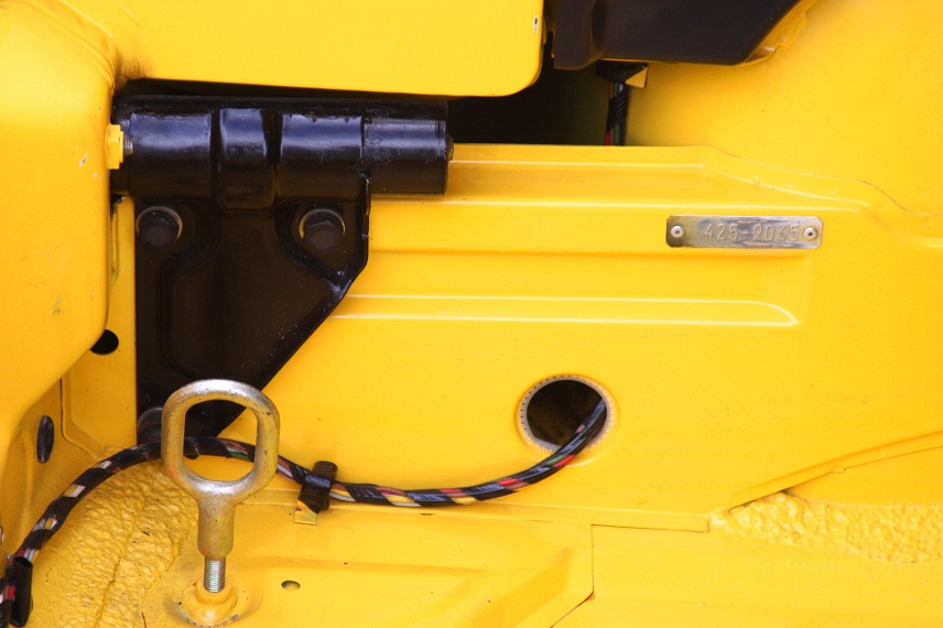

Here is a couple of photos from a 76 of that area.

I think the metal to which you refer is the collision reinforcement in the 73–74 models. It was a safety thing, not a board support thing. It changed in 75 I think.
-Andrew
