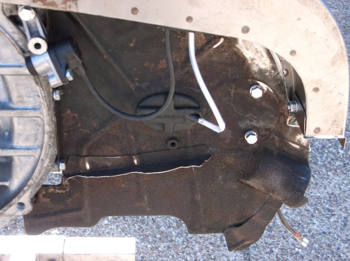

The engine tin is still a work in progress. I have to mod the 914-6 tin to fit the 964 motor. You can see the left rear setup I did.
Once I am ready to complete it, it will be bead blasted then powdercoated along with the rest of the tin.
I have to mod the power steering belt housing before I can make the tin for the right rear.
I have to add the holes for the lower spark plug wires in the side tins, and I still have to figure out how to send air to the heat exchangers. It will probably involve holes in the side tin for air feeds from the fan.
