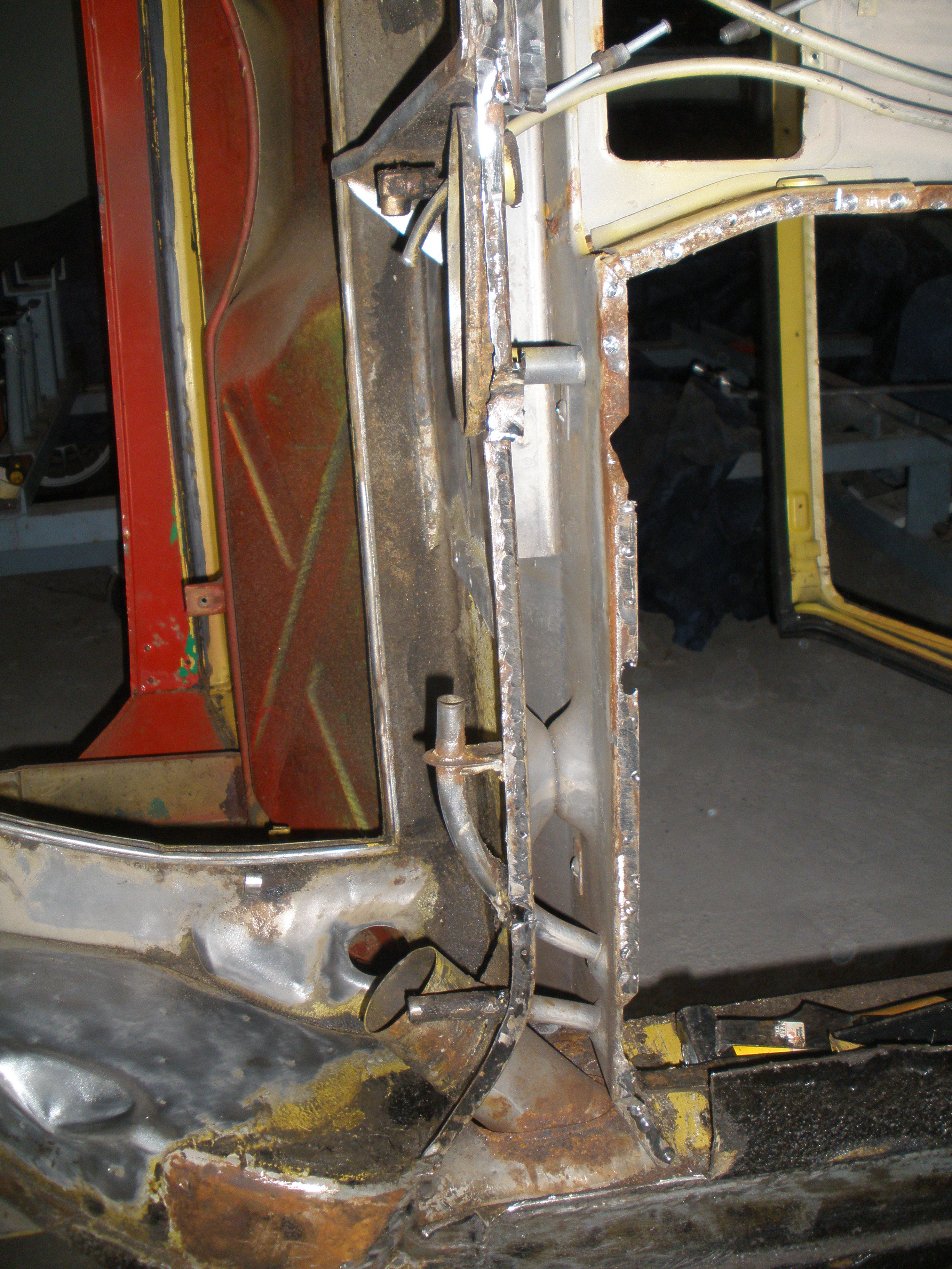

Hello Guys,
since many years I'm working on my 914-6 restoration project. Now I have finished most of the jobs like engine and transmission rebuild, electric harness, suspension ..., now it's time for the body work. Normally before I start I try to collect es much information to get a perfect result.
My body was repaired in the past by unexperienced (IMG:style_emoticons/default/welder.gif) and now I have to fix this badly bodywork. See the pictures and look at the door clearence than you understand.
The question is how can I fix this and if you had the same topic how was it fixed by you.

tomrev   I think you will need to cut out the past patching...   May 18 2016, 06:14 AM
dlee6204   Unfortunately the only way to properly fix it is t...   May 18 2016, 06:19 AM
rgalla9146   It might not be as bad as you think. I'd ...   May 18 2016, 08:21 AM
914Gelb   To roll the car and check the clearance is somethi...   May 18 2016, 10:24 AM
mbseto   My longs look a lot like that. Previous owner wel...   May 18 2016, 02:13 PM
Cairo94507   If you feel the previous repairs were done poorly,...   May 18 2016, 03:33 PM
OU812   Allais, another sunflower yellow car covered in Re...   May 18 2016, 06:31 PM

914Gelb   Here I found a small kink in the metal, 1st I was ...   Jun 21 2017, 04:59 AM
Cairo94507   I am glad to see this project moving along. :bee...   Jun 21 2017, 06:10 AM
Luke M   Keep up the work and post lots of pics of the repa...   Jun 21 2017, 06:36 AM
914Gelb   no this is not the demage I mean see the picture I...   Jun 21 2017, 06:49 AM
bretth   Maybe a previous owner was trying to improve tire ...   Jun 21 2017, 07:46 AM
cary   Do you have some door braces ?   Jun 21 2017, 08:17 AM
914Gelb   Door braces are not installed, bevore I start well...   Jun 21 2017, 11:14 PM
