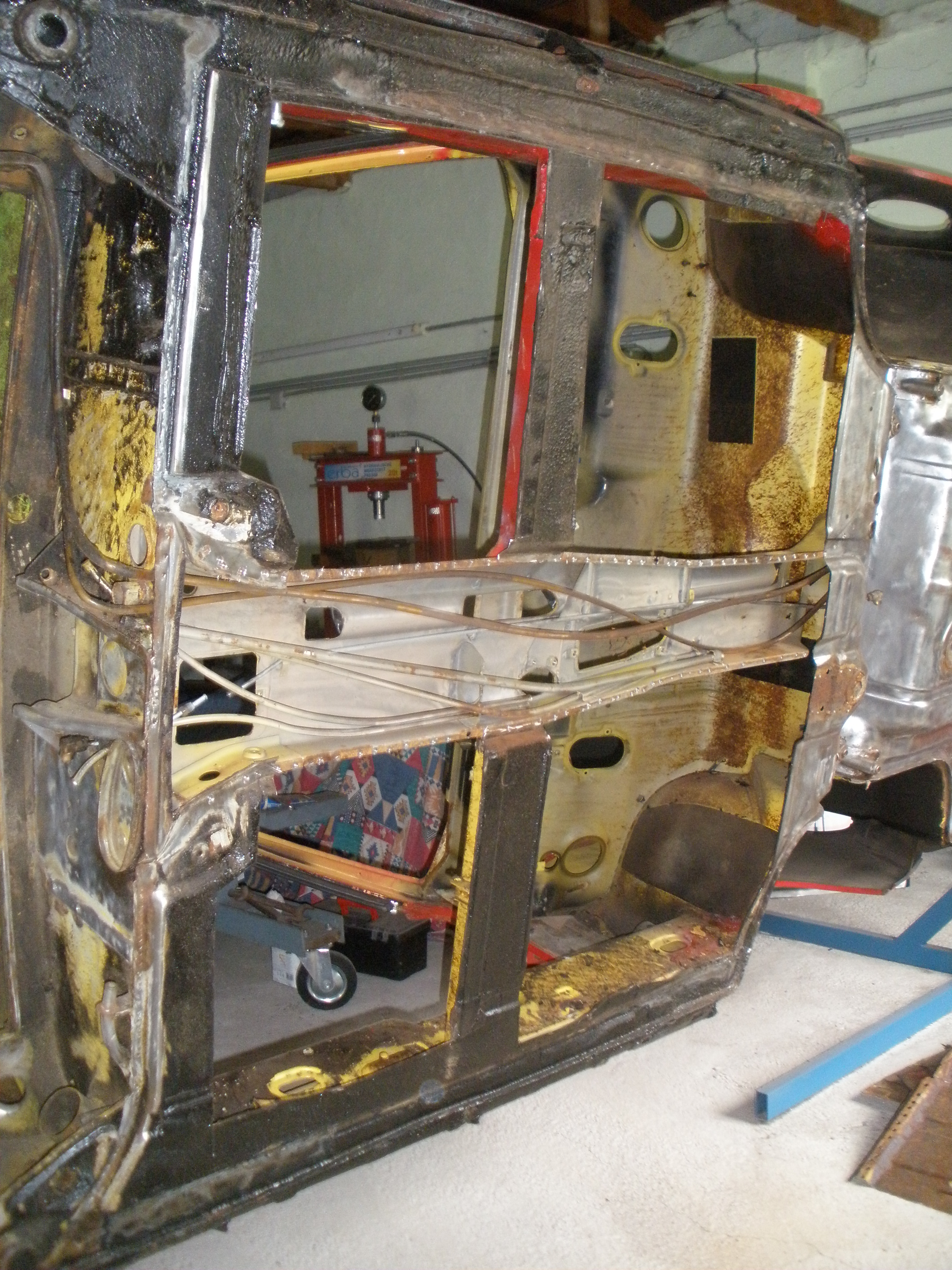

Hello Guys,
since many years I'm working on my 914-6 restoration project. Now I have finished most of the jobs like engine and transmission rebuild, electric harness, suspension ..., now it's time for the body work. Normally before I start I try to collect es much information to get a perfect result.
My body was repaired in the past by unexperienced (IMG:style_emoticons/default/welder.gif) and now I have to fix this badly bodywork. See the pictures and look at the door clearence than you understand.
The question is how can I fix this and if you had the same topic how was it fixed by you.

tomrev   I think you will need to cut out the past patching...   May 18 2016, 06:14 AM
dlee6204   Unfortunately the only way to properly fix it is t...   May 18 2016, 06:19 AM
rgalla9146   It might not be as bad as you think. I'd ...   May 18 2016, 08:21 AM
914Gelb   To roll the car and check the clearance is somethi...   May 18 2016, 10:24 AM
mbseto   My longs look a lot like that. Previous owner wel...   May 18 2016, 02:13 PM

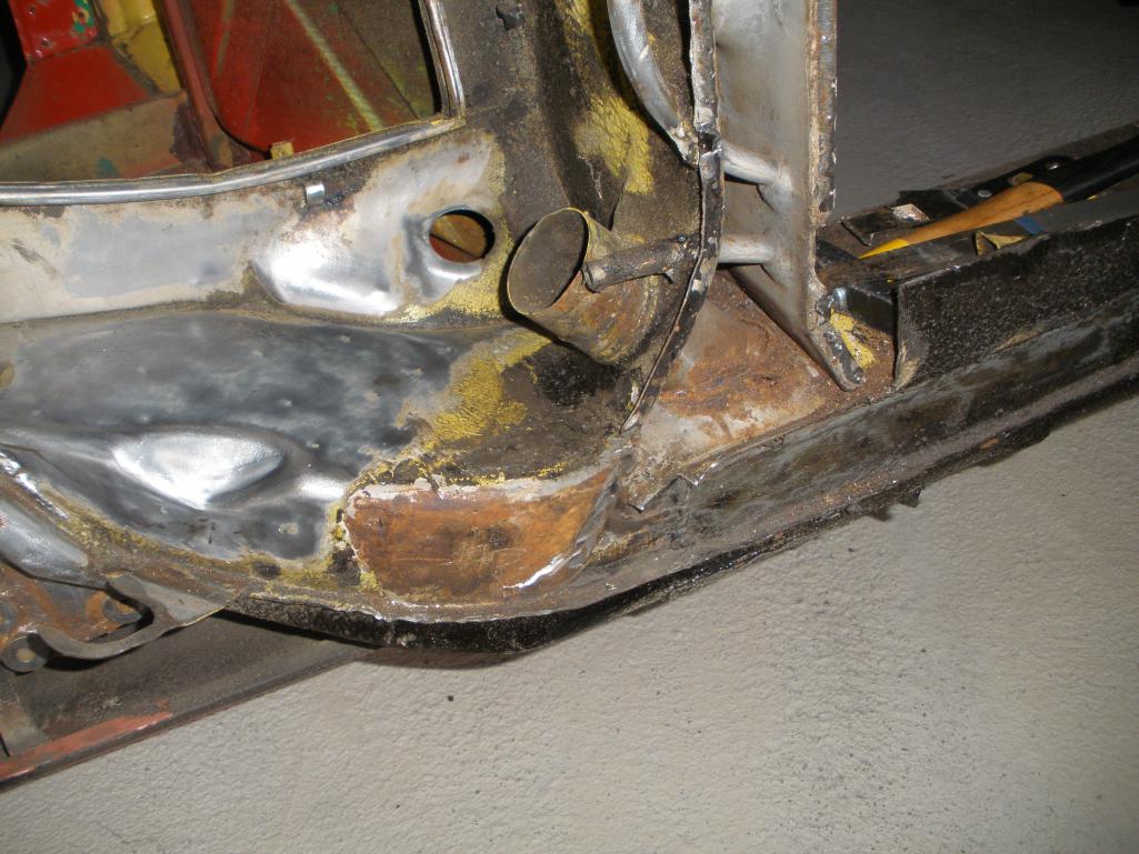

914Gelb   After many months I can continue working on my 914...   Jun 21 2017, 04:42 AM
914Gelb   RE: Any idea how to solve bad door clearence   Jun 21 2017, 04:45 AM
914Gelb   Started removing rubber   Jun 21 2017, 04:48 AM
914Gelb   Here I found a small kink in the metal, 1st I was ...   Jun 21 2017, 04:59 AM

914Gelb   no this is not the demage I mean see the picture I...   Jun 21 2017, 06:49 AM
bretth   Maybe a previous owner was trying to improve tire ...   Jun 21 2017, 07:46 AM
cary   Do you have some door braces ?   Jun 21 2017, 08:17 AM
914Gelb   Door braces are not installed, bevore I start well...   Jun 21 2017, 11:14 PM
flyer86d   Looks like a nice car. You know, all of those prev...   Jun 22 2017, 05:47 AM
914Gelb   Looks like a nice car. You know, all of those pre...   Jun 22 2017, 06:08 AM

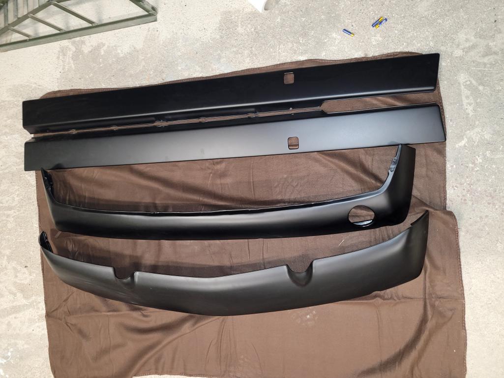

914Gelb   I continued working on my 914-6. The next step was...   Sep 19 2017, 11:28 PM
914Gelb   RE: Any idea how to solve bad door clearence   Sep 19 2017, 11:29 PM
914Gelb   RE: Any idea how to solve bad door clearence   Sep 19 2017, 11:30 PM
914Gelb   RE: Any idea how to solve bad door clearence   Sep 19 2017, 11:31 PM
914Gelb   RE: Any idea how to solve bad door clearence   Sep 19 2017, 11:33 PM

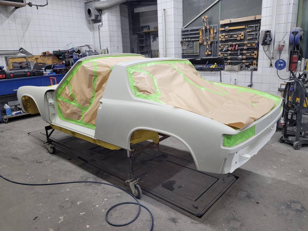

914Gelb   :cheer: It looks like the body of my car is now r...   Sep 27 2023, 07:03 AM
914Gelb   RE: Any idea how to solve bad door clearence   Sep 27 2023, 07:05 AM
mepstein   :trophy:   Sep 27 2023, 07:06 AM
914Gelb   RE: Any idea how to solve bad door clearence   Sep 27 2023, 07:06 AM
914Gelb   RE: Any idea how to solve bad door clearence   Sep 27 2023, 07:07 AM
914Gelb   RE: Any idea how to solve bad door clearence   Sep 27 2023, 07:09 AM
914Gelb   RE: Any idea how to solve bad door clearence   Sep 27 2023, 07:11 AM
914Gelb   RE: Any idea how to solve bad door clearence   Sep 27 2023, 07:14 AM

914Gelb   RE: Any idea how to solve bad door clearence   Sep 27 2023, 07:19 AM
mlindner   Wow, that is a great job. will be fun to see it al...   Sep 27 2023, 07:24 AM
914Gelb   All the pain job you see I made by my own, covers ...   Sep 27 2023, 07:29 AM

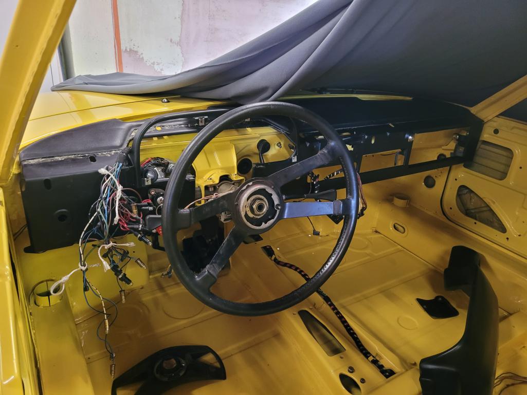

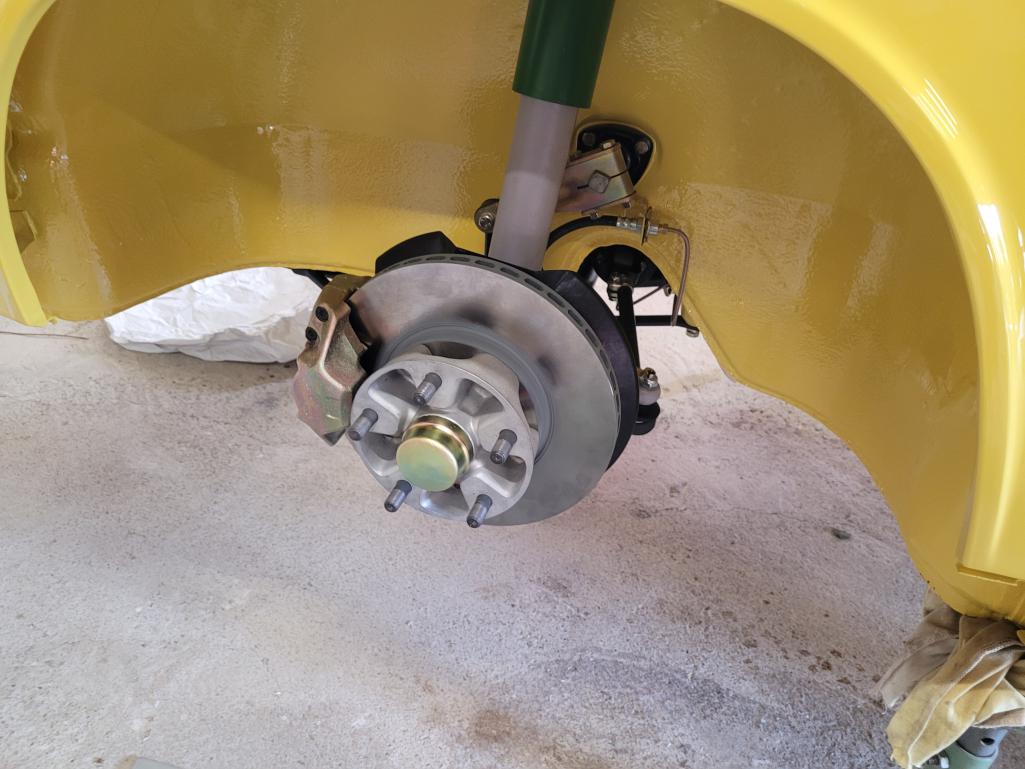

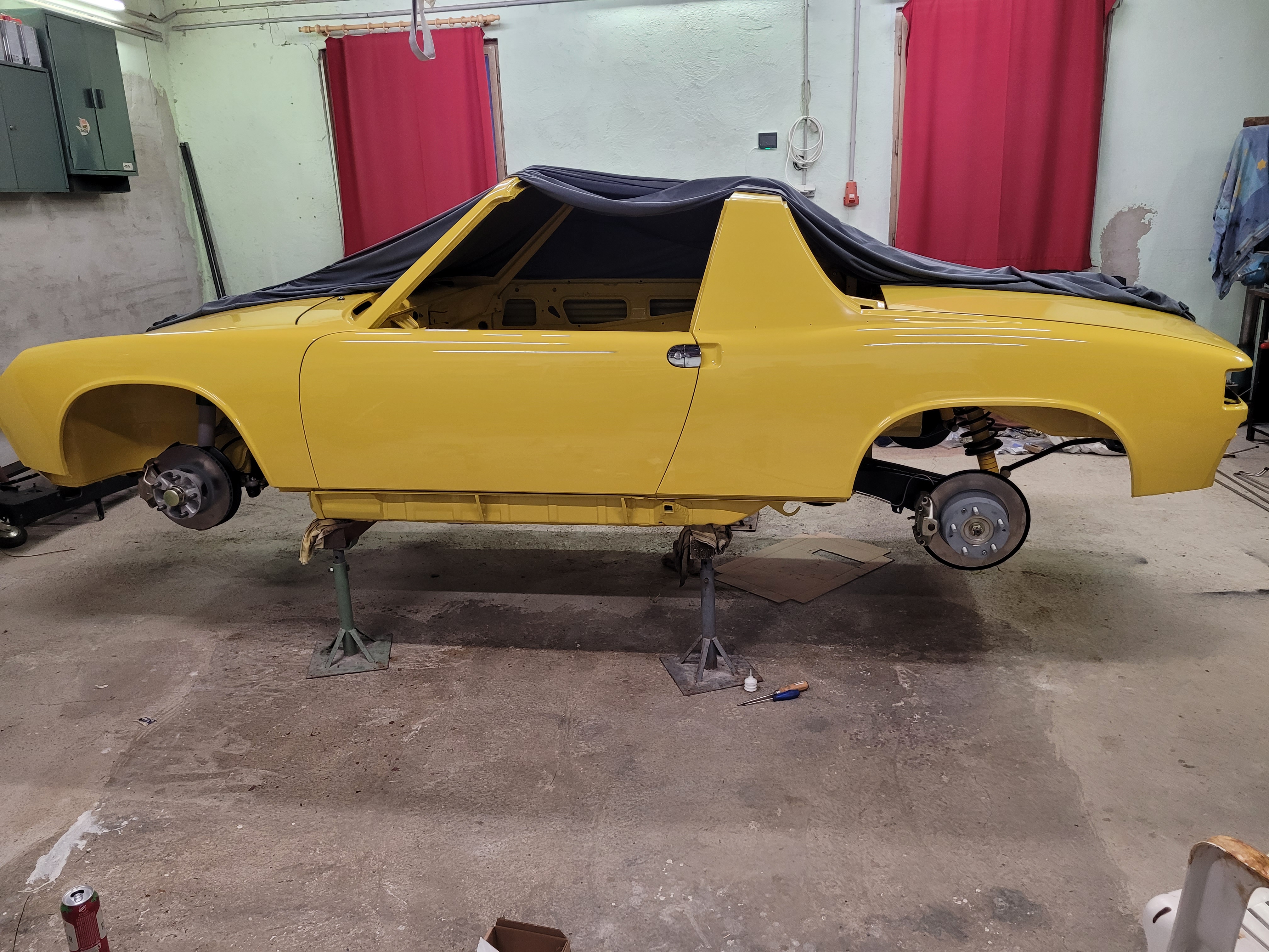

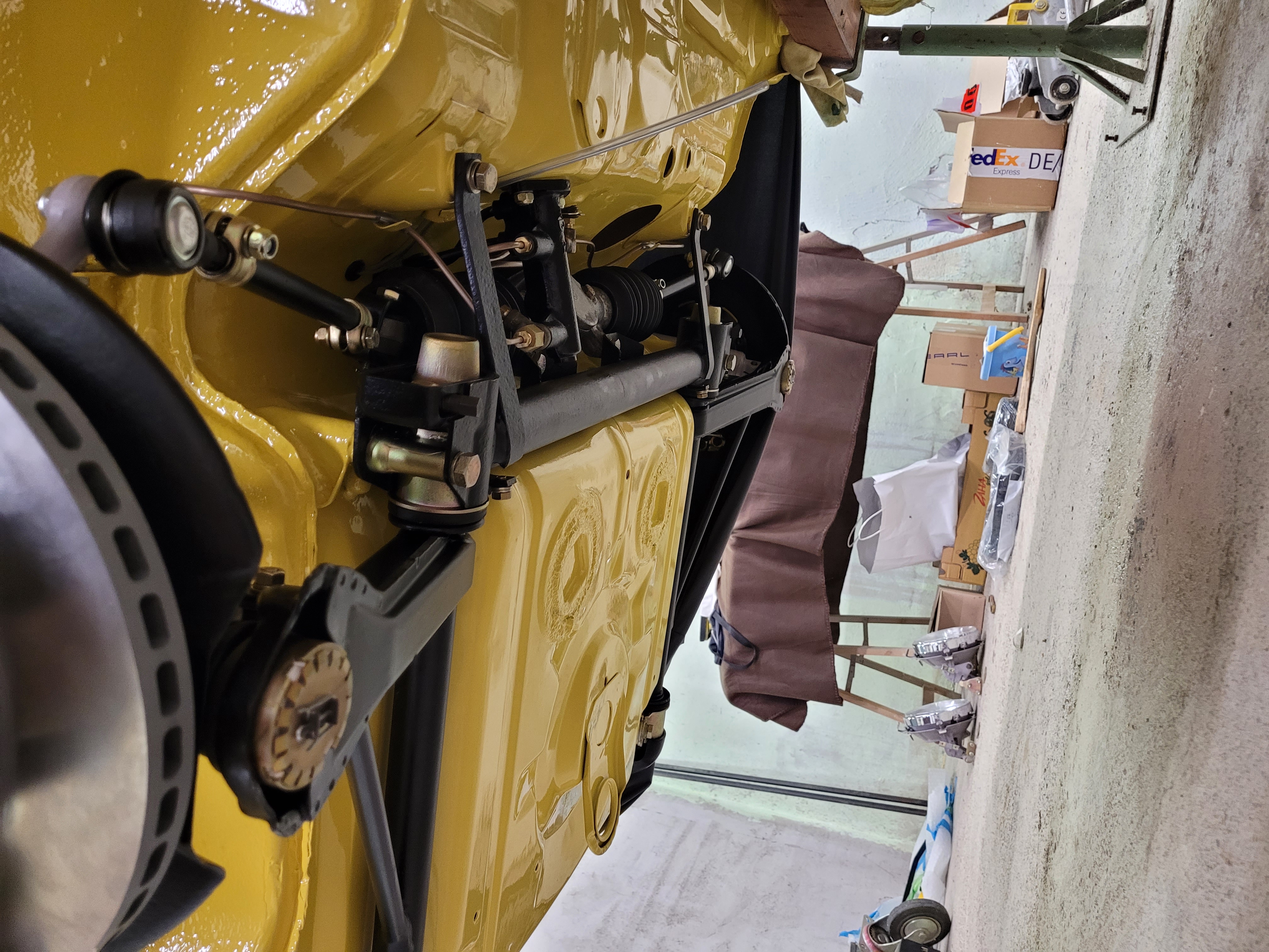

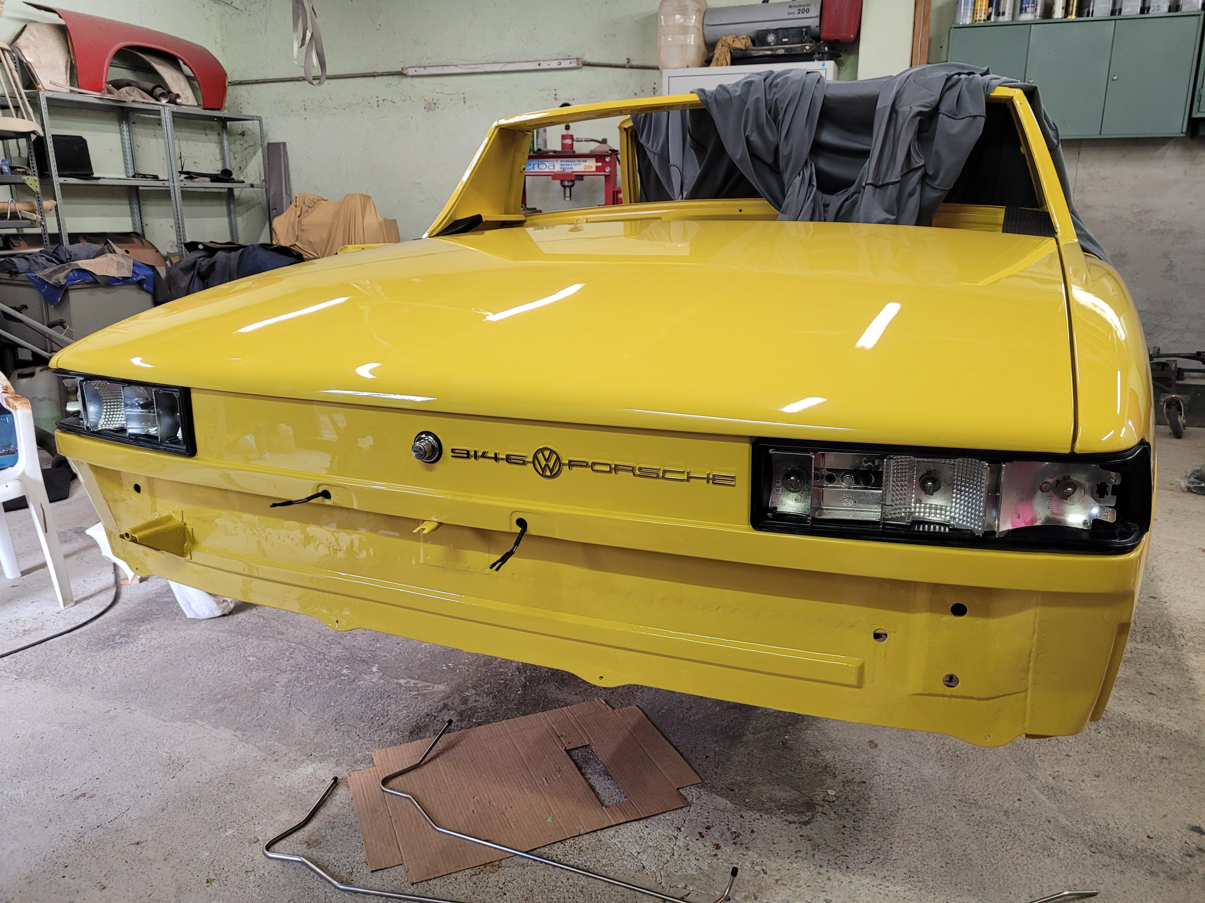

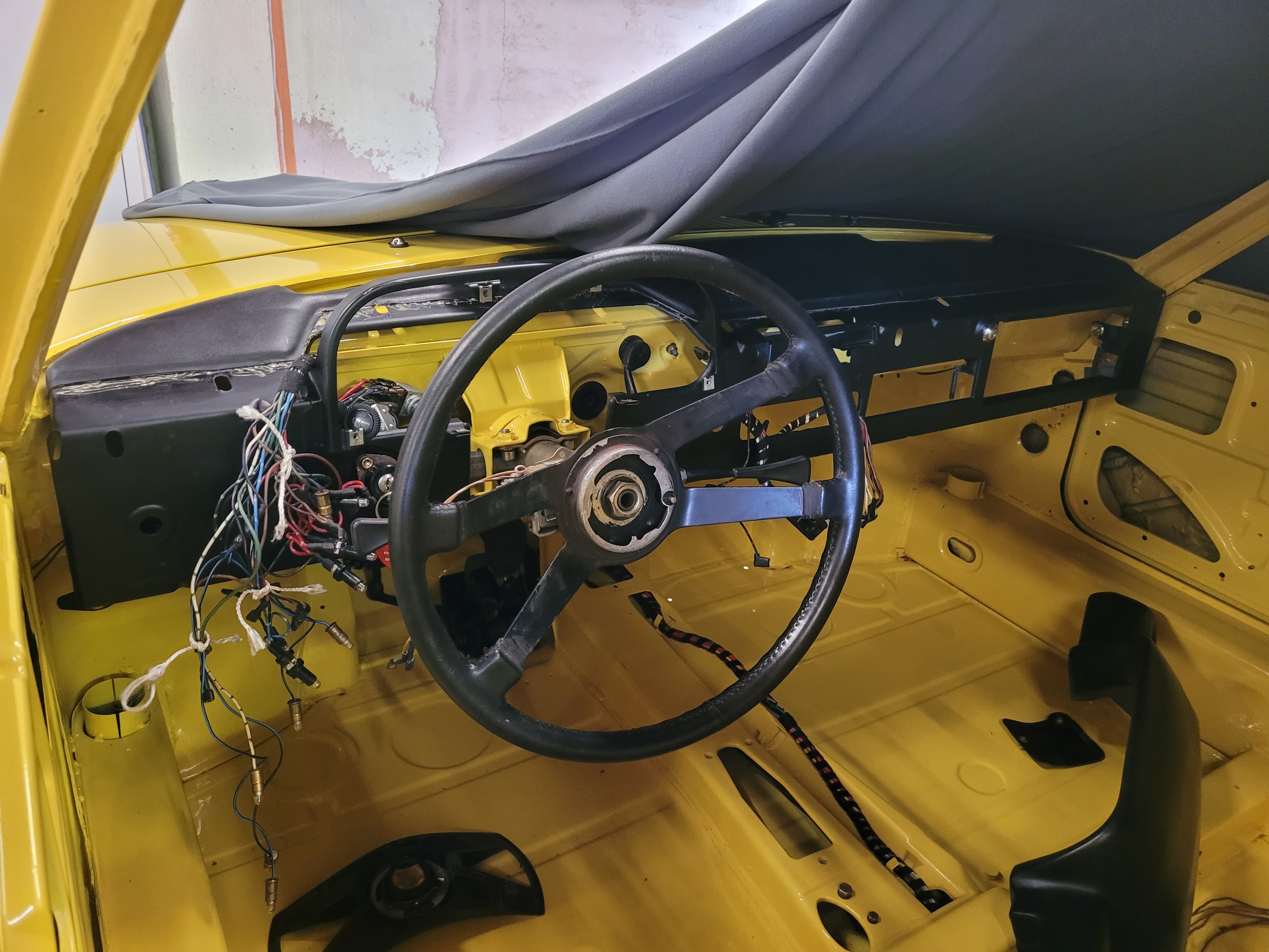

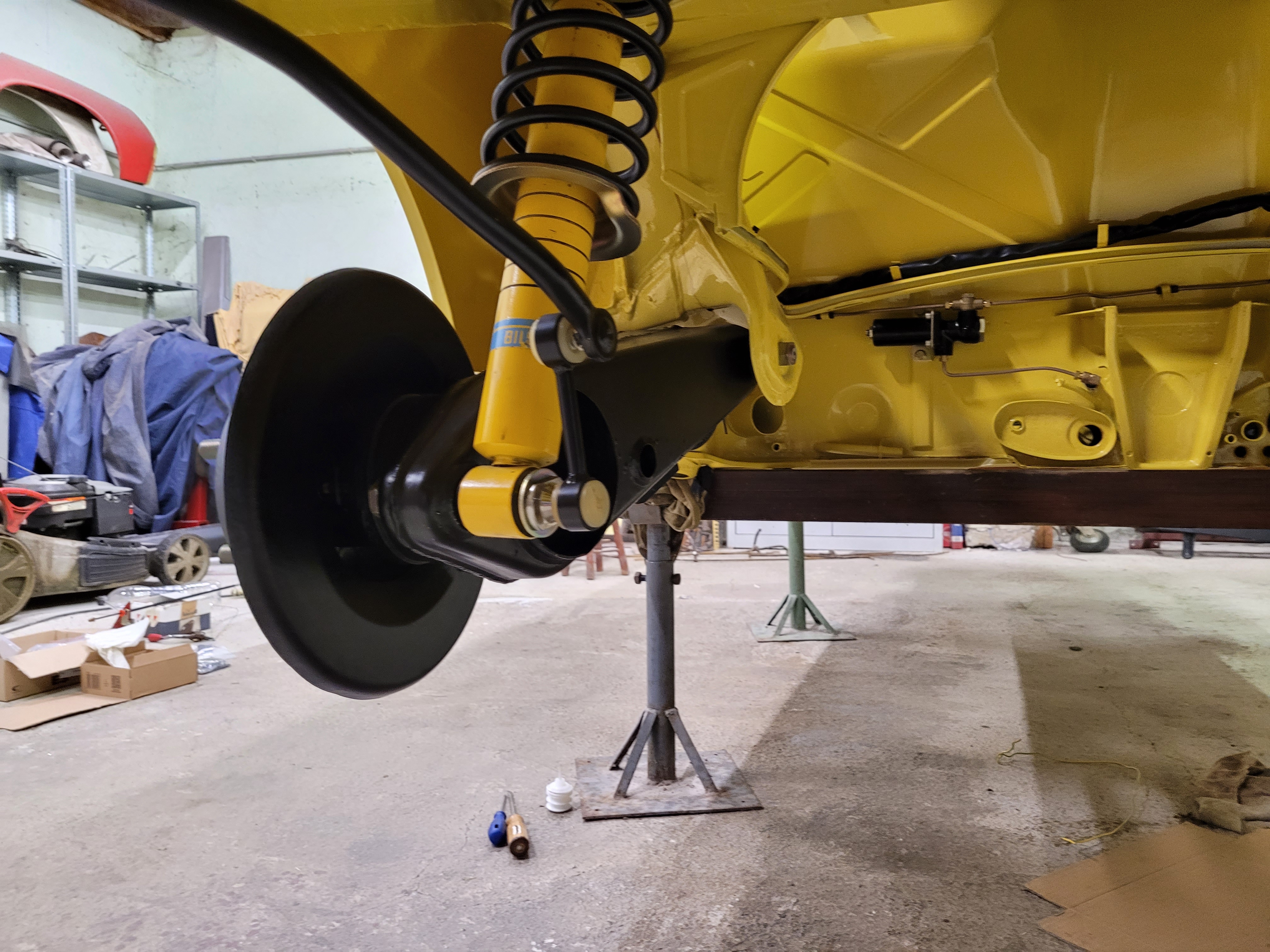

914Gelb   Slowly I proceed with the rebuild of my car, there...   Sep 24 2024, 11:29 PM
914Gelb   The paint is single stage from glasuit, look at...   Sep 24 2024, 11:32 PM
914Gelb   RE: Any idea how to solve bad door clearence   Sep 24 2024, 11:34 PM
914Gelb   RE: Any idea how to solve bad door clearence   Sep 24 2024, 11:35 PM
914Gelb   RE: Any idea how to solve bad door clearence   Sep 24 2024, 11:37 PM
914Gelb   RE: Any idea how to solve bad door clearence   Sep 24 2024, 11:38 PM
914Gelb   RE: Any idea how to solve bad door clearence   Sep 24 2024, 11:40 PM
914Gelb   RE: Any idea how to solve bad door clearence   Sep 24 2024, 11:41 PM
914Gelb   RE: Any idea how to solve bad door clearence   Sep 24 2024, 11:43 PM
914Gelb   RE: Any idea how to solve bad door clearence   Sep 24 2024, 11:45 PM
914Gelb   RE: Any idea how to solve bad door clearence   Sep 24 2024, 11:46 PM
