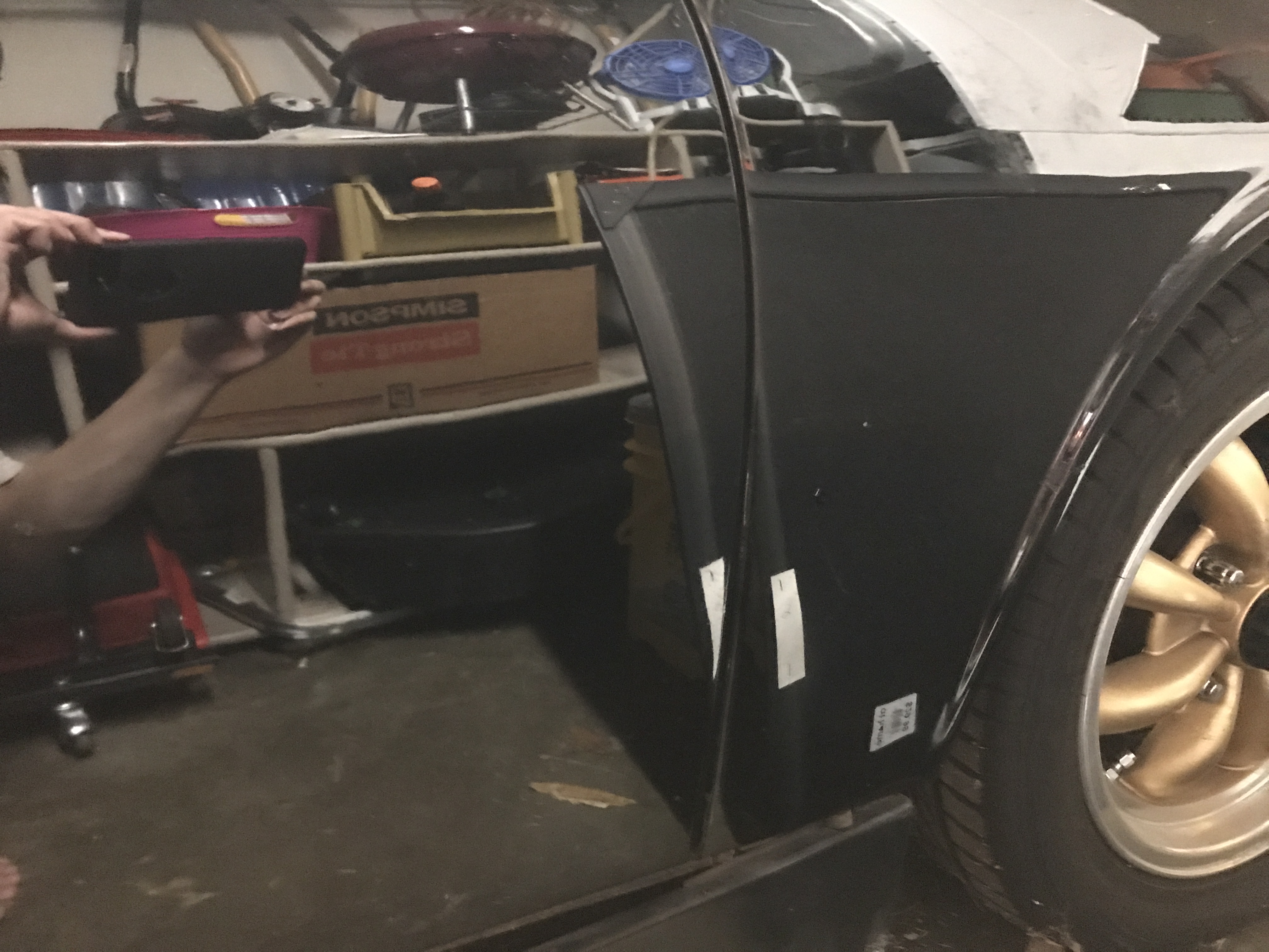

So I'm on the fence about selling my 914. I discovered that the rust on my car was worse than expected. At this point I'm not sure if I can afford to fix the car properly but at the same time the car does bring me a good amount of joy. I posted these pictures on a 914 page and was told it was bad. Here's what I would like to know. Roughly how bad is this rust? Could I just por15 it and just enjoy the car as is for now? Finally how much do you think it's worth in the current state? Any advice is appreciated

Right door gap

rjames   POR15 doesn't fix rust, it just covers it up. ...   Oct 1 2017, 12:21 AM
GeorgeRud   Depending on where you are in Texas, you might fin...   Oct 1 2017, 06:59 AM
era vulgaris   I used to own a '72 that was similar to your c...   Oct 1 2017, 07:46 AM
1973Porsche   Thank you all for the advice. I adjust the picture...   Oct 1 2017, 08:46 AM
mb911   Looks like it needs long repair, rear floor pan, j...   Oct 1 2017, 08:50 AM
cary   Downsize the pictures with Paint : resize. Most of...   Oct 1 2017, 10:01 AM
Mblizzard   As a guy that has looked at many hopeless causes a...   Oct 1 2017, 01:19 PM
ClayPerrine   If you are close to me, I will be happy to give yo...   Oct 1 2017, 01:23 PM
SirAndy   If you just upload the images here instead of imgu...   Oct 1 2017, 01:25 PM
1973Porsche   Don't think this a parts car yet. I know it...   Oct 1 2017, 04:47 PM
rjames   Don't think this a parts car yet. I know it...   Oct 1 2017, 05:34 PM
Unobtanium-inc   One thing to consider before making this a "p...   Oct 1 2017, 05:31 PM
1973Porsche   Like I stated before I don't think this is pas...   Oct 1 2017, 05:43 PM
mb911   Not a parts car.. Very savable.. I teach welding a...   Oct 1 2017, 05:47 PM
Andyrew   New floor pans and new rockers. Likely new rear tr...   Oct 1 2017, 07:22 PM
1973Porsche   Rear trunk is good actually been under it, and abo...   Oct 1 2017, 07:50 PM
rjames   Rear trunk is good actually been under it, and ab...   Oct 2 2017, 12:31 PM
Andyrew   Its worth the price of a running engine and trans ...   Oct 2 2017, 12:46 PM
tygaboy   Its worth the price of a running engine and trans...   Oct 2 2017, 01:54 PM
1973Porsche   I think people who are calling this a parts car ar...   Oct 2 2017, 05:46 PM
Unobtanium-inc   I think people who are calling this a parts car a...   Oct 2 2017, 05:58 PM
cary   Can you take another picture that gives it more...   Oct 2 2017, 07:40 PM
cary   How about a shot of the right door gaps .............   Oct 2 2017, 07:54 PM
1973Porsche   Right door gap   Oct 2 2017, 08:41 PM
cary   The other side. That one isn't effected by the...   Oct 2 2017, 08:58 PM
1973Porsche   1.   Oct 2 2017, 09:23 PM
1973Porsche   2.   Oct 2 2017, 09:24 PM
cary   Same shot as number 2. But the other (right) side....   Oct 2 2017, 11:22 PM
era vulgaris   Same shot as number 2. But the other (right) side...   Oct 3 2017, 07:59 AM
Philip W.   this is close to how bad mine was . It is fixable ...   Oct 3 2017, 06:39 AM
bbrock   I agree with those saying your car is NOT a parts ...   Oct 3 2017, 08:12 AM
Philip W.   this was mine- pretty bad,   Oct 3 2017, 11:36 AM
Philip W.   i dont want to clog your thread with my pictures b...   Oct 3 2017, 11:42 AM
1973Porsche   Here's the picture of the passenger side door ...   Oct 12 2017, 06:26 PM
Porschef   It's certainly shiny...don't look bad...   Oct 13 2017, 03:40 AM
bbrock   It's certainly shiny...don't look bad...   Oct 13 2017, 10:26 AM
