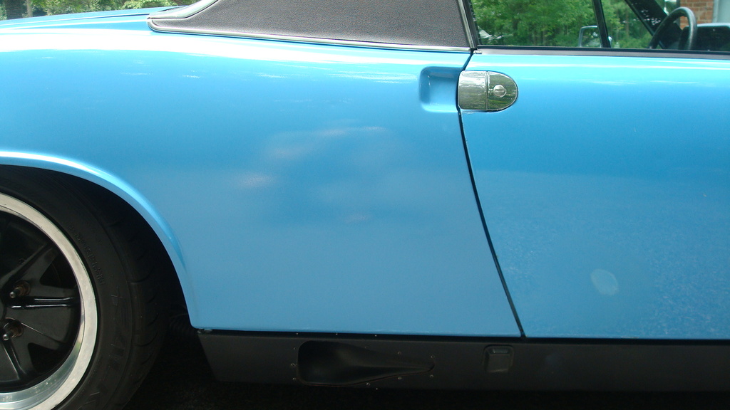

Same shot as number 2. But the other (right) side. But shoot it straight on so we can see the gap.

QUOTE(cary @ Oct 3 2017, 01:22 AM) *
(IMG:style_emoticons/default/agree.gif) Here's an example. We need to see a shot that looks like this. Straight on, on the passenger side rear door gap. That's the one that will tell you if the frame is starting to fold (the driver's rear door gap will as well, but it usually starts on the passenger side because that's where the battery is). If there is a consistent gap from top to bottom, you're good. If the gap varies, or if there is little or no gap at all, or if the gap changes when you lift the rear of the car off the ground on jacks, then you're in trouble.
