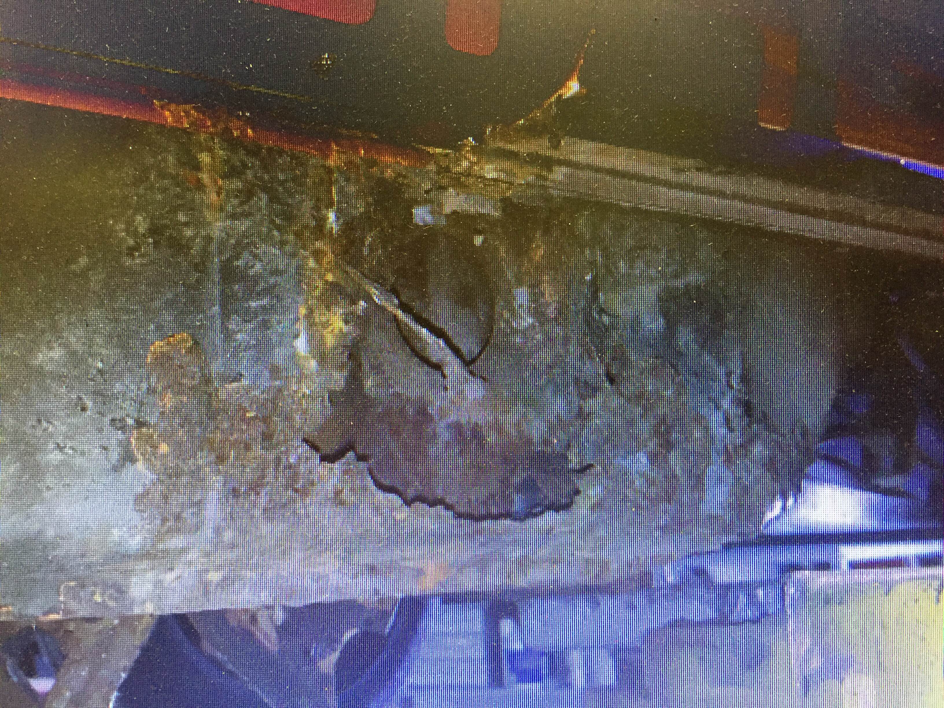

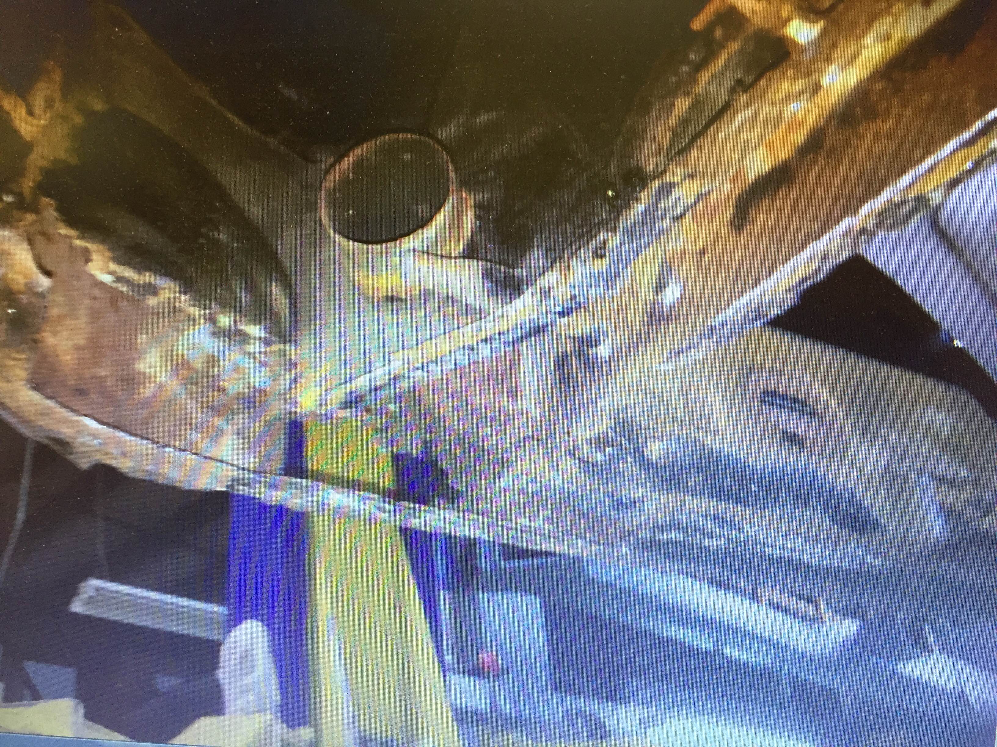

So I'm on the fence about selling my 914. I discovered that the rust on my car was worse than expected. At this point I'm not sure if I can afford to fix the car properly but at the same time the car does bring me a good amount of joy. I posted these pictures on a 914 page and was told it was bad. Here's what I would like to know. Roughly how bad is this rust? Could I just por15 it and just enjoy the car as is for now? Finally how much do you think it's worth in the current state? Any advice is appreciated

rjames   POR15 doesn't fix rust, it just covers it up. ...   Oct 1 2017, 12:21 AM
GeorgeRud   Depending on where you are in Texas, you might fin...   Oct 1 2017, 06:59 AM
era vulgaris   I used to own a '72 that was similar to your c...   Oct 1 2017, 07:46 AM

mb911   Looks like it needs long repair, rear floor pan, j...   Oct 1 2017, 08:50 AM

Mblizzard   As a guy that has looked at many hopeless causes a...   Oct 1 2017, 01:19 PM
ClayPerrine   If you are close to me, I will be happy to give yo...   Oct 1 2017, 01:23 PM

mb911   Not a parts car.. Very savable.. I teach welding a...   Oct 1 2017, 05:47 PM
Andyrew   New floor pans and new rockers. Likely new rear tr...   Oct 1 2017, 07:22 PM

Philip W.   this is close to how bad mine was . It is fixable ...   Oct 3 2017, 06:39 AM
bbrock   I agree with those saying your car is NOT a parts ...   Oct 3 2017, 08:12 AM
