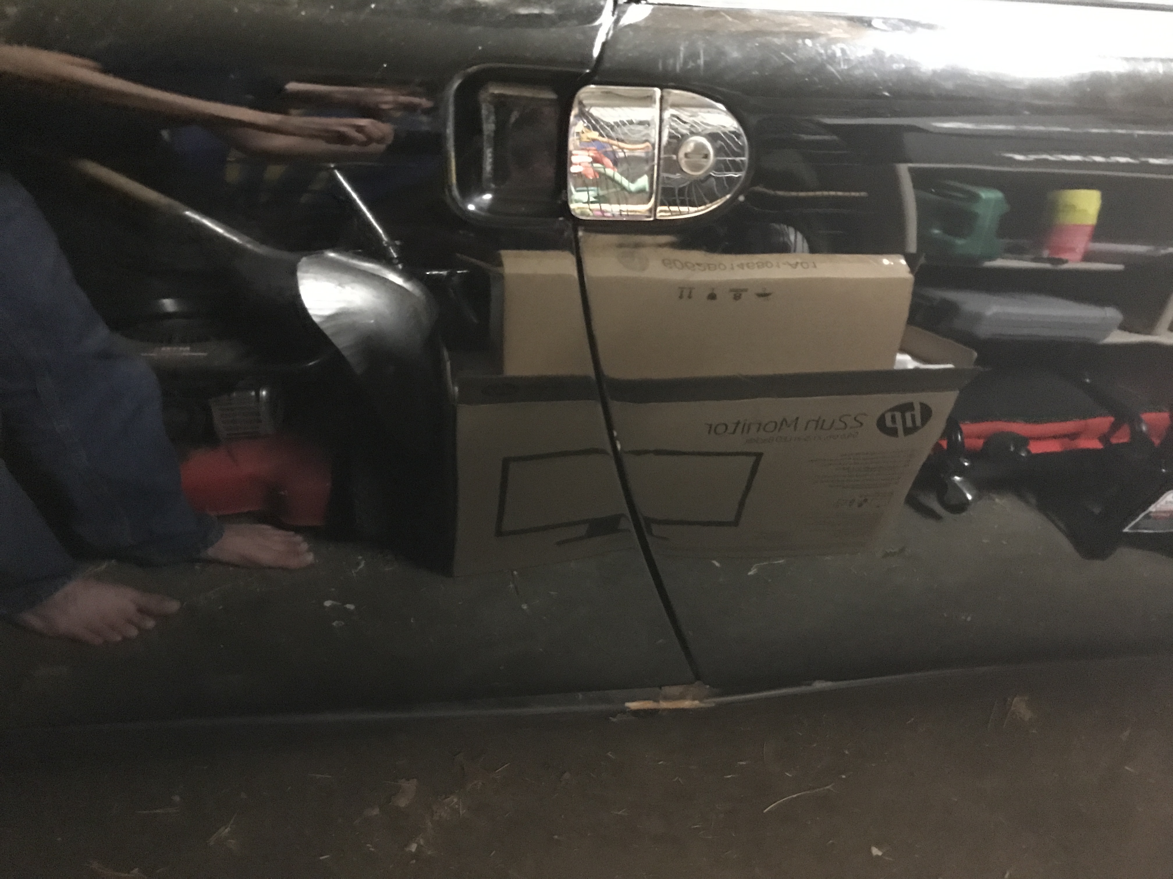

So I'm on the fence about selling my 914. I discovered that the rust on my car was worse than expected. At this point I'm not sure if I can afford to fix the car properly but at the same time the car does bring me a good amount of joy. I posted these pictures on a 914 page and was told it was bad. Here's what I would like to know. Roughly how bad is this rust? Could I just por15 it and just enjoy the car as is for now? Finally how much do you think it's worth in the current state? Any advice is appreciated

1973Porsche
post Oct 12 2017, 06:26 PM
Posts: 39
Joined: 4-February 12
From: Texas
Member No.: 14,086
Here's the picture of the passenger side door line.

1973Porsche   Here's the picture of the passenger side door ...   Oct 12 2017, 06:26 PM
