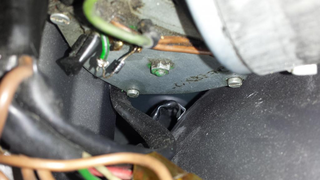

Picture of the area mentioned above; I didn't discover the issue until I turned on the lights and moved my finger in theat area. The light would momentarily go up or down when the connection resumed
(IMG:http://www.914world.com/bbs2/uploads/post-721-1441581432_thumb.jpg) |
