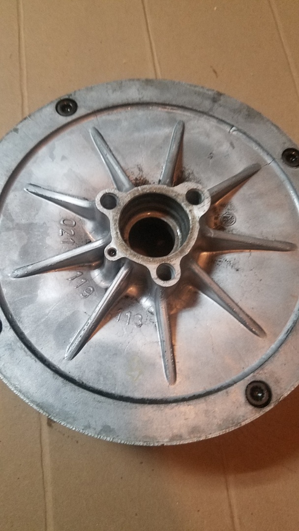

Started to clean the engine again to get it ready to put back together.
I Bought a media blaster kit to hook up to my pressure washer....
I am using baking soda for the media.... 1st test and it works pretty darn good, just messy (more so the water spraying back at me ) I'll have to fix that!
There was a lot more build up between the webs before I gave it a blast. Just plain water out of the gun didn't do squat.
