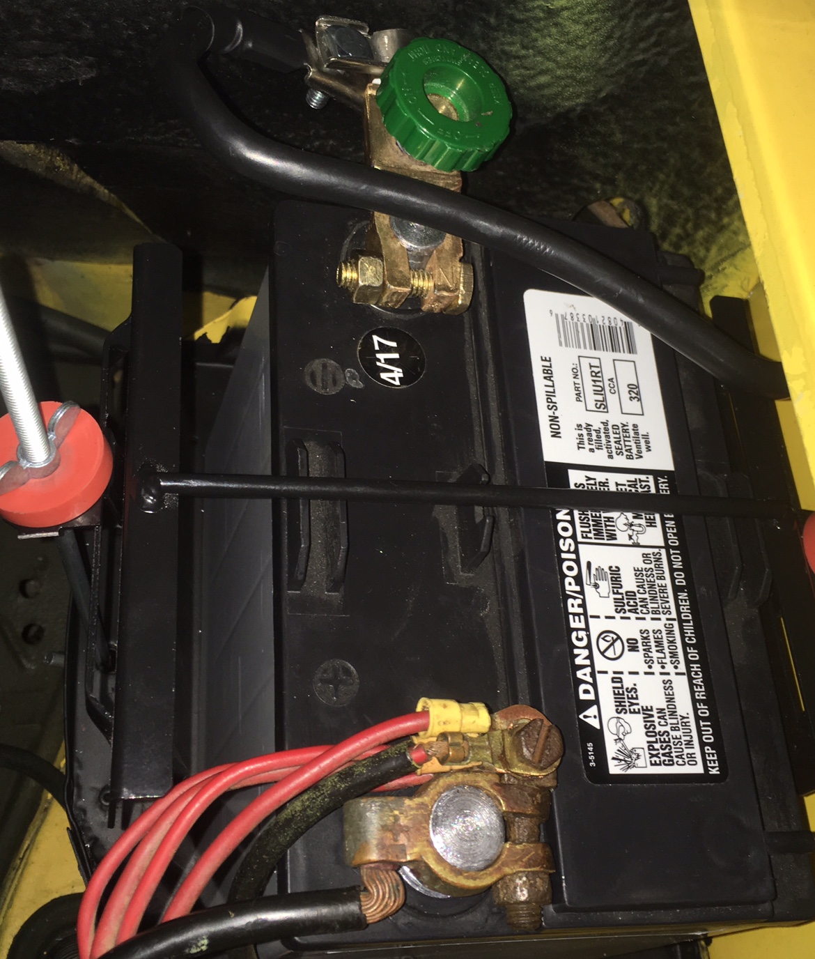

QUOTE(arne @ Oct 9 2017, 06:22 PM) *
I put a Miata U1R AGM in mine. Smaller, lighter, cheaper than most AGM. You do need to build your own hold down for it, but for the price it's hard to beat. I paid $112.50 at Batteries Plus.
Is there any chance you can post pics of the top view or let me know what you did/used to fasten the battery down? I bought the same battery today and got hold down bolts, but couldn't find a top portion that wasn't way too big at advance, autozone, etc.
ThreeV8s
post Nov 6 2017, 09:16 AM
Posts: 116
Joined: 11-March 17
From: West Chester, PA
Member No.: 20,915
QUOTE(ThreeV8s @ Nov 3 2017, 06:34 PM) *
Quick update in case anyone else needs guidance on this. I bought 2 hold-down bolts with the angle at the bottom that was closest to 90 degrees, a universal hold-down cross-bar, and a new cable for the negative post. I ended up buying the parts from 3 different stores based on what I thought would work best. Already had the negative cut-off valve from another car, which you can get at most auto parts stores. Might switch to a blade style if it will fit. I drilled a hole in the tray in line with the bracket hole just large enough that I could get the bolt through the bottom of the tray. The only thing left after this will be to wedge something between the battery and the cross-bar to remove any play. The other option is to order an adjustable crossbar to fit the narrow battery, but the reviews I have seen on them aren't great and top of this battery isn't very conducive to a flat hold-down.
