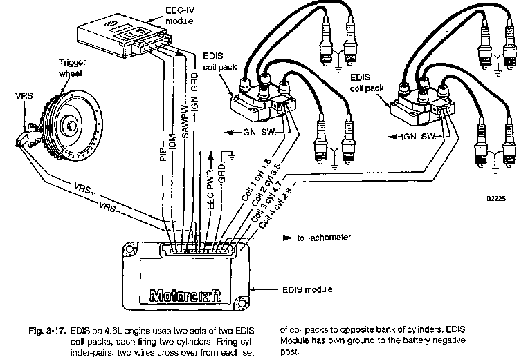

Megasquirt question...really EDIS related. Older MS2 V3.57
I screwed up and bought the wrong EDIS setup, I bought the -8 version instead of the -4 version.
I still think I can get it to work correctly as long as I mount the sensor 50° as per EDIS-8 requirements.
The stock V8 firing order is 1-3-7-2-6-5-4-8 (wasted spark pairs are 1-6, 3-5, 7-4 and 2-8)
As long as I connect to the correct coil I see no reason it wouldn't work.
Any possible damage if I didn't hook up the other 4 spark plug wires?
Will I damage a coil if it is only firing on one side and not as a pair?
Good time to convert the heads to dual plug? (IMG:style_emoticons/default/smile.gif)

Mueller   Megasquirt question...really EDIS related. Older M...   Nov 7 2017, 12:15 PM
76-914   That's definitely above my pay grade. :confus...   Nov 7 2017, 05:59 PM
McMark   I'm pretty sure you can just set up your MegaS...   Nov 7 2017, 10:24 PM
Mueller   I'm pretty sure you can just set up your Mega...   Nov 7 2017, 11:58 PM
JamesM   I'm pretty sure you can just set up your Meg...   Nov 8 2017, 12:54 AM
McMark   I'm pretty sure you can just set up your Meg...   Nov 8 2017, 10:49 AM
Mueller   Thanks Mark and James. So i do not need to upgrad...   Nov 8 2017, 11:49 AM
Dr Evil   I may have an EDIS4 if you want it.   Nov 9 2017, 12:27 PM
Mueller   I may have an EDIS4 if you want it. Thanks, I e...   Nov 9 2017, 12:58 PM
