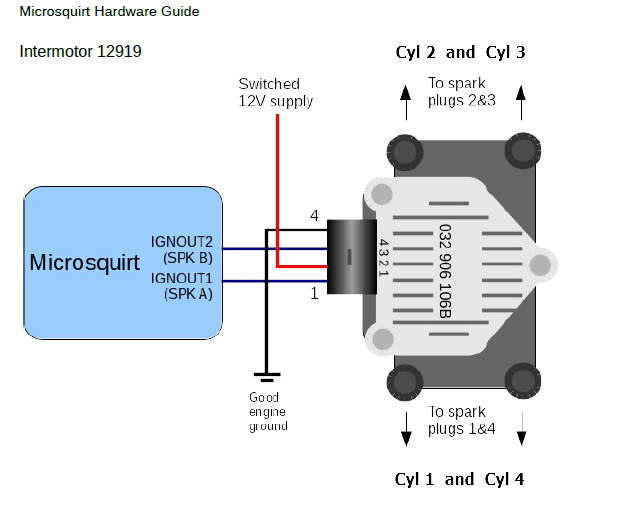

If you want the "easy button" for spark output look at VAG Part #032905106B wasted spark coil off late 90s/early 2000s VWs. Aftermarket/generic can be had for less than 20 bucks. Its logic level so no high current ignition drivers are needed, the wiring of it is crazy simple. Only thing you need to know is to swap the 3 and 4 plug wires from how they are labeled on the coil to account for the Type 4 firing order.
