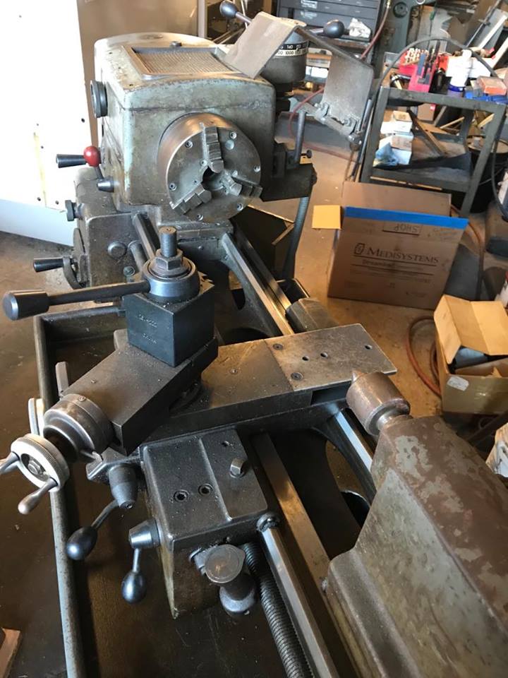

No real car progress to report. My crazy school schedule hasn't really been conducive to getting anything done outside of the lab. I've basically only finished the welding on the adapter in the last post.
Once my degree is finished I'll have much more restricted access to machinery, so I've been watching CL and other places for equipment for the garage. Some of you may have seen my mini horizontal mill thread in the Sandbox.

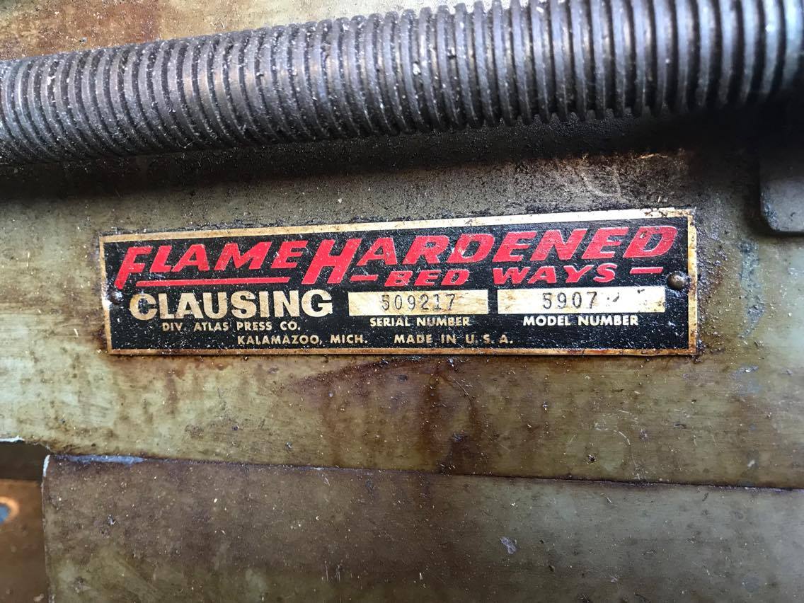

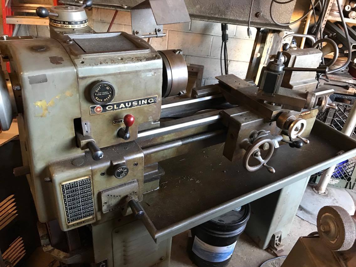

My newest score is the Clausing 5907 lathe. It's a 12" swing with hydraulic Reeve drive for continuously variable speed control from 52-2000 rpm (including back gear). It weighs ~1200# so it was a little tough getting off the truck. (IMG:style_emoticons/default/laugh.gif) Everything seems to work quite well and there is very little wear in the ways thanks to the hardening. The cross-slide doesn't have too much back lash and the Reeves drive works well. We'll see if the drive keeps working nicely, if not it'll get removed and replaced with fixed drive. The only real issue at this point is excessive lash in the carriage feed which I believe is caused by a worn bushing singe the rack gear and pinion look good. Looks pretty easy to fix after removing the apron and some people have added a second bearing in the rear part of the casting to kill this problem dead.
The owner needed space ASAP in his shop so I got lucky and basically stole it-asking price was less than the value of the new boring bar and insert tool holder. It came with a bunch of new [knockoff] Aloris tool holders, insert tools with spare inserts, and the original lamp post and tool holders. Next parts to find are a nice drill chuck and the MT4-1/2 to 5C adapter to run some collets for smaller jobs. And maybe an independent adjust 4 jaw chuck too. Tough part is finding economical L-00 parts so if anyone has anything... (IMG:style_emoticons/default/rolleyes.gif)
It's a 3-phase motor so the next step after doing some cleaning is either finding a 1PH-input/3-PH output VFD or building a converter. Small project and well worth it for the price. (IMG:style_emoticons/default/smile.gif)
