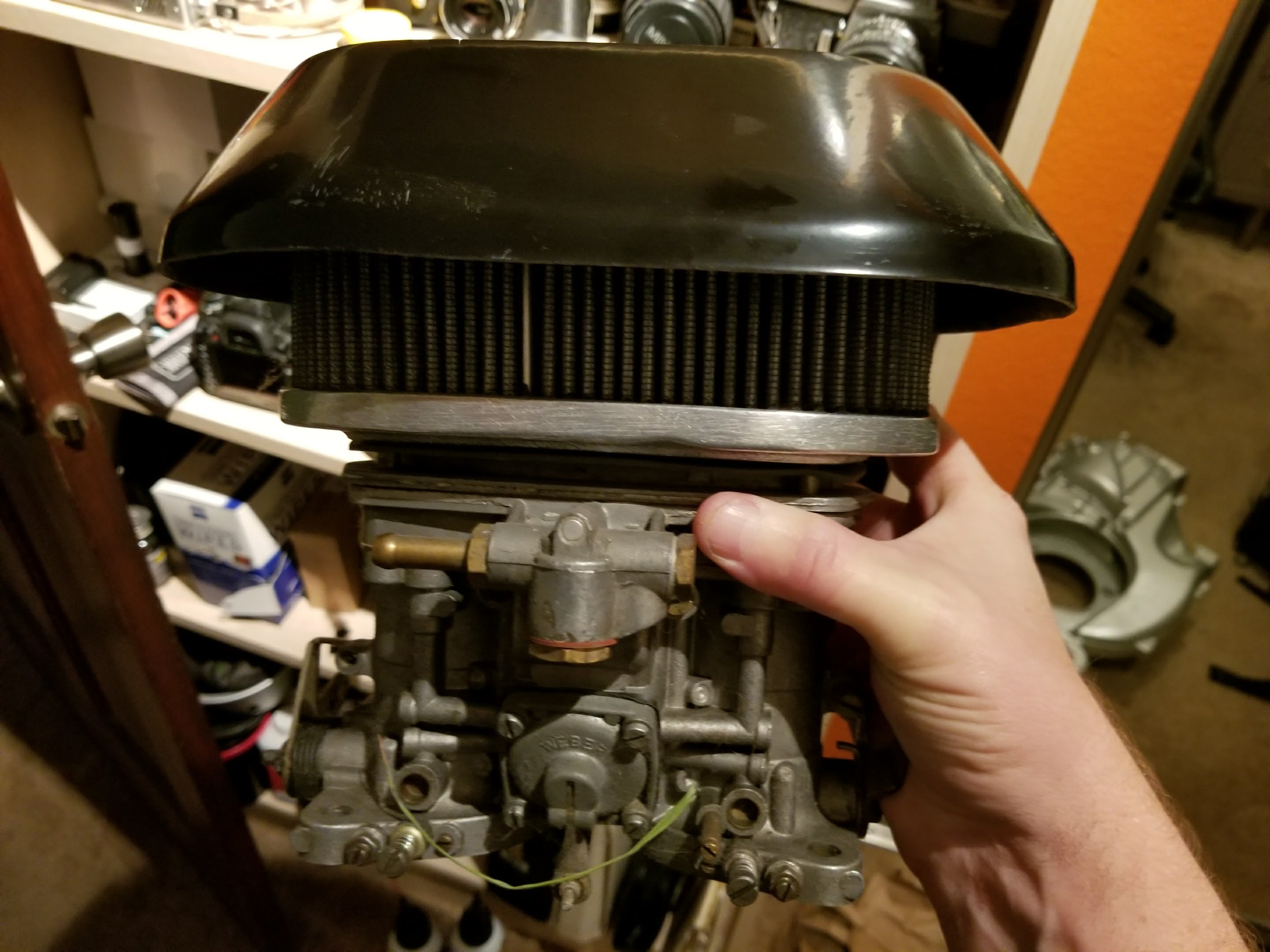

Fitted the rain hats on the carbs you rebuilt the other evening. Can't wait to hear some air moving through them soon!
