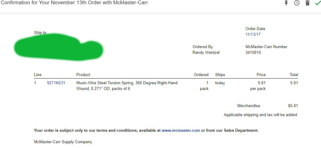

RoadGlue   Did we ever determine is this is the correct retur...   Nov 13 2017, 02:48 PM
McMark   Did we ever determine is this is the correct retu...   Nov 13 2017, 04:18 PM
RoadGlue   Both versions of that spring (129 881 100 & 1...   Nov 13 2017, 04:23 PM
McMark   I would try McMaster 9271K131 and see if that migh...   Nov 13 2017, 04:22 PM
RoadGlue   I would try McMaster 9271K131 and see if that mig...   Nov 13 2017, 04:24 PM
RoadGlue   Ordered the pack of springs from McMaster-Carr. I...   Nov 13 2017, 04:29 PM
McMark   How'd you get a pack of 5? :confused:   Nov 13 2017, 04:47 PM
RoadGlue   This wording is weird, eh? I had planned on keepin...   Nov 13 2017, 04:54 PM
McMark   Check your part number, yo. :(   Nov 13 2017, 05:07 PM
RoadGlue   Check your part number, yo. :( Oh sheesh. Thank...   Nov 13 2017, 05:48 PM
RoadGlue   I immediately wrote McMaster-Carr after seeing you...   Nov 13 2017, 06:15 PM
