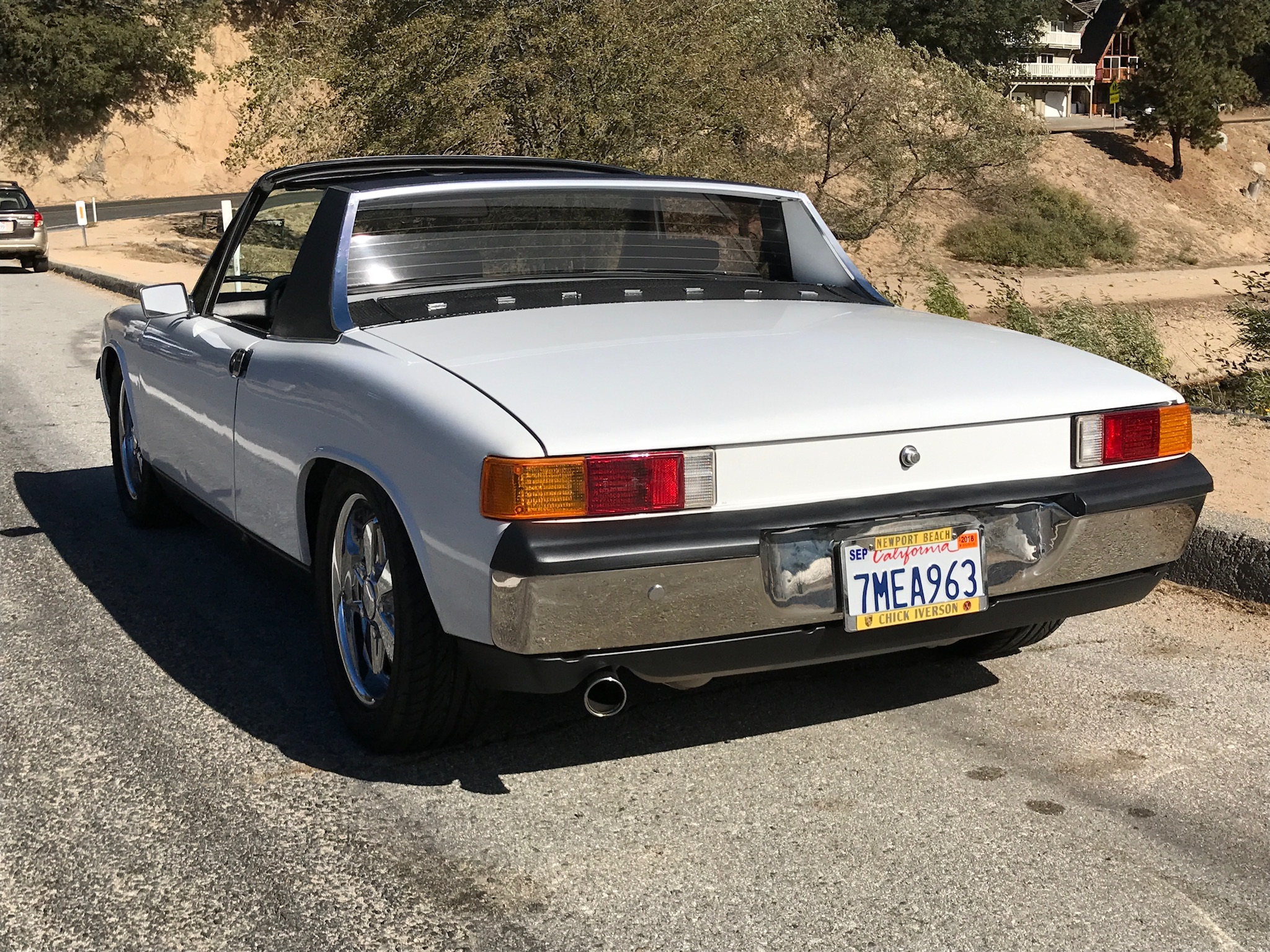

Here’s what it would look like and it’s super quit. I considered duels but wanted the sleeper look.
