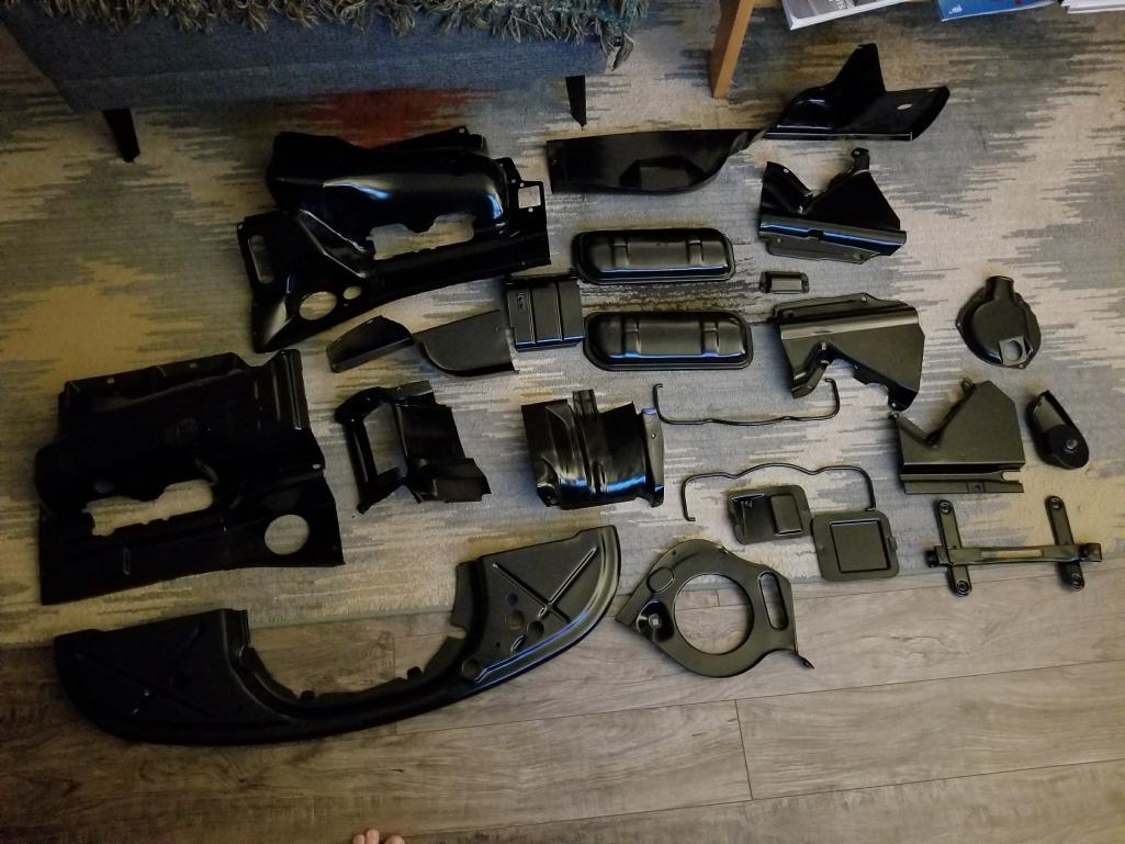

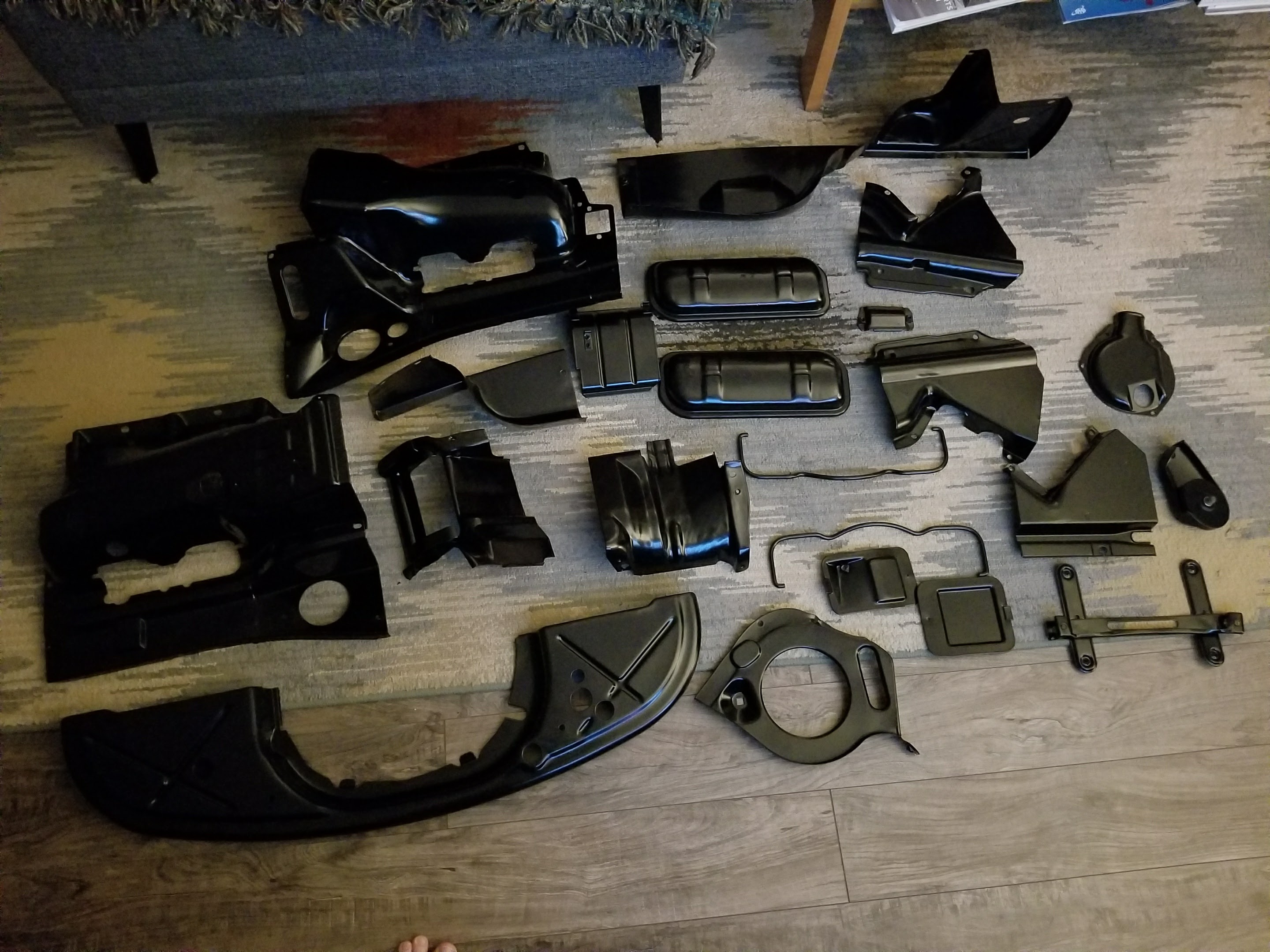

More progress. Should have the motor back in the car this Sunday.
I would have had some of the parts shown plated vs. powder coated if I had planned this project out better, but I'm happy how everything turned out.

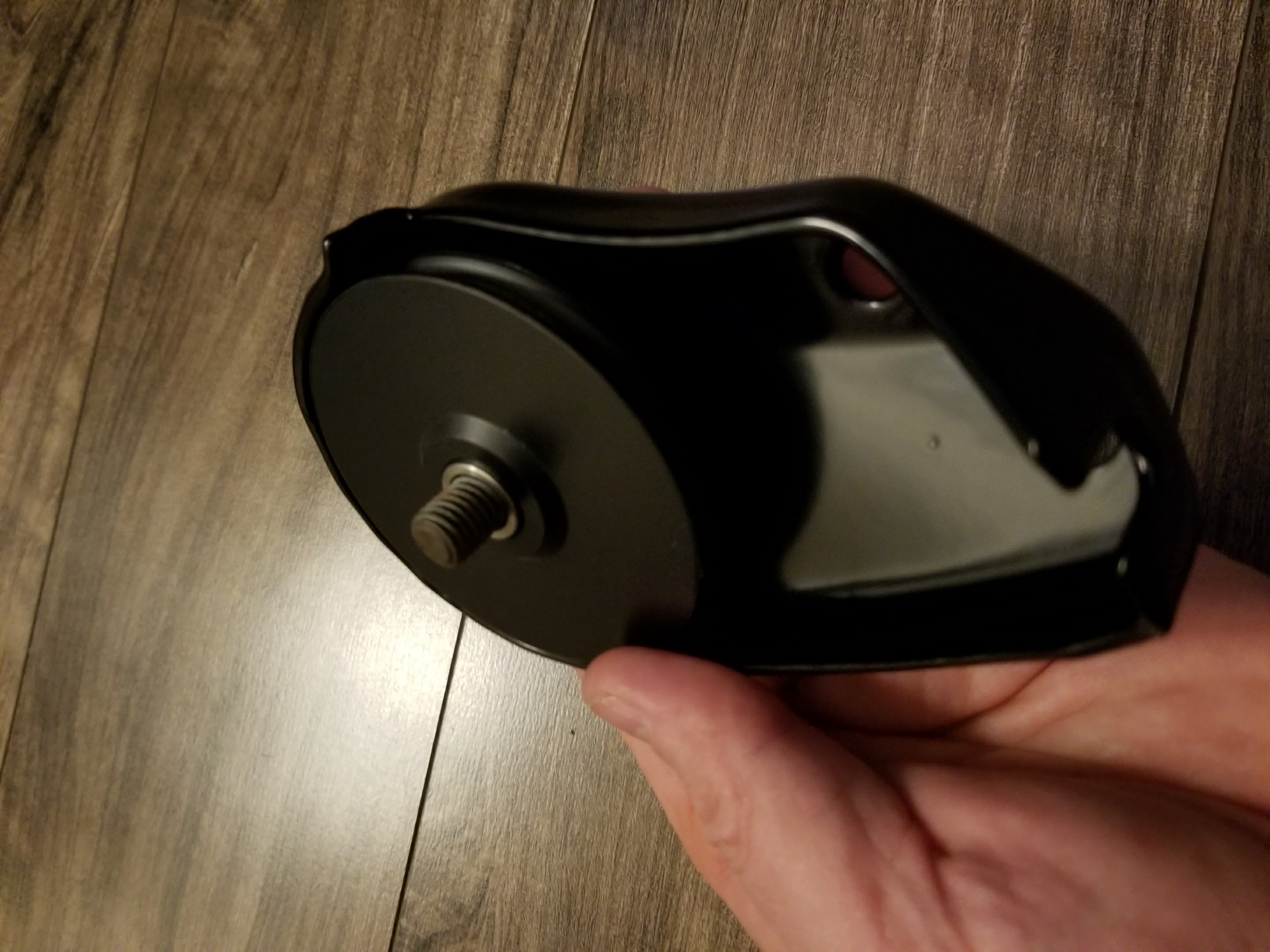

914rubber.com's pulley wheel (er, back focused):

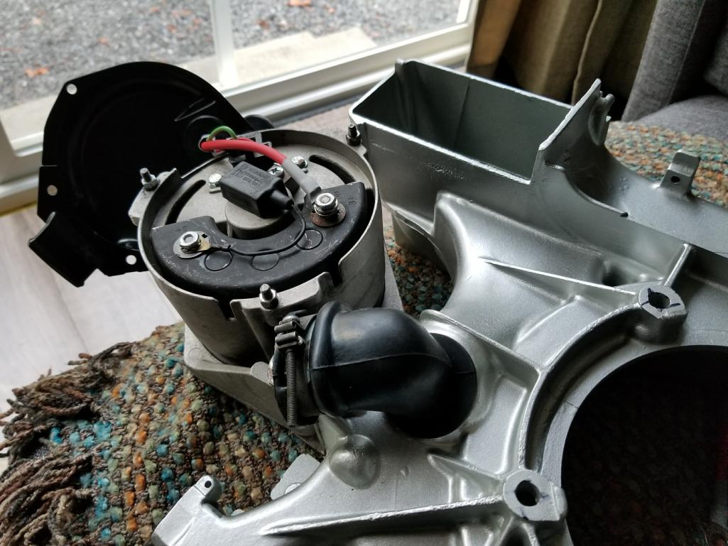

Wiring up the alternator with a new Bowlsby harness:

RoadGlue   More progress. Should have the motor back in the c...   Nov 14 2017, 11:17 AM
RoadGlue   IIRC, the factory put thin foam gaskets between th...   Nov 14 2017, 11:20 AM
Mueller   Those powder coated parts came out great. Maybe I...   Nov 14 2017, 11:44 AM
RoadGlue   Those powder coated parts came out great. Maybe ...   Nov 14 2017, 11:57 AM

RoadGlue   More progress tonight - ...   Nov 15 2017, 01:10 AM
RoadGlue   A few more -   Nov 15 2017, 01:12 AM
