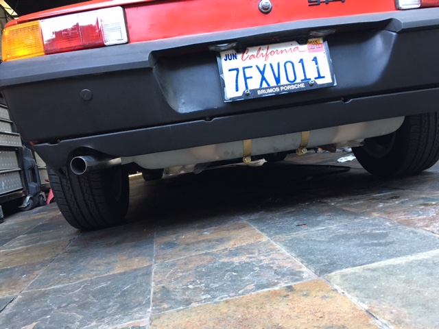

I'm looking at buying a 911 muffler (Dansk) for my six conversion but just curious if the outlet is in the same spot as a stock '73 rear valence. I want to be able to utilize my stock rear valence without modification. If not I might just buy one that has dual outlets like the GT style.
Also, is there any benefit to using a dual outlet versus a single outlet? Would the single outlet be restrictive? My engine is a 3.0, J&E pistons, webcam GE60 and PMO carbs.

For what it is worth, I am running a bone stock 2N1out 911 SC muffler on my 3.0 and it sounds great IMHO at all levels of acceleration. No drone. I had to edit the chrome tail pipe piece to fit precisely in the stock rear valance cut but otherwise, an easy fit and no ear plugs required.

Off subject a bit...Forrest did you ditch your 914 style muffler support for the 911 style straps and bracket ? ,thinking of doing that as I already have the stainless straps.
