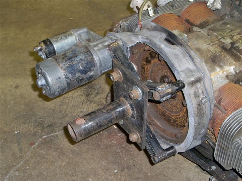

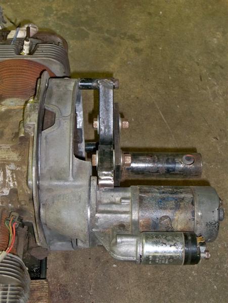

Mueller   Silly question, I need to buy or make an engine st...   Nov 15 2017, 01:28 PM

Mueller   Finally, some work related to my 914... Removed t...   Dec 25 2017, 02:14 PM
Mueller   Cleaned my engine, also deburred it a little bit a...   Dec 28 2017, 07:54 PM
Mueller   In case it is not in Raby's Type IV assembly D...   Jan 11 2018, 09:51 AM

Mueller   Not sure if this qualifies for being cheap or reso...   Jan 21 2018, 02:32 PM

Mueller   Dominic was nice enough to send me a straight engi...   Jan 27 2018, 11:03 PM
