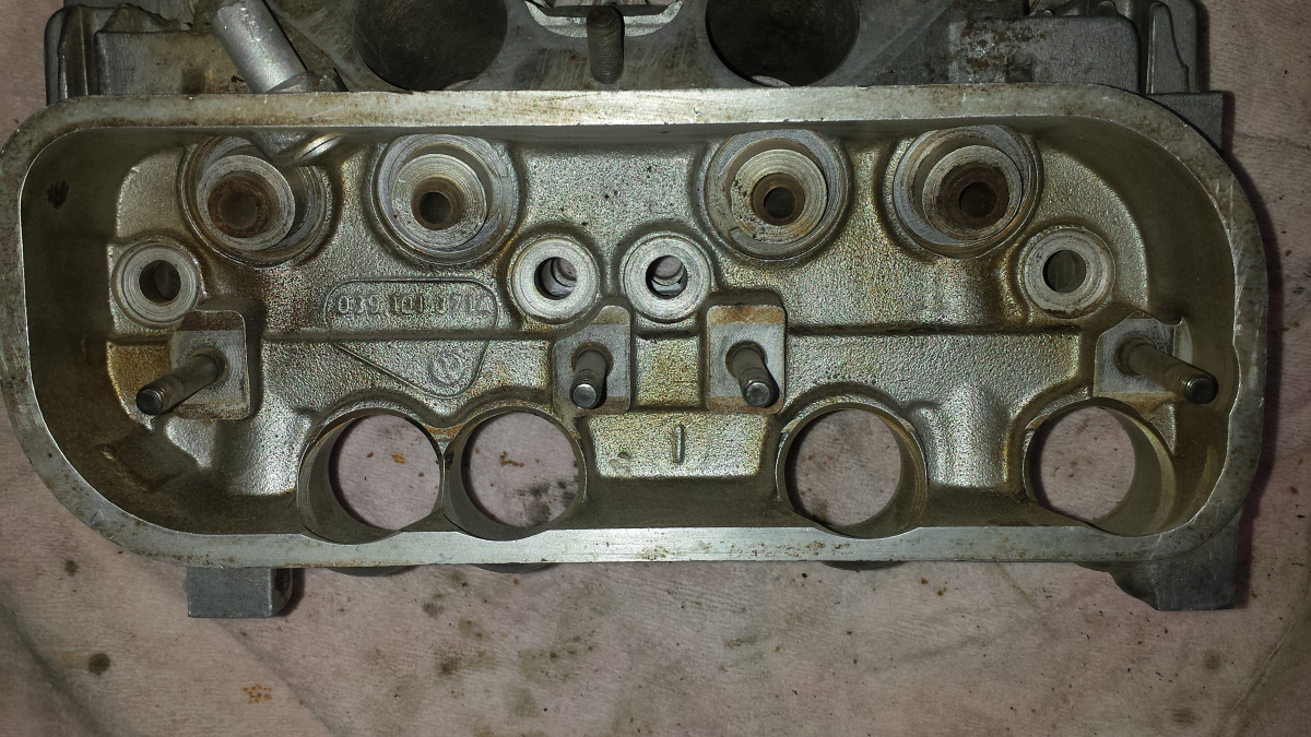

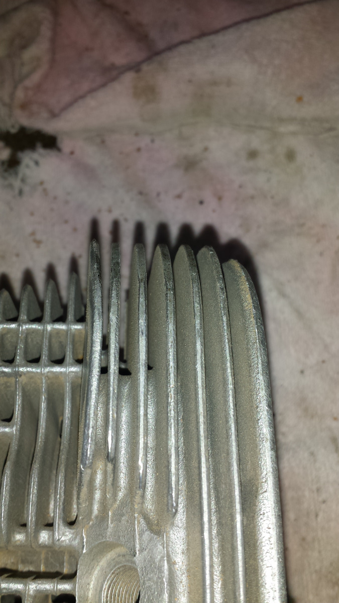

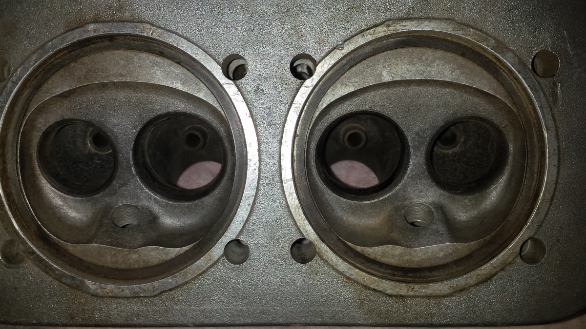

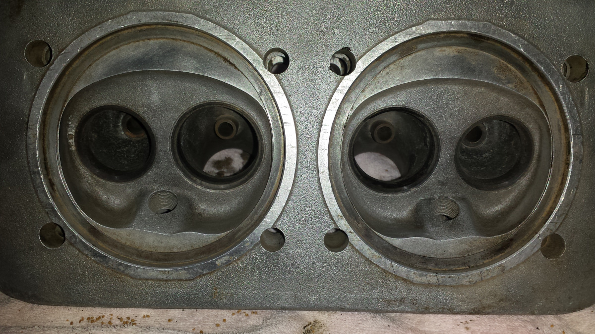

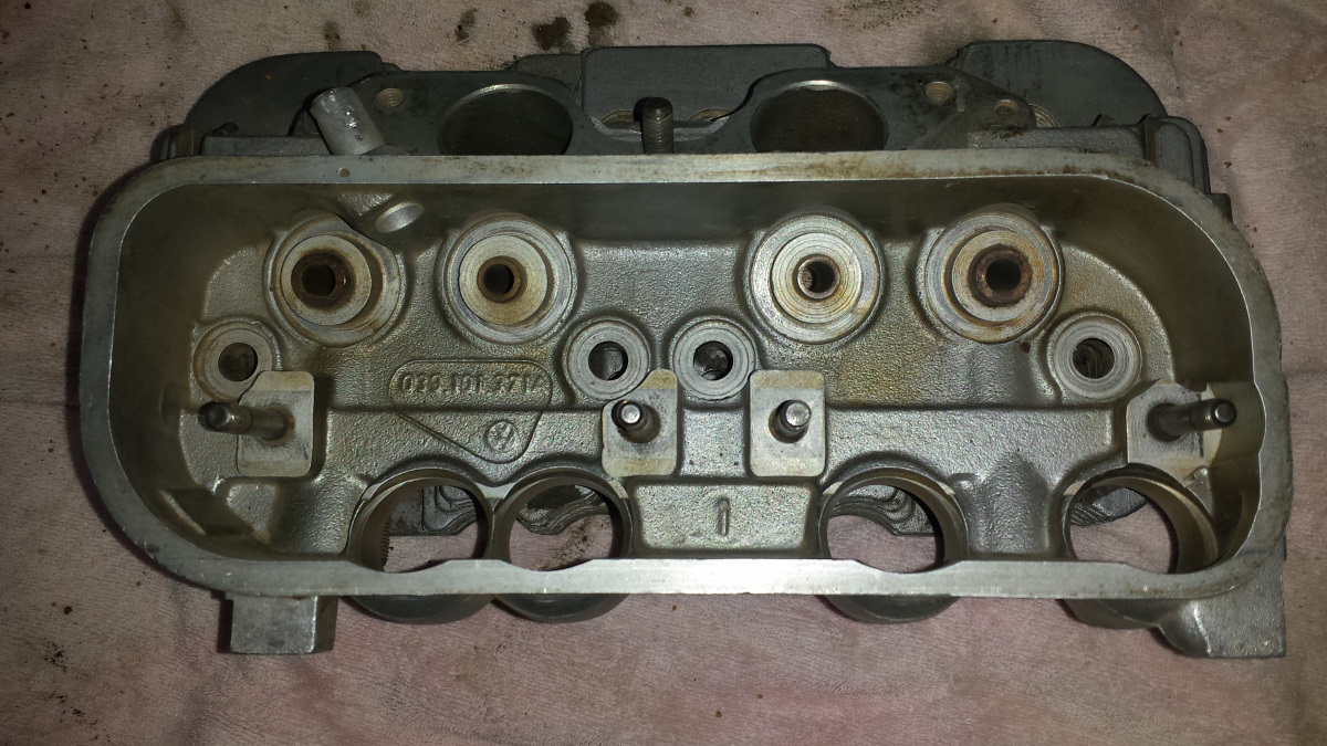

Finally got my heads walnut blasted. They still need a good soak and boil, or whatever they do to make these things look new again, but I think they look good. A total of 3 engine tin screws that need to be extracted, a broken exhaust stud on one head, and one bent fin on the other. But I'm not seeing any cracks and I didn't find any smoke genies when heating with a torch. I think they look pretty good. Wondering if you experts can see anything I'm missing.
Left Head:
Right:
Questions:
- Should that bent fin be straightened? My guess is no, but curious.
- New seats? I was planning to have them replaced, but was reading in Tom Wilson's book where he says that factory installed seats rarely drop. I'm guessing as long as the builder knows what they are doing; heats the heads and chills the seats before pressing, it would be the same. But wonder what the experts think. Again, best estimate is these heads have between 100K and 130K miles on them. Probably at the lower end of that estimate.
- What is the best way to remove head and exhaust gaskets without damaging the sealing surfaces? All of them are stuck on pretty tight and I was worried about messing something up gettig them off.

McMark   Dental type picks are a good way to get the gasket...   Nov 28 2017, 12:15 PM
bbrock   Dental type picks are a good way to get the gaske...   Nov 28 2017, 12:51 PM
Vacca Rabite   I see something that looks like a crack in the spa...   Nov 28 2017, 01:07 PM
bbrock   I see something that looks like a crack in the sp...   Nov 28 2017, 06:18 PM
McMark   You should replace them all. The sodium valve can...   Nov 28 2017, 01:34 PM
bbrock   You should replace them all. The sodium valve ca...   Nov 28 2017, 05:56 PM
nditiz1   Mark is correct my valve snapped in half.   Nov 28 2017, 02:13 PM
Mark Henry   I've never had to use dye to see cracks on a T...   Nov 28 2017, 06:38 PM
