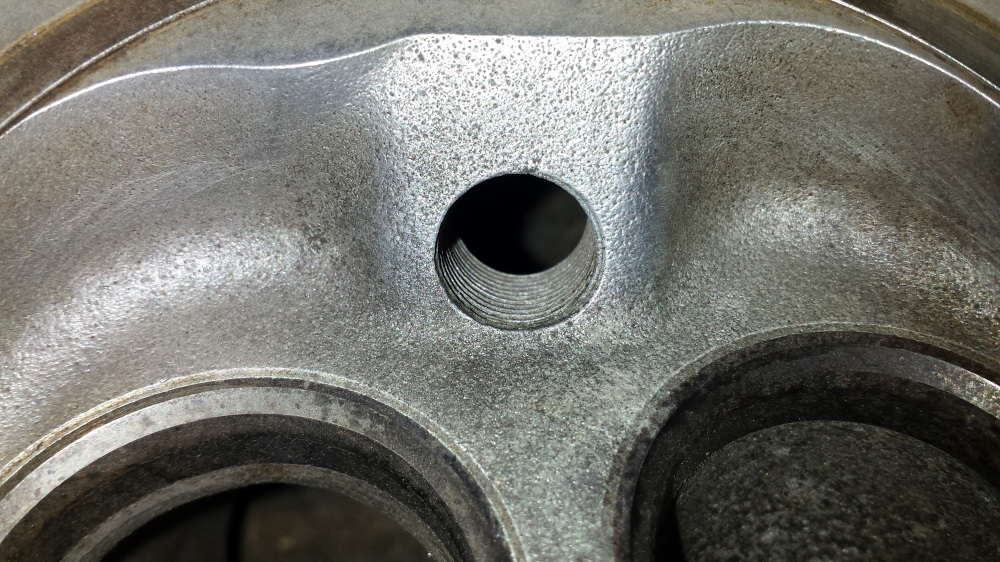

I see something that looks like a crack in the spark plug hole (which is a super common crack site). Use some machinists die and that will tell you quick if there is a crack there or not. Post 14, Second picture, left hand cylinder, 3 o'clock on the spark plug hole. Could be a casting flaw, but it looks like a crack.

I see it. Good eye! Luckily, I'm pretty sure that's a combination of lighting and some flecks of carbon still in the casting pores. I'll pick up some machinist's dye to be certain. But here is a close-up of that hole. I think the crack is that little band of smudge now at 9 o'clock in this pic.
