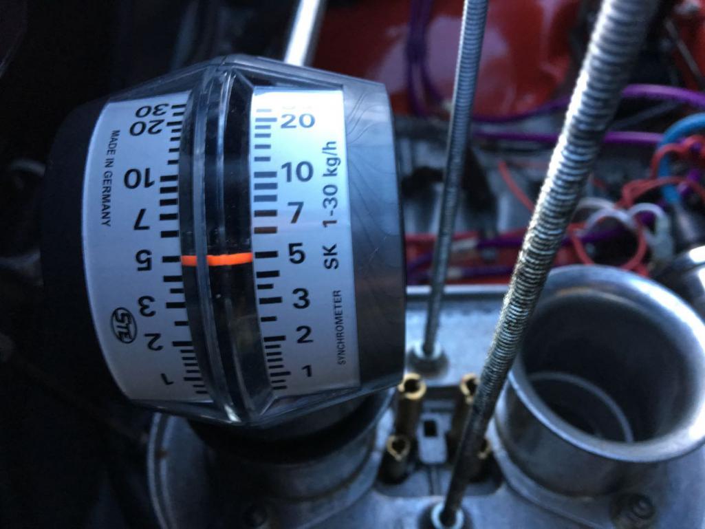

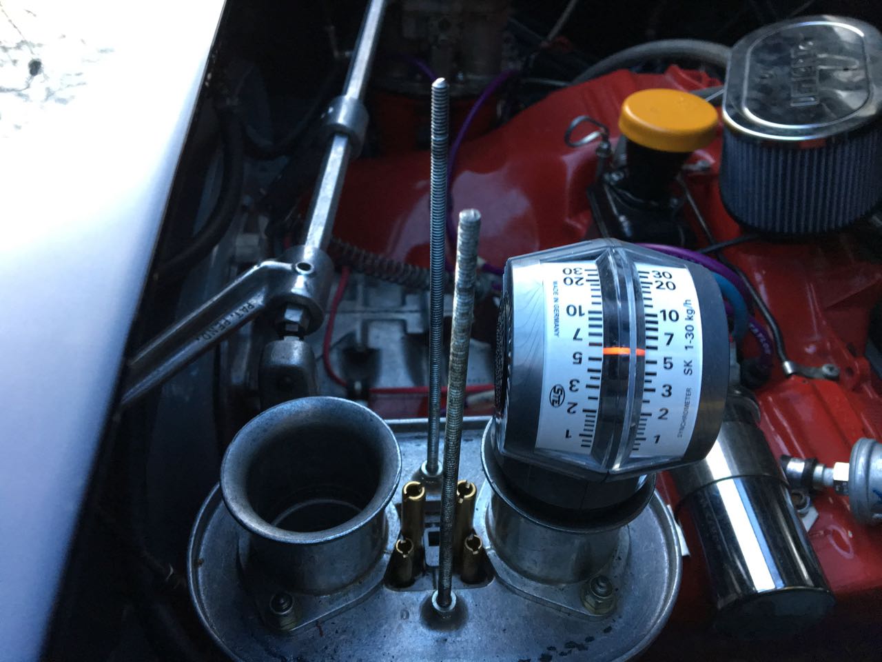

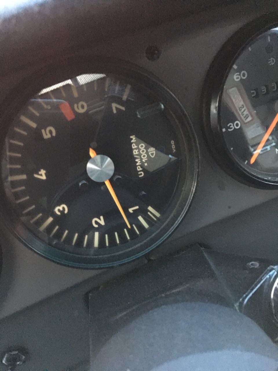

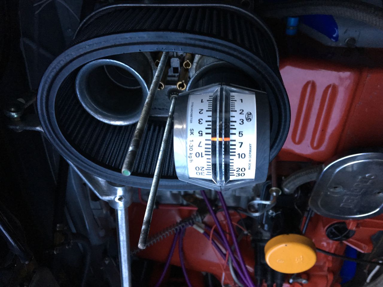

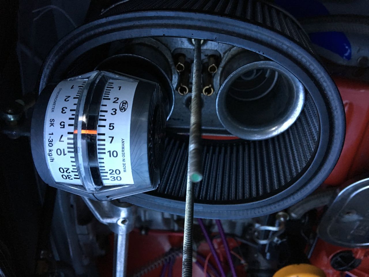

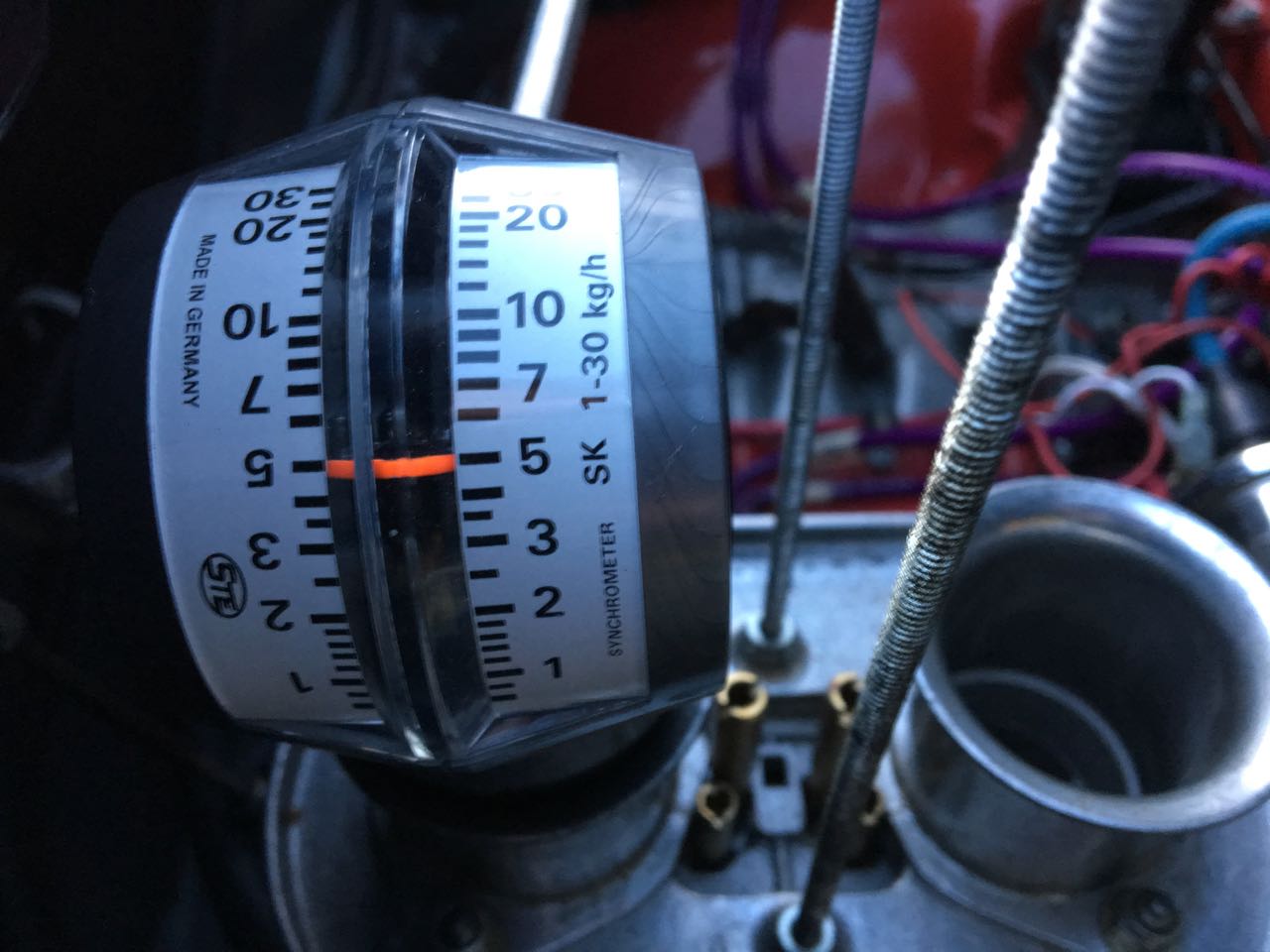

As y'all advised, I bought an air-flow meter. I was able to measure what was happening at idle. At the time the engine was warm and idling fast, around 1200 RPM. It often idles lower than that.
With only one meter, I didn't see a way to compare the behavior at speeds other than idle. Is there some trick to this that I don't know? If not I guess I'll buy another meter(s) to watch more than one throat at a time while revving the engine. Sometimes when I'm driving, I'm wondering whether it's running right at slight throttle, just off of idle.
At idle I noticed slightly less flow from cylinder #3. It reads 5 while the others read almost 6. Is this a significant difference?
Cylinder #4 below:
Cylinder #3 below:
Idling fast at the moment:
Cylinder #2 below:
Cylinder #1 below:

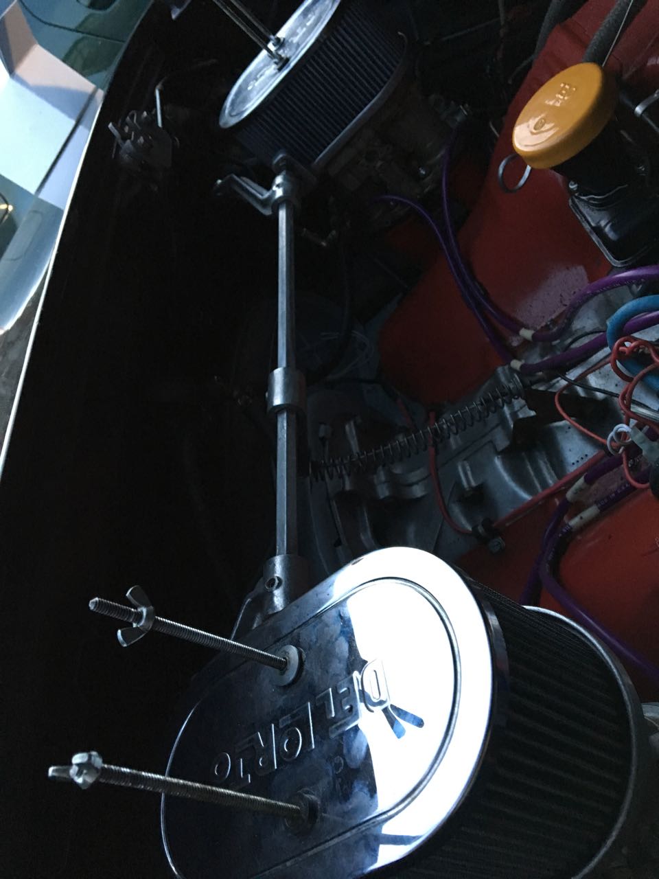

I also got more legitimate looking air filters from CB Performance to replace the foam things the previous owner had for some reason. But I still have the long studs, so removing the air filters is more of a hassle than it should be. I don't know if it's easy to find shorter studs. I'm tempted to buy taller filters just to reduce the hassle.
