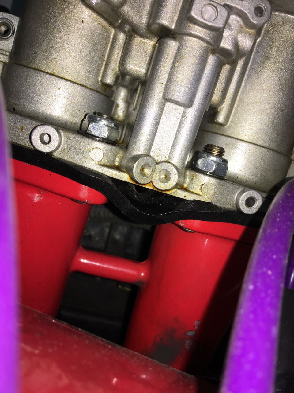

I hope another newbie question is appropriate. I noticed this intake manifold gasket is deformed. Is this caused by overtorquing? Will it leak?
I have not removed the carbs yet -- still afraid of messing something up.

rhodyguy   I've never seen one like that. Neoprene? If yo...   Dec 17 2017, 01:42 PM
porschetub   Holy cr#p never seen base caskets like that,WAY to...   Dec 17 2017, 02:38 PM
rhodyguy   One thing at a time. Any VW/bug shop in the Seat...   Dec 17 2017, 03:38 PM
Mark Henry   IIRC those are CB performance gaskets, I think the...   Dec 17 2017, 03:55 PM
MarkV   My carbs had some thick gaskets somewhat similar t...   Dec 17 2017, 03:58 PM
Mark Henry   Just googled I was thinking dellorto "Jet Doc...   Dec 17 2017, 04:06 PM
98101   Just googled I was thinking dellorto "Jet Do...   Dec 17 2017, 05:01 PM
Mark Henry   Link to the dell parts http://vwparts.aircooled.n...   Dec 17 2017, 04:10 PM
MarkV   Nice that they are still available although mine d...   Dec 17 2017, 04:37 PM
Mark Henry   Problem is with what? If it ever did fail you...   Dec 17 2017, 04:58 PM
MarkV   Nyloc nuts are probably not what I would use but n...   Dec 17 2017, 05:36 PM
type2man   Looks like you have the dellorto upgrade kit becau...   Dec 17 2017, 07:00 PM
rhodyguy   I don't get how it could bow down that much.   Dec 17 2017, 07:07 PM
