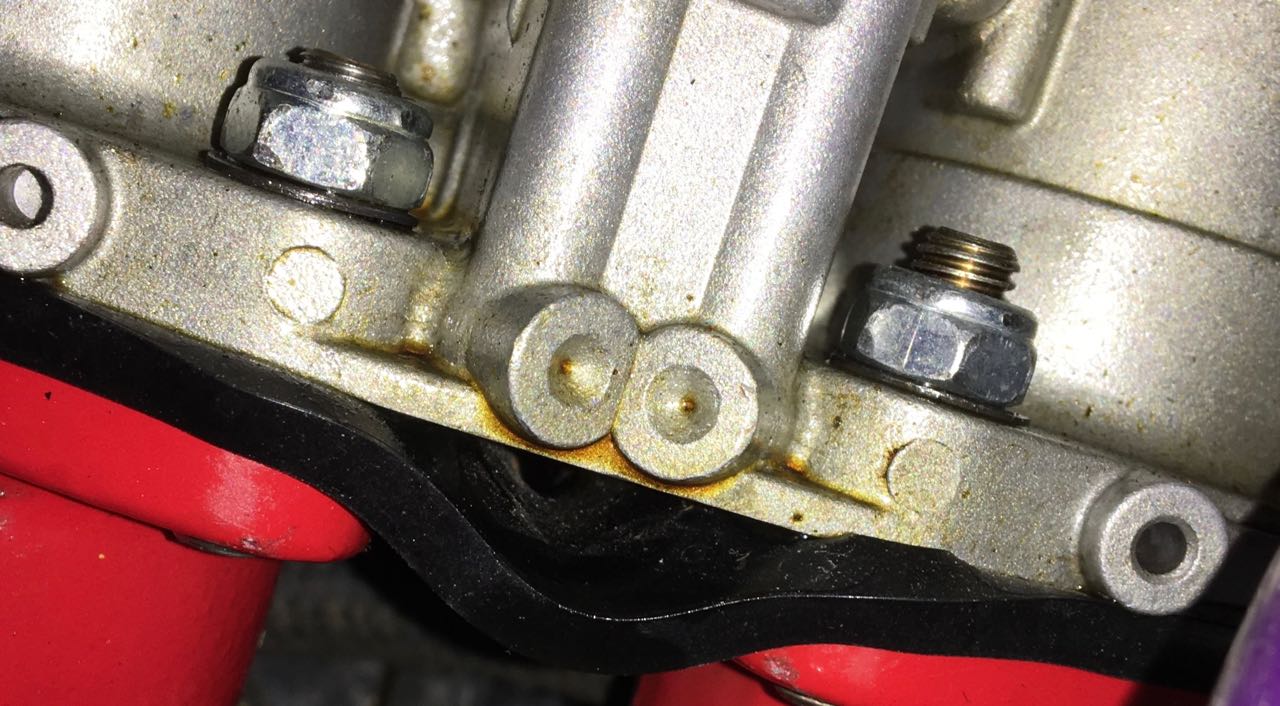

98101   I hope another newbie question is appropriate. I ...   Dec 16 2017, 05:04 PM
rhodyguy   I've never seen one like that. Neoprene? If yo...   Dec 17 2017, 01:42 PM
porschetub   Holy cr#p never seen base caskets like that,WAY to...   Dec 17 2017, 02:38 PM
rhodyguy   One thing at a time. Any VW/bug shop in the Seat...   Dec 17 2017, 03:38 PM
Mark Henry   IIRC those are CB performance gaskets, I think the...   Dec 17 2017, 03:55 PM
MarkV   My carbs had some thick gaskets somewhat similar t...   Dec 17 2017, 03:58 PM
Mark Henry   Just googled I was thinking dellorto "Jet Doc...   Dec 17 2017, 04:06 PM

type2man   Looks like you have the dellorto upgrade kit becau...   Dec 17 2017, 07:00 PM
rhodyguy   I don't get how it could bow down that much.   Dec 17 2017, 07:07 PM
98101   So the gaskets weren't leaking (at least at id...   Dec 23 2017, 03:54 PM

Perry Kiehl   From what I can see in post #43 the thick intake g...   Dec 26 2017, 10:28 AM
