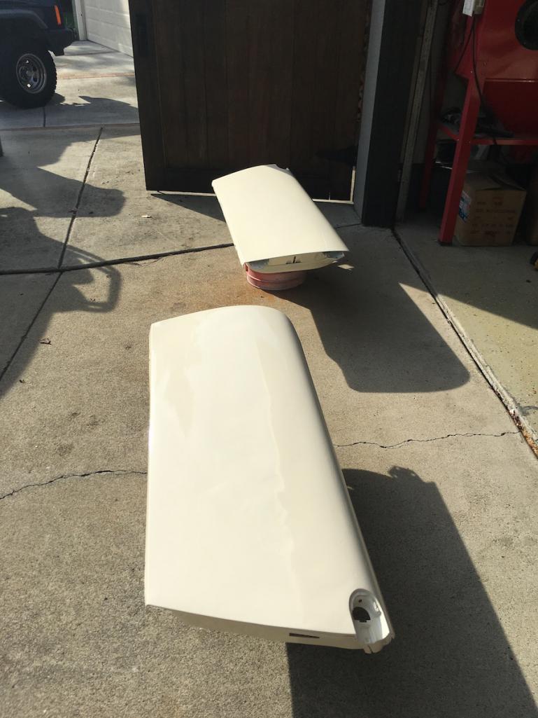

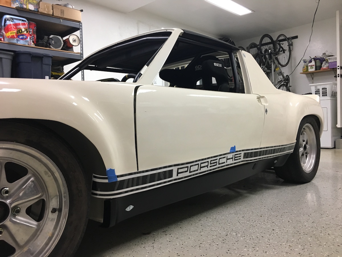

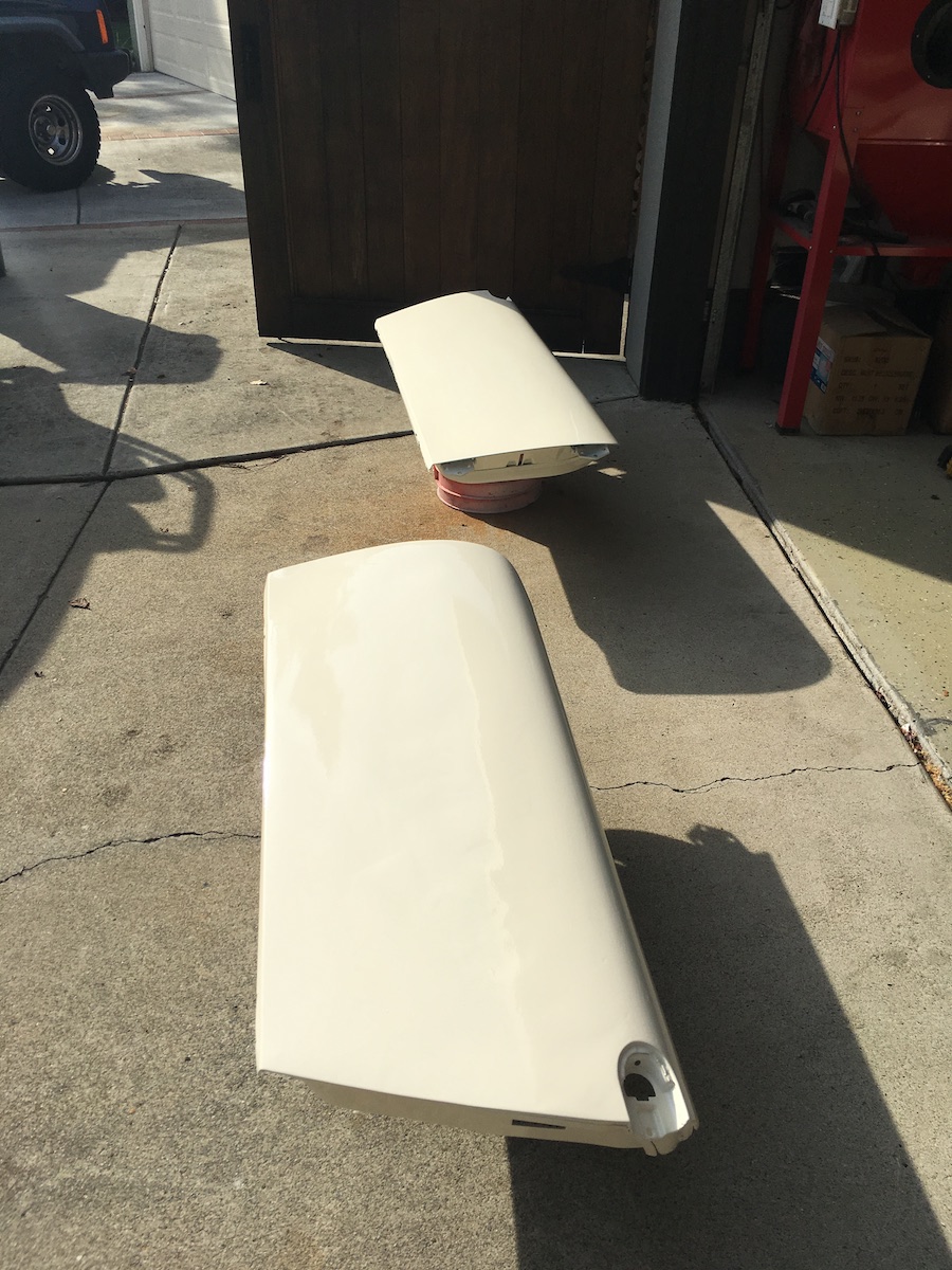

Painting the doors took forever, but I finally got around to finishing them. They had a bunch of damage which I filled and sanded about 6 times. Then I had to figure out my gun (again), prime, and paint. Bodywork, man...
Then when the doors were finally mounted up, I added some porsche scripts and some meatballs on the doors and hood.

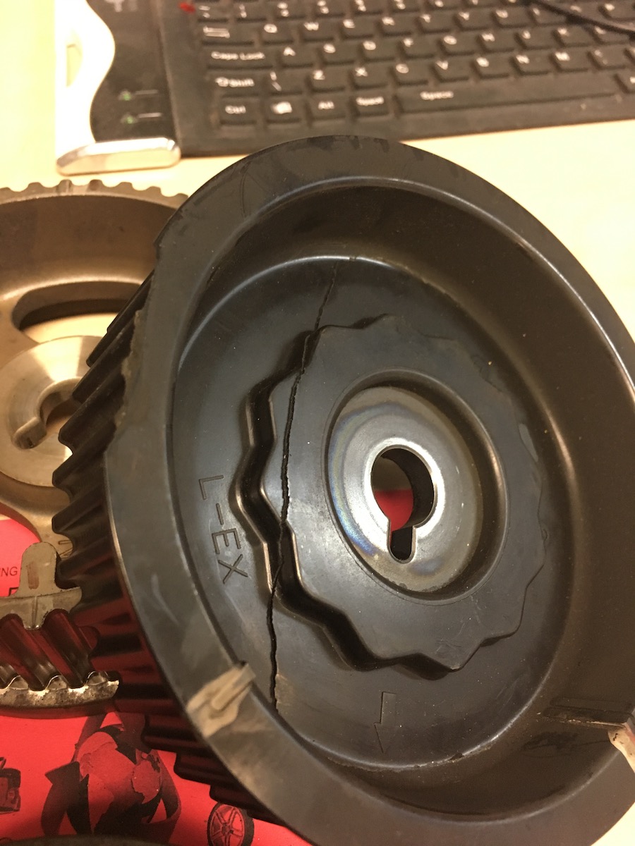

And heres the cam gear which could have ended the life of the engine had I not found it:
