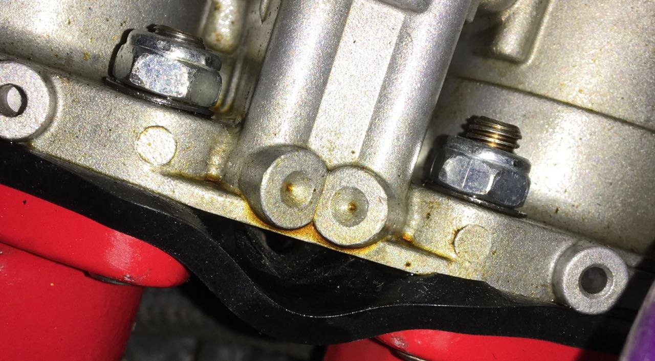

My car came with these thick base gaskets that (according to this website) should be at 10-15 inch-lbs. http://vwparts.aircooled.net/Dellorto-DRLA...stle-gasket.htm
So I'm confused, and the previous owner also seems to have been confused. Here's how it looks as I got it from him:
Assuming the website is correct, any particular torque wrench you'd recommend for readjustment?

I calibrate my torque wrench myself at home using a vice and a scale. Very easy if you know a bit of physics.
BUT, the nuts in the picture are nylock and no torque wrench will torque them correctly. That is not a correct application for those nuts.

MarkV   Those gaskets are probably deformed from heat or a...   Dec 18 2017, 09:06 PM

98101   I reached the previous owner (Tim), who told me he...   Dec 19 2017, 07:25 PM

98101   UPDATE: I tried spraying water around the deformed...   Dec 20 2017, 10:12 PM
MarkV   In your first photo it looks to me like because of...   Dec 20 2017, 10:52 PM
98101   Seems like previous owner left you with some east...   Dec 20 2017, 11:45 PM
thelogo   :agree: on a big monster motor like that Every th...   Dec 20 2017, 11:25 PM
MarkV   Previous owner mistakes are commonly highlighted a...   Dec 20 2017, 11:57 PM
98101   No disrespect intended to previous owners.   Dec 21 2017, 02:27 AM
