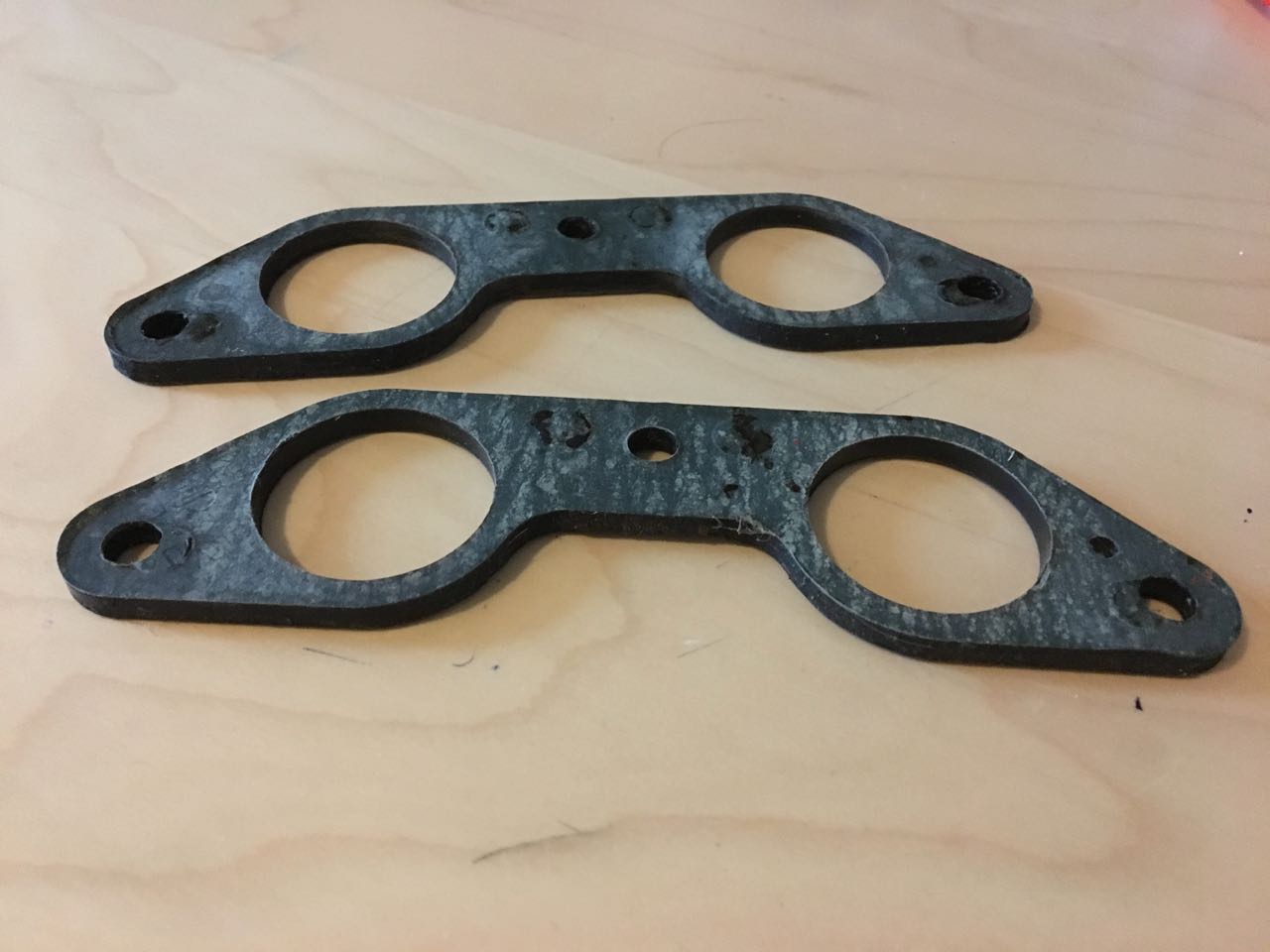

QUOTE(Vacca Rabite @ Dec 19 2017, 06:58 AM) *
Don't reuse the neoprene gaskets. Use the phenolic (black plastic) spacers with paper gaskets attached.
I found these parts amongst the spare parts the previous owner provided. Are they phenolic spacers? Also interesting: the holes on these don't match up to the carbs or manifold, and there are marks where it appears some previous owner tried to install them.

MarkV   The phenolic spacers for the manifold to head is c...   Dec 19 2017, 10:49 AM
Tbrown4x4   Those are manifold to 2.0L head gaskets. Insulates...   Dec 19 2017, 11:14 AM
MarkV   [quote name='Vacca Rabite' post='2559122' date='D...   Dec 19 2017, 11:15 AM
Vacca Rabite   The phenolic spacers with the paper gaskets attach...   Dec 19 2017, 11:32 AM
