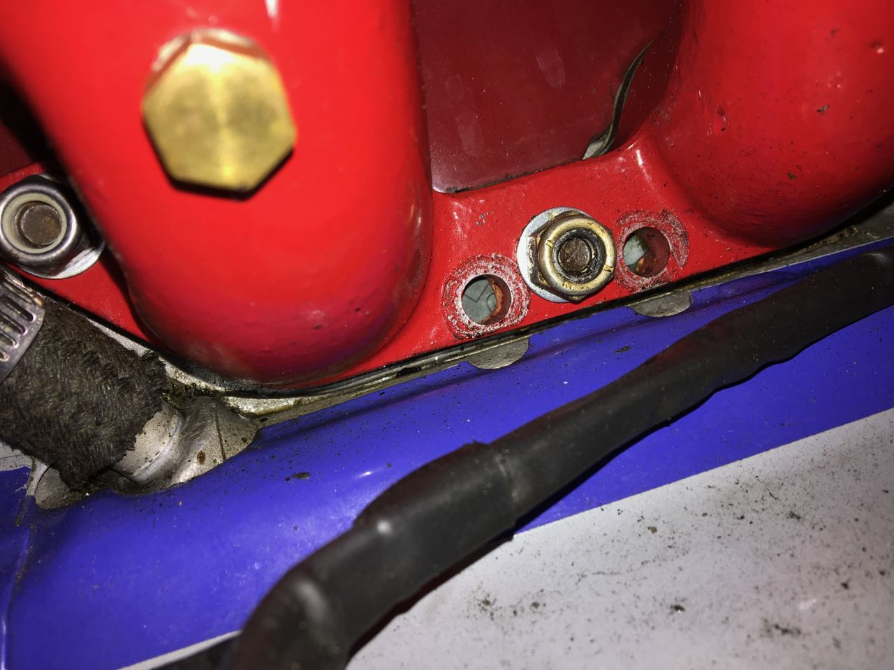

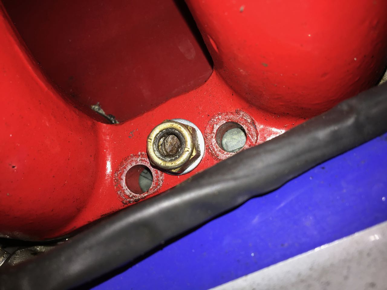

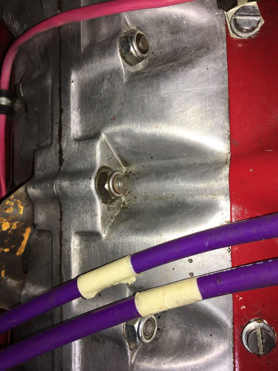

98101   UPDATE: I tried spraying water around the deformed...   Dec 20 2017, 10:12 PM
MarkV   In your first photo it looks to me like because of...   Dec 20 2017, 10:52 PM
98101   Seems like previous owner left you with some east...   Dec 20 2017, 11:45 PM
thelogo   :agree: on a big monster motor like that Every th...   Dec 20 2017, 11:25 PM
MarkV   Previous owner mistakes are commonly highlighted a...   Dec 20 2017, 11:57 PM
