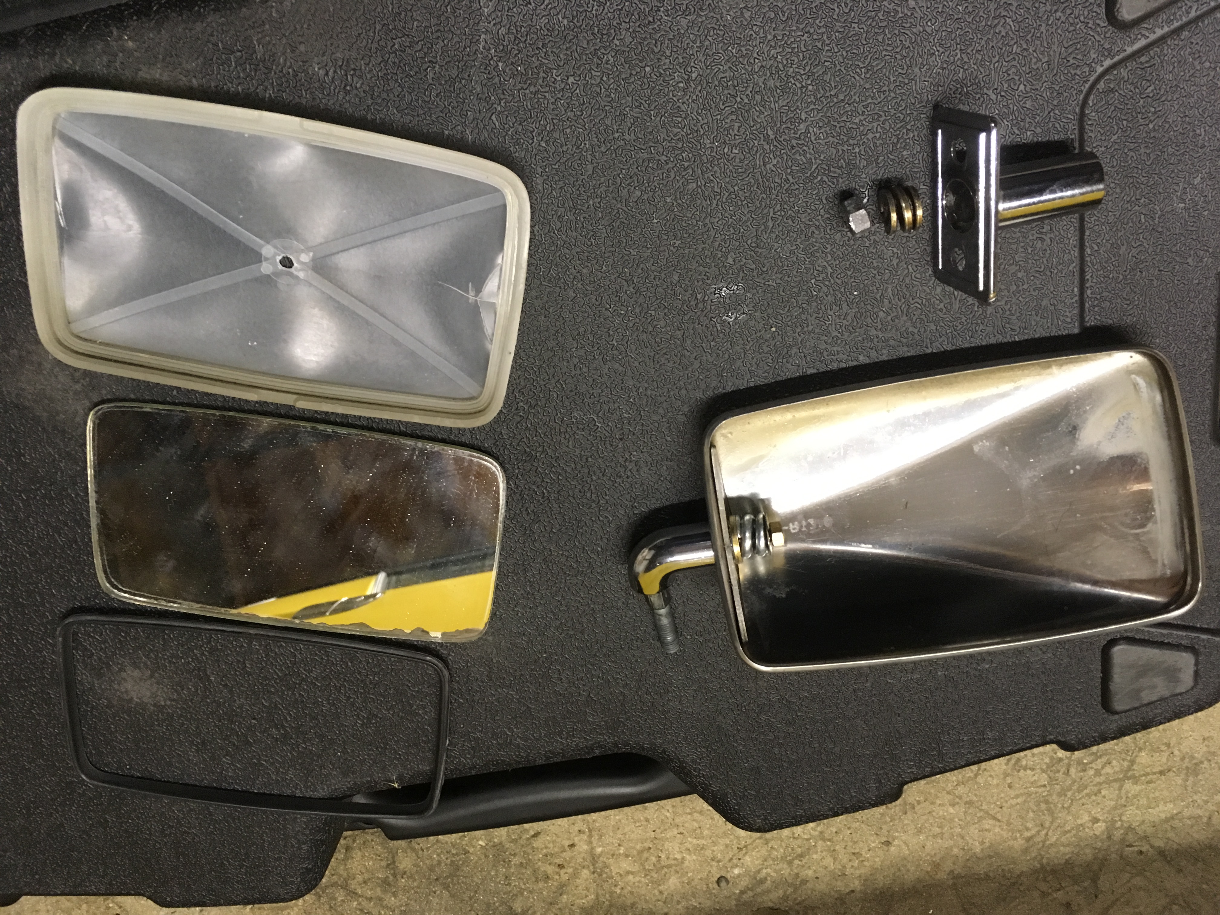

Thanks again to @mepstein for the advice. I figured I’d provide some tips here for the knuckle-draggers like me who find things like this to be challenging.
To loosen the base nut of one of these, you will need a very narrow 10 mm socket to access and loosen the nut. Mine did not fit. I had luck borrowing from a friend who has a light duty ratchet set.
To get the retaining ring off, I manipulated the ring with one hand and slid an old health insurance card between the glass and the ring (a credit card would not fit). Once I got that in there, I was able to get the ring off with some patience.
From there, I got the mirror away from the plastic seat and then got the seat out. After spraying penetrating oil, I was able to get the arm moving freely.
Since I now have the glass out, I cannot justify putting the old glass back in, so I ordered 2 from 914rubber as the other side is in similar condition. Pretty sure I told the mrs. recently that I was done buying stuff for this car for a while. (IMG:style_emoticons/default/bs.gif) Anyway, this is one of my winter projects planned for my car and hope my tips help others. The pic below shows it broken down.
