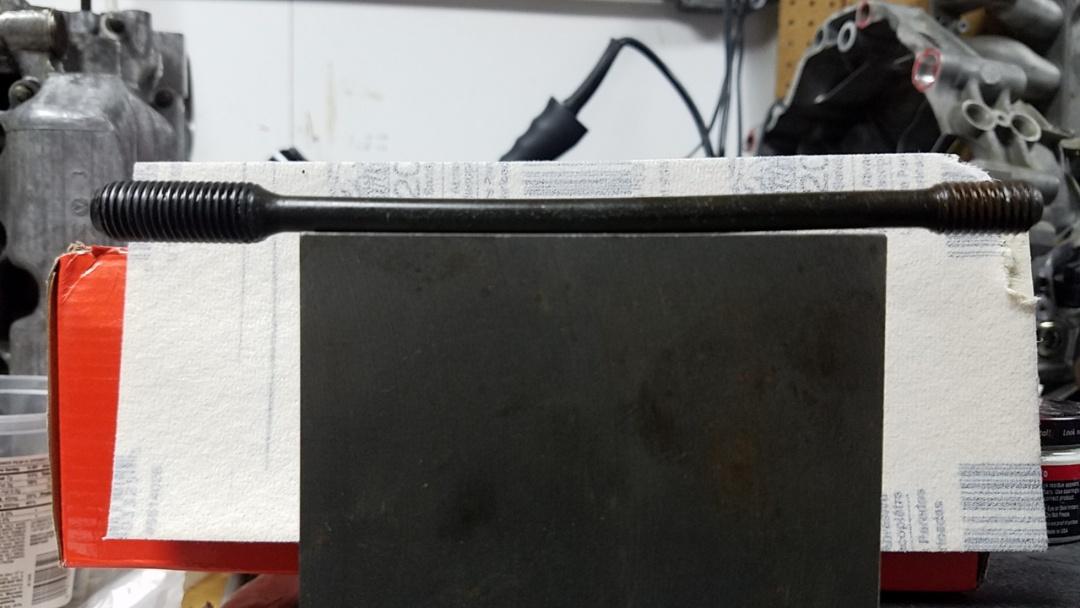

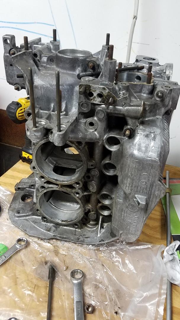

Removed the main cylinder studs this morning.
Noticed one of the smaller studs is bent pretty good. Will have to source another one.
I plan to clean the engine case one more time, might be a little easier with the studs removed. The other side has a lot more oil caked onto it for some reason.
